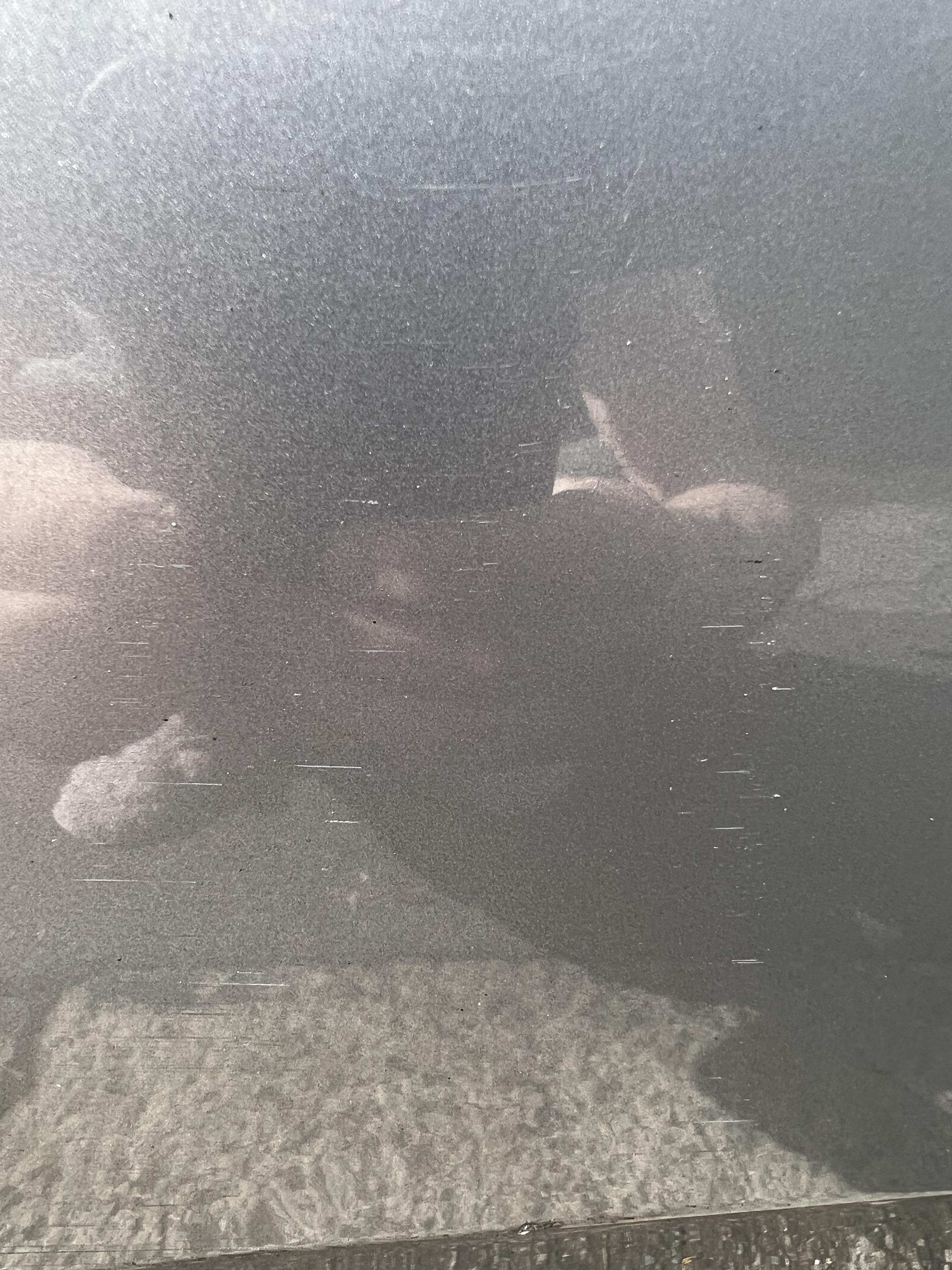

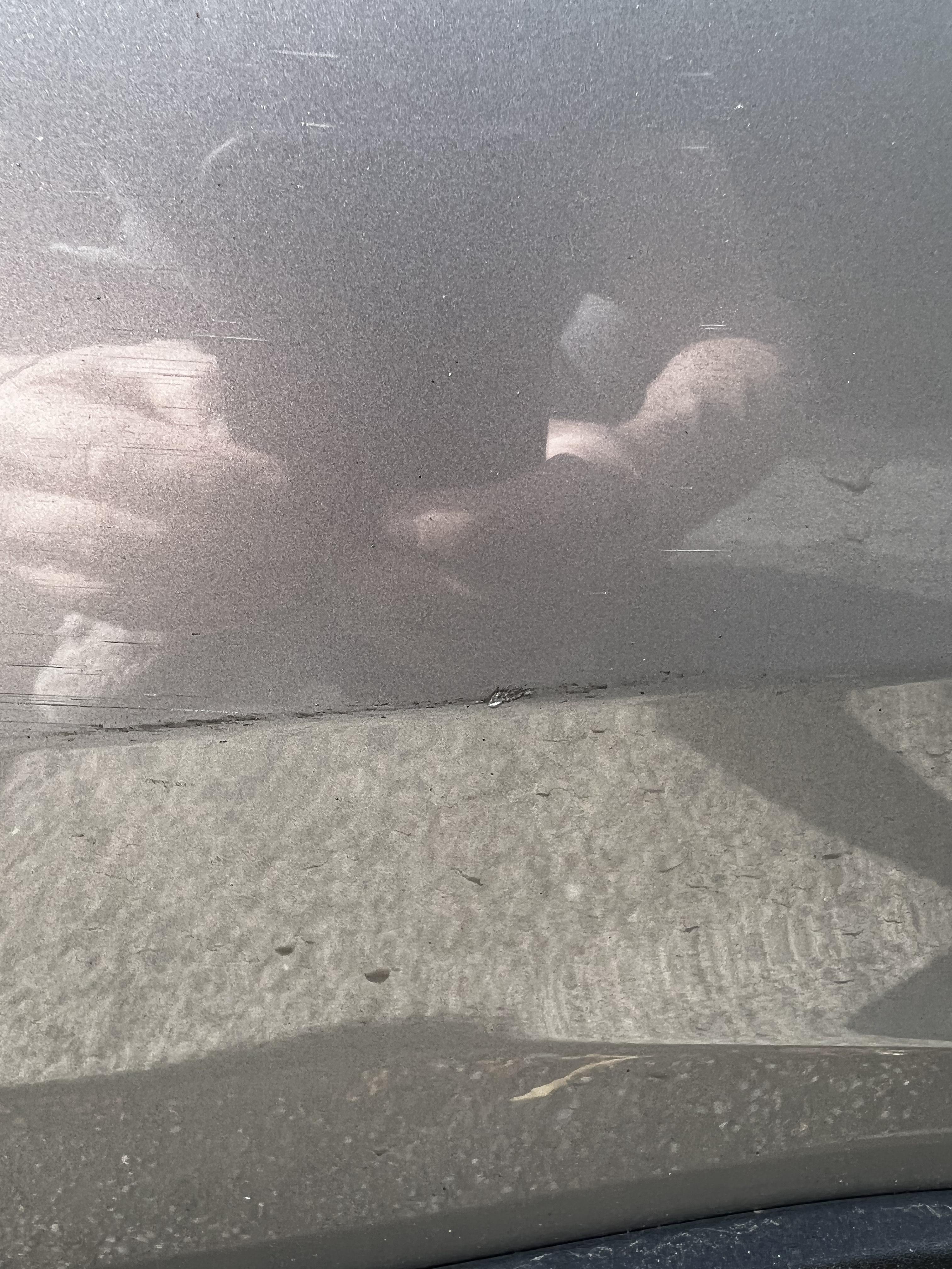

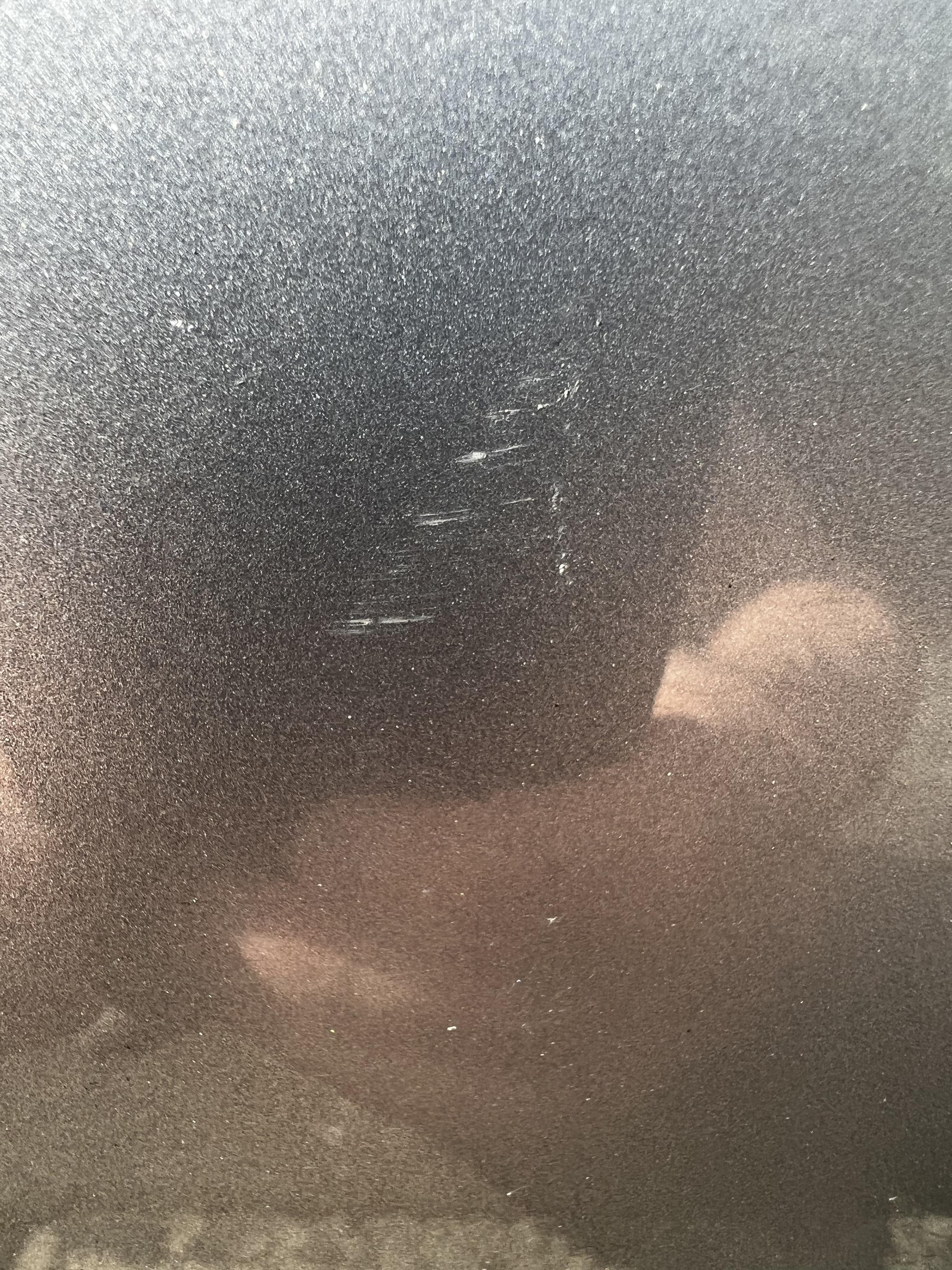

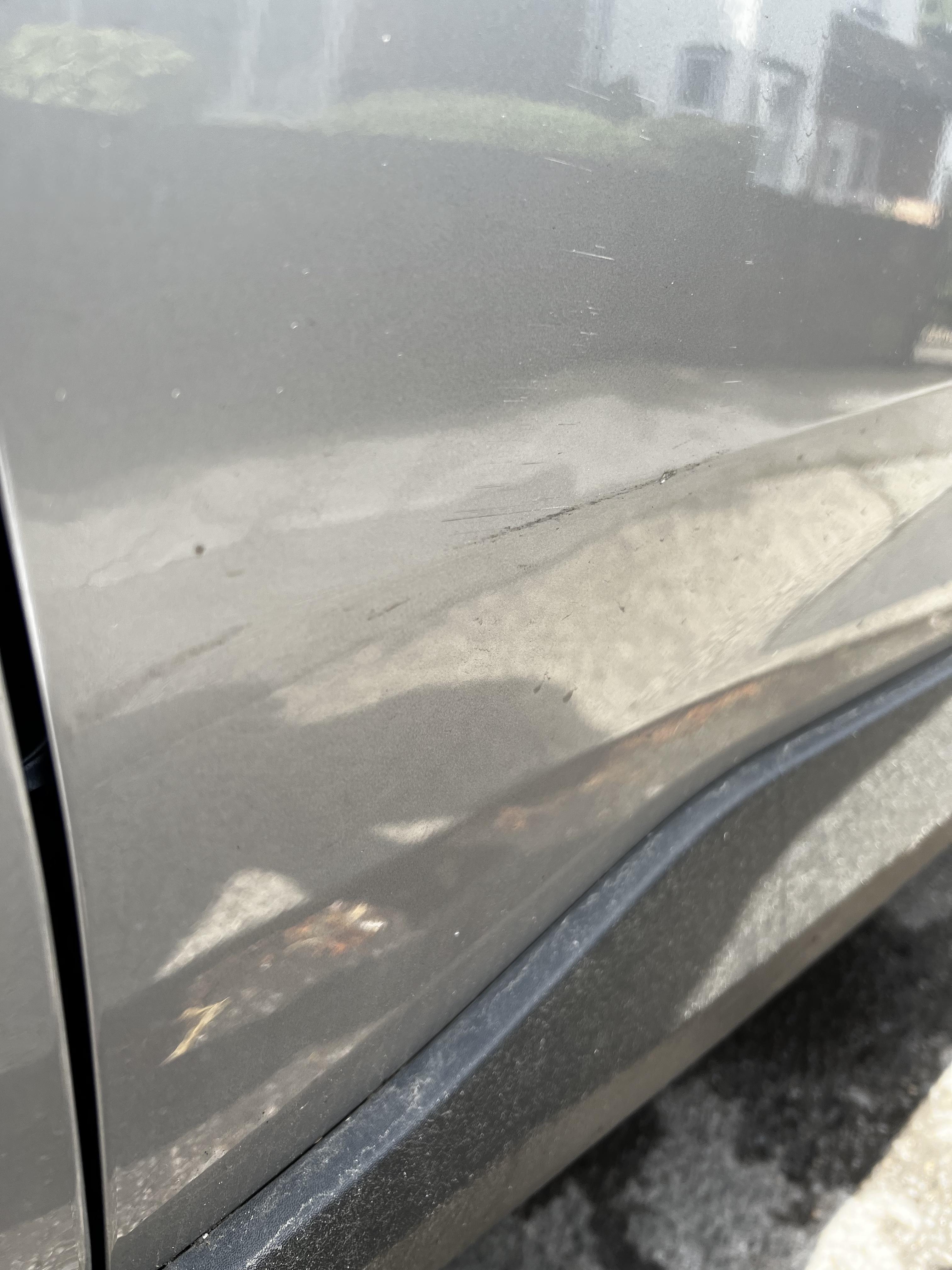

Courtesy of the bin man now I have a few scratches on the front passenger’s door…
One of the smart repairers quoted me £404 , but no way I’ll pay that.
Anyone know of a good scratch remover product? I’m aware that is not going to look like new, but at least make it look better….

If you can catch with your fingernail, it's too deep and needs to be prepped and painted, i would only use a very mild cutting compound like Farecla G10 or 3M ultrafina SE (Blue)
I used this on a small scuff on the front of mine. It hasn't cleared it fully, it's too deep I think but it made it look better and less noticeable.

G3 is very course and the clear on modern cars is thin, you will end up with strike through if not very careful
