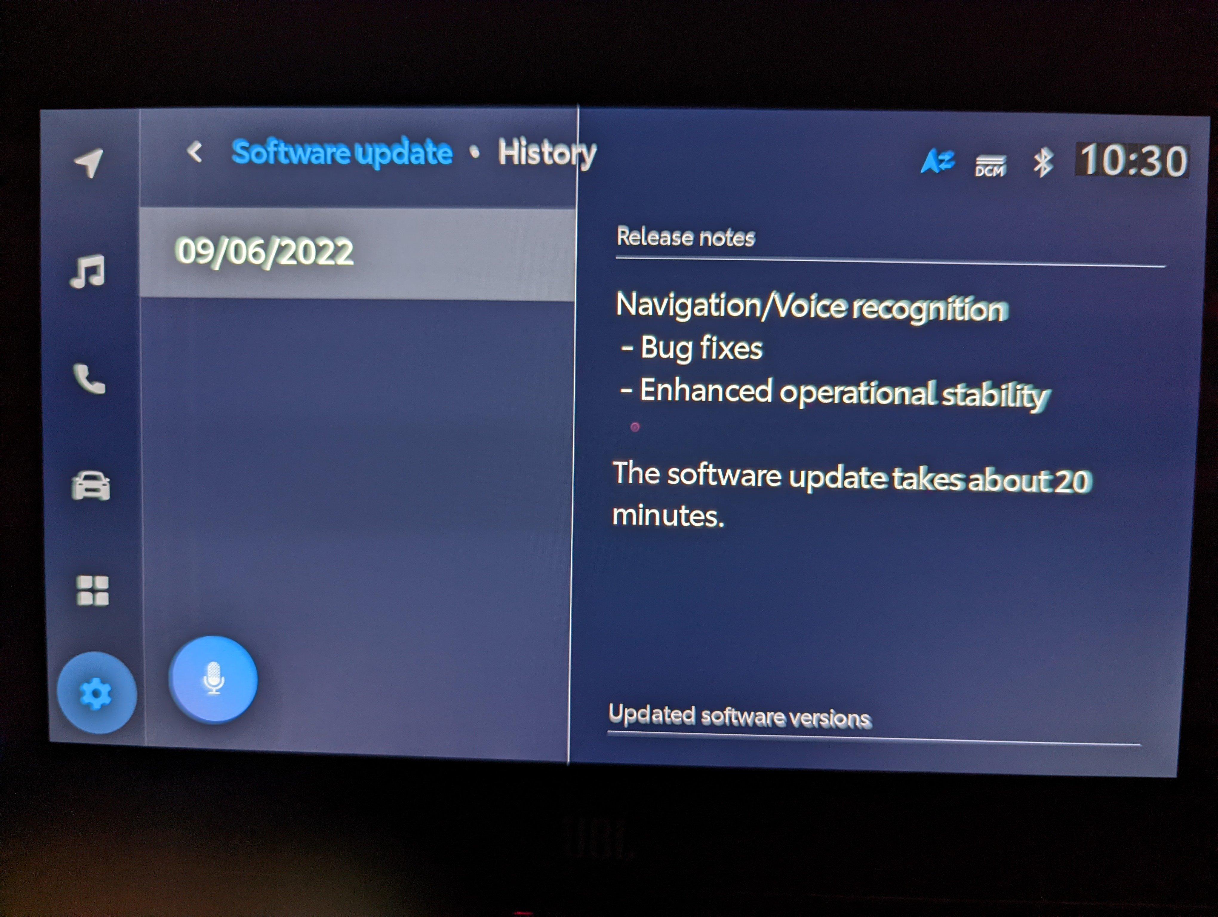

There was a Smart Connect software update issued last month for the system, has you car got that installed?
Its going to be interesting when the first Smart Connect vehicles hit 4 years old & the LIVE mapping services stop working.
Thanks again for your help Lee. I just checked the software update screen and it says No updates available and there is no history. I am presuming that if I connect the car to my wi-fi network I may be able to get this update? None of this was explained when I took delivery of the car last month. I note from your screenshots that the update fixes bugs and I have certainly been experiencing some!

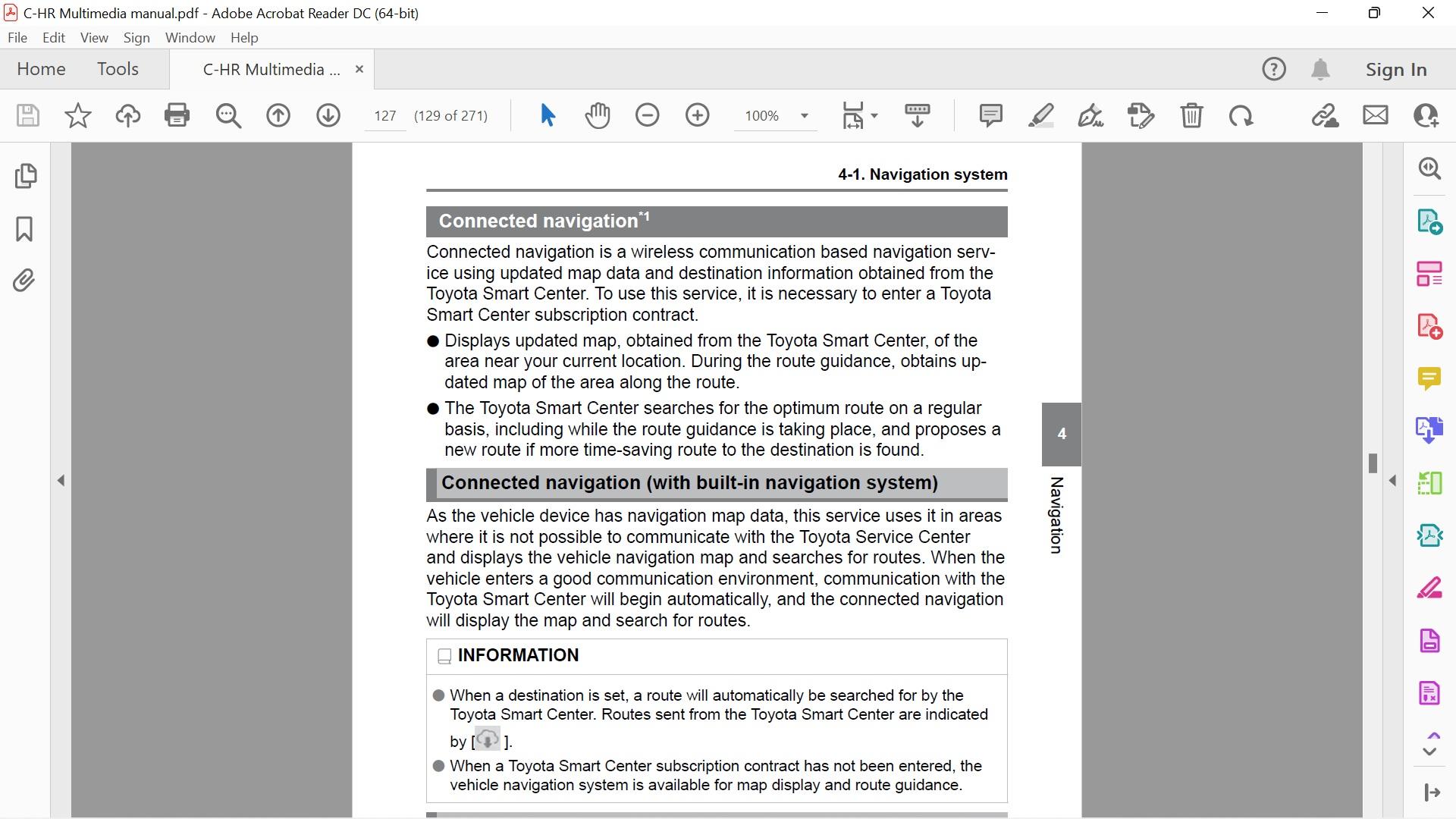

Thanks to this explanation I think I have found the solution to my problem. I believe my car has been using the backup mapping data from day 1. The car had been showing in MyT account since it arrived at the dealership and I had enrolled MyT account for Smart Services. However there was no driver profile set up when the salesman connected my iPhone and .switched on Apple Play. Once I scanned the QR code and connected it properly to MyT account, the mapping screen changed and now displays live standing traffic which it has never done before. I presume that software updates will now happen automatically without me needing to visit the dealer. Thanks to everyone for your help.
