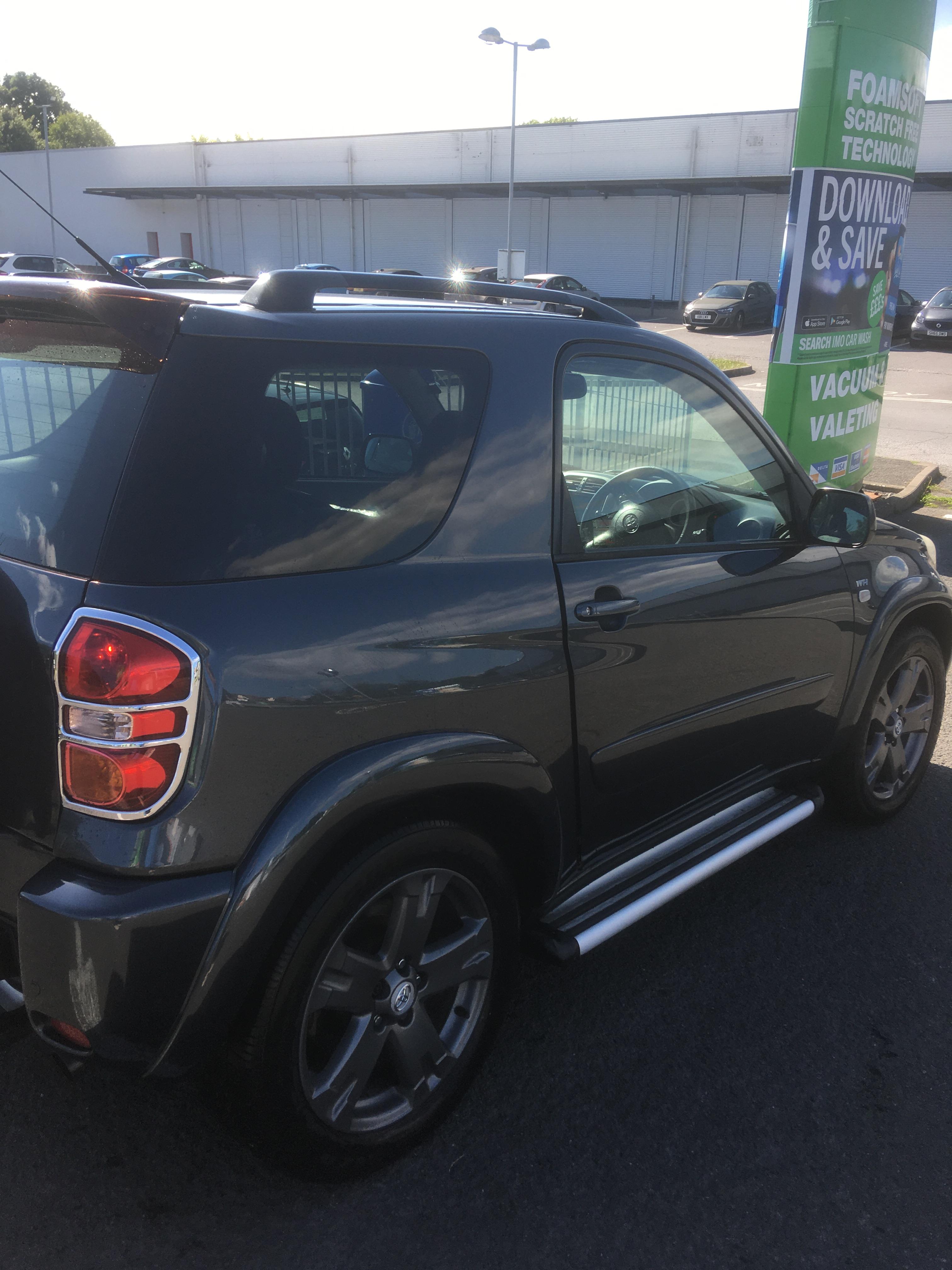

Hi just bought a rav 4 with 18 inc wheels are they more practical or would I be best with 17 inc but saying that they do look nice .
thanks F33CFC0B-9059-4F32-B3F2-C392D8919C13.thumb.jpeg.7e6c827bbcfb64f64fb36f21baab3d33.jpeg

It looks like a 4.2 3-dr; the wheels look as though they came from a 4.3 so I'd guess 235/55 R18s? And, if so, they are exactly the same rolling diameter as the 17" wheels fitted to the 4.3. I don't have the specs for the 4.2 to hand but I suspect that they are the same.
That being the case, there'd be no particular benefit nor drawback switching back to the 17" wheels and the ones you have do look nice.

If the Internet is to be believed the 4.2 came shod with either 215/70 R16s or 225/55 R17s so a properly fitting 18" wheel would need to have rather low profile tyres fitted. What is the size of the wheel and tyre that you currently have.

Depends what you mean by 'practical' - Certainly you wouldn't want low-profile tyres for any serious off-road use, as the first big rock crawl you hit and bye-bye alloys.
If like 99% of RAV4s it's just going to be used on roads and the occasional field then either is fine. You'll get slightly better feedback and the ability to fit larger brakes with the 18's, but slightly better fuel economy, acceleration, braking and cheaper tyres with the 17's.

These tyres although 18” does not look to be very low profile therefore no need to worry about changing them. Set the correct pressure at cold and you won’t have any issues. The car looks very good 👍

I've struggled to find the original specification for the wheels on the 4.2, but I think they were 215/70R16 as per this article on the Toyota media site. If this thread gets moved to the Rav4 there's a good chance that a 4.2 owner will be able to confirm / correct this.
But that then defines the correct size of wheel for your car - i.e. the size that the speedometer and odometer are calibrated for. You are the reasonably free to swap to any rim / tyre size combination that retains the same size wheel.
If I've got the size correct in the first place, then a 225/60 R17 (0.6% smaller), a 225/55 R18 (0.1% smaller) or a 235/55 R18 (1.3% larger) would be suitable replacements.
Do let us know what is actually on the car today.
