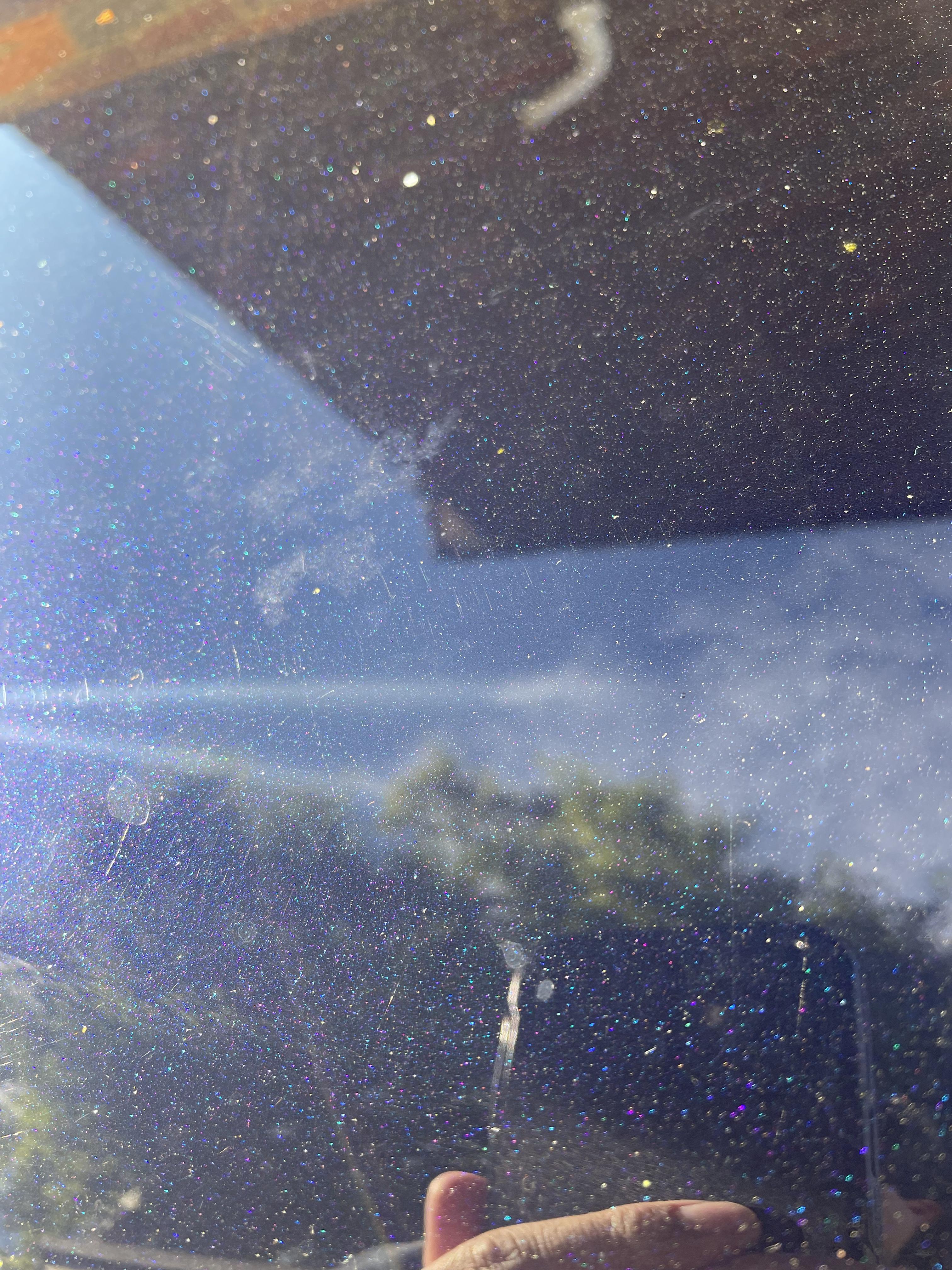

I was welcoming my 2nd born into the world and left my car unattended for nearly a week. When I got back to it the local birds decided to use it as target practice. I only managed to wash it a couple days after I noticed it. I think the birds acid has eaten through the paint of my 4 month old RAV 😞
any advice on how to sort it or does it need to be painted again?
i have attached pictures to kinda see but looks much worse in real life.
Congratulations and commiserations, I hope you can find a solution to the !removed!
Will order some blue T Cut see if that works. Cheers guys will update accordingly.

Usual tip, small area first.
If you have had any of the glaze sealers they might need reapplying.
Looks like top clear coat is damaged. T cut only may not help in this case. A smart repair may needed and perhaps a consultation with a paint shop or auto valeters might be helpful. You can do eventually with sanding a bit the damage area and applying some clear coat on top and then sand again and machine polish it. There are also some headlights restoration kits that contain a wipes for sealing off the newly polished lenses and those may help you restore the lacquer too.
Good luck

had this problem a couple of times now and used t cut in a spray bottle from Halfords ( as already said here)
works a treat and obviously if you have any sort of coating then redo the panel

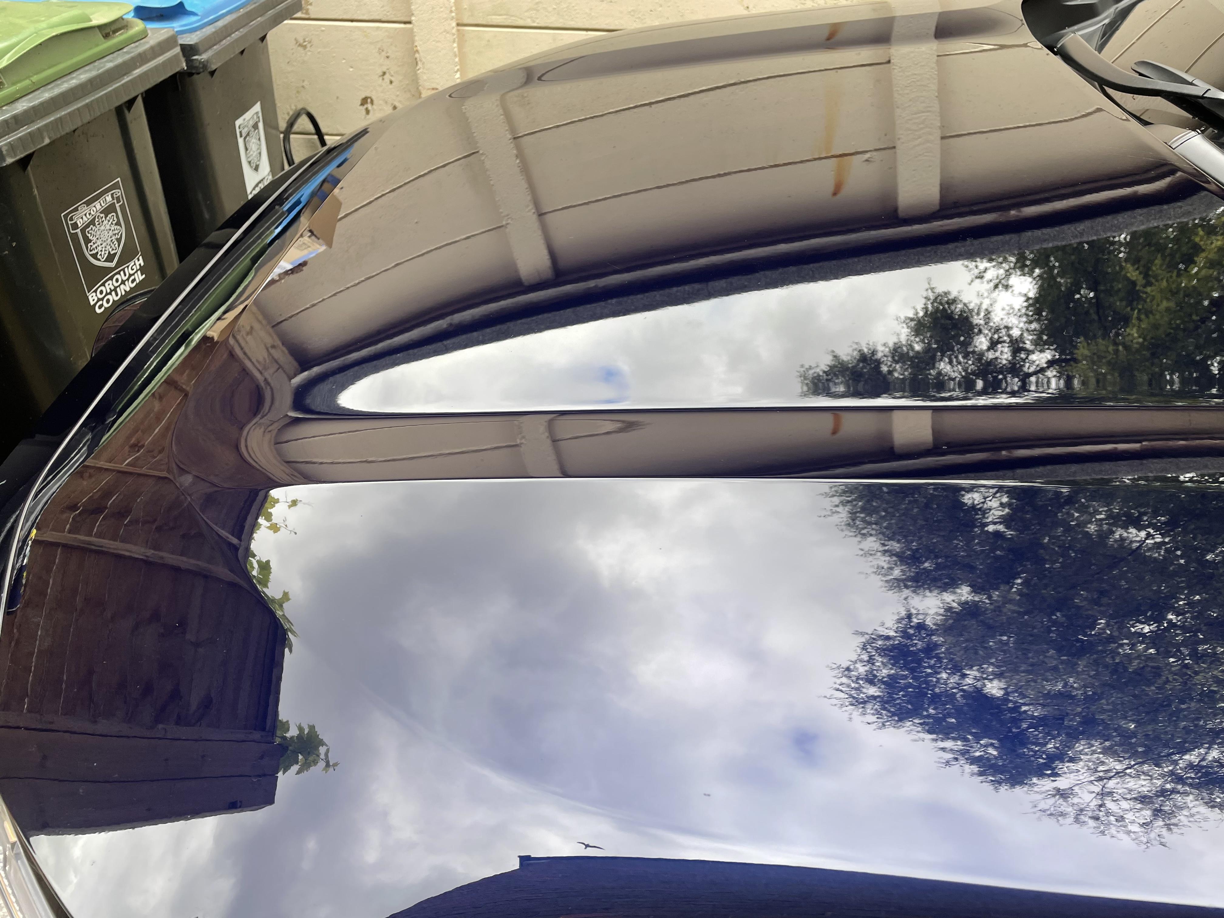

Managed to get it looking much better. Used some blue T Cut on it. Will probably take it somewhere in the future to get it professionally looked at.
cheers all for suggestions!
That looks pretty good you must be relieved?
Now time to get a good protective coat of wax (or whatever) on so as the birds do a little less damage next time ... 😉
