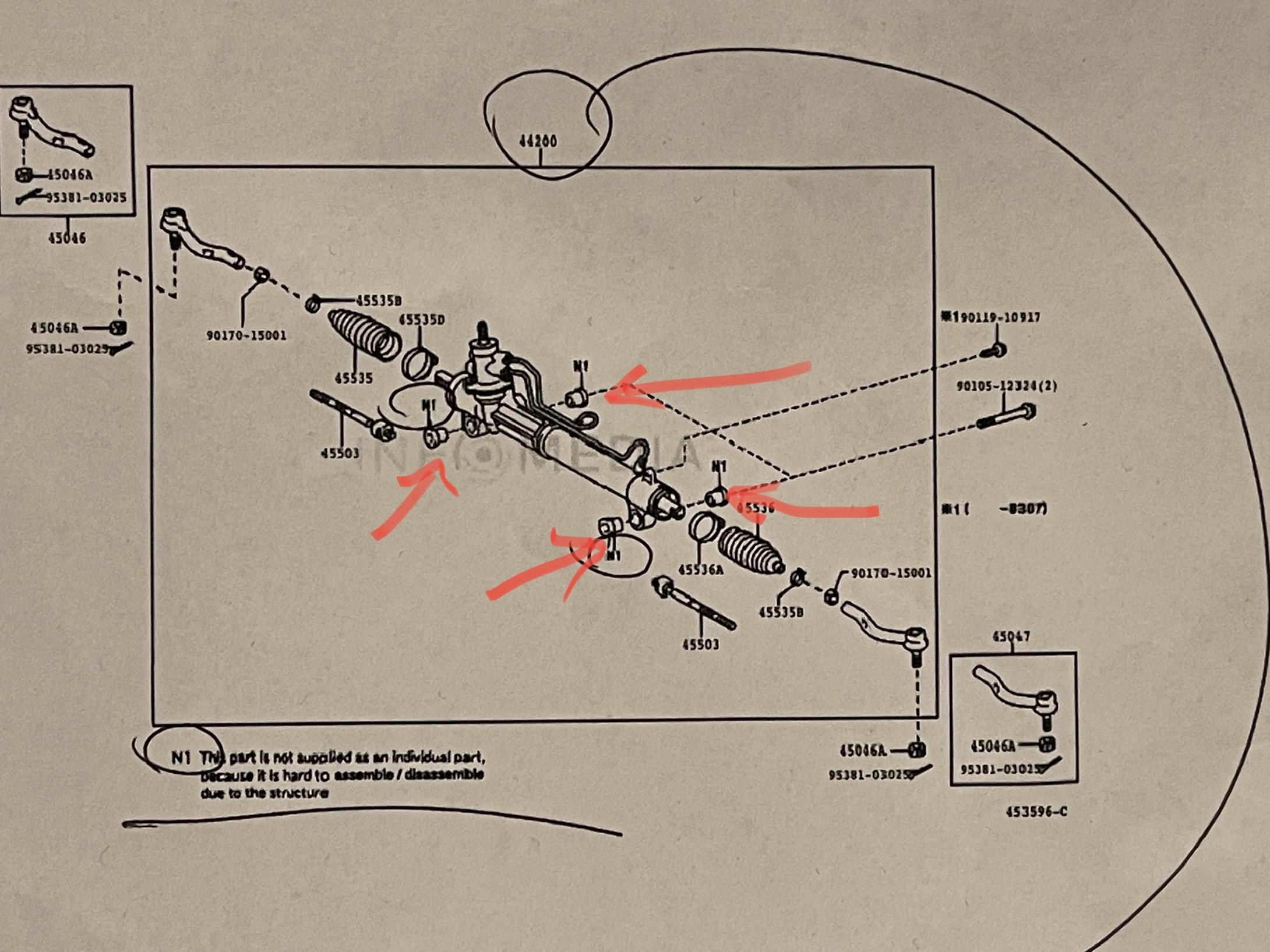

I'm in need of a set of Steering Rack Mounting Bushes for my ol’ 2005 Rav4 Petrol 2.0 AWD.
My local Toyota main dealer are not up for supplying them as parts but will happily sell me a new complete steering rack for a little under £2,000…. Yeah, ok then…!
See pic below for the lil’ things I require.
I have only found them so far for a 2003 model RAV and they definitely do not fit my model.
Would anyone know where to source them or even have some available maybe?
Cheers,
Gordy.
It's not that your dealer won't supply them, it's because those parts have never been available, that N1 code at the bottom of the picture explains. Try somebody like Polybush, they might be able to help
