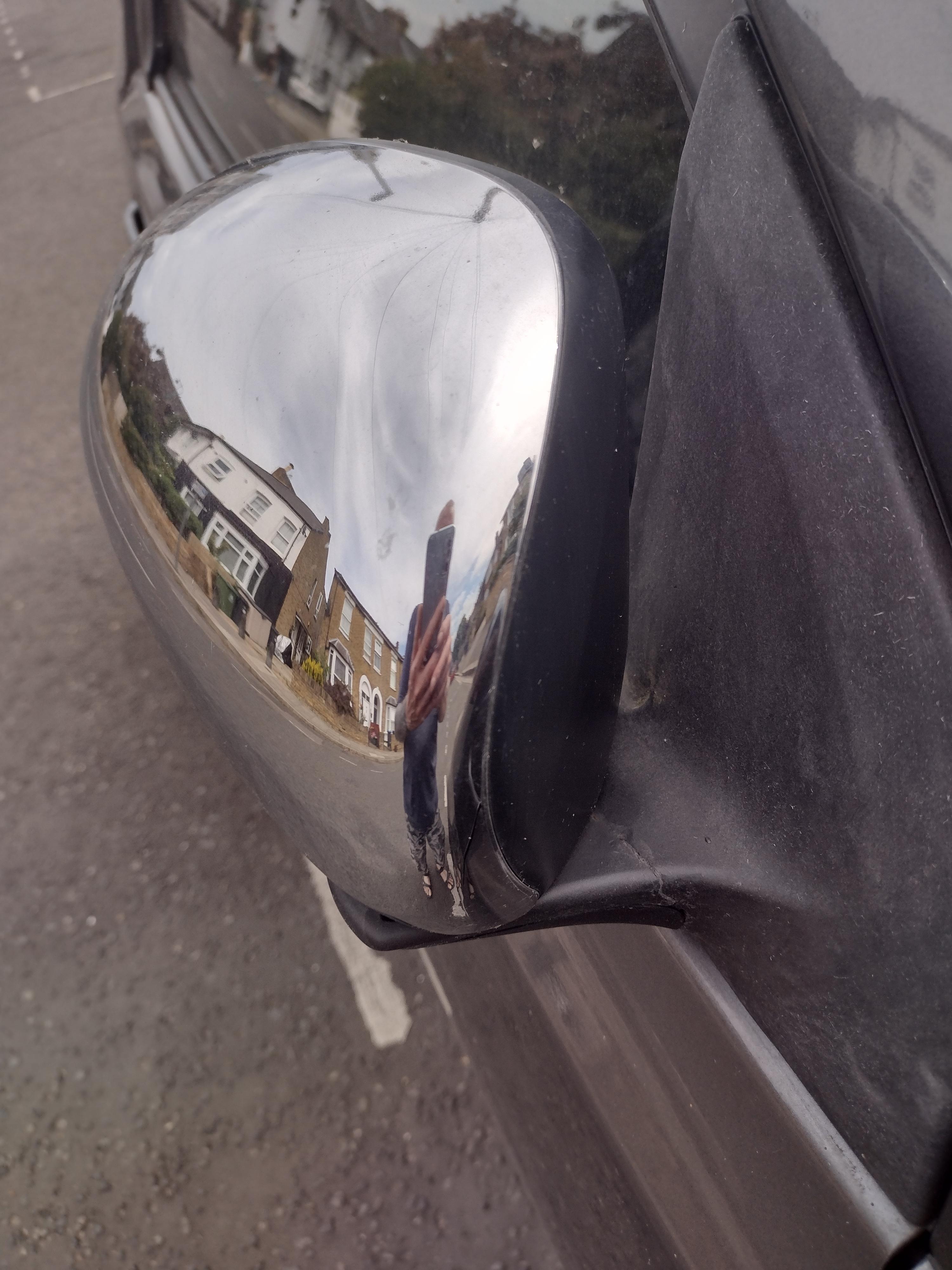

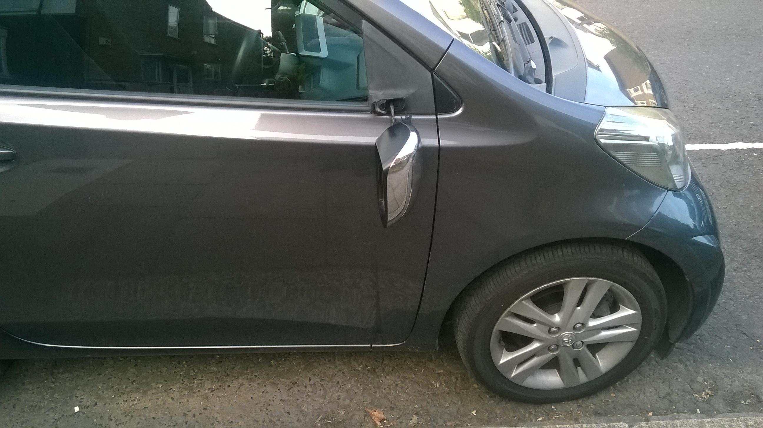

Hi all, some driver drove passed and managed to break my friends drivers side wing mirror, its auto folding and still does fold but cracked!
My question is what other wing mirror is the same? If he were to take apart and transfer the mirror housing? I was told the Prius has similar mirror wing housing! Just to clarify his mirror isnt bolted to the door its a corner mirror.

Hi Jimi. If you're looking to replace the mirror with a similar part, for example a Prius mirror, why not just get a replacement IQ mirror - or am I missing something here?
Is it just the mirror that's cracked or the housing ?
If it's auto folding it will be heated as well, a stick on mirror is just a bodge job
the Jap prius mirror covers fit but the actual body and mount is different
Hi, sorry should have been more clearer, ok the housing is cracked the main Shell, now he got quotes for new mirrors but way to expensive and someone said the prius housing may fit as the housing covers are shared between prius and IQ, and mentioned the that its held down with a spring and bolt the you can swap over the housing onto the mirror holder etc.

It's not bolted together on the IQ you are more than likely break it, getting it apart
what year is it ?
Hi all ! the IQ is 2010, its an autofold mirror and cant use any glue to stick back etc, the mirror does fold back making a clicking noise and under inspection the base plate the housing s bolted to the door is ok not cracked! Its the housing itself you can see a small crack! Must had been some serious mirror impact! The mirror housing itself can be detached the same way it was put together getting hold of an IQ autofold mirrors are expensive its why someone mentioned that the prius autofold mirror housing is the same as the IQ and can be taken apart and swapped over but i have not seen this to confirm. Its why me mate was asking me to find out if its true and this he will get a prius wing mirror and sawp over the housing and retaining the original mirror base etc.

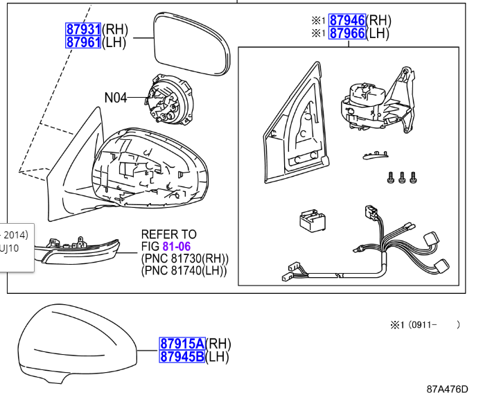

There are multiple parts available separately so perhaps a complete unit is not required?
And none of the parts share with Prius or any other model they are IQ specific, a quick check also shows plenty of pattern parts out there from reliable sources such as Euro car parts etc

Also may i ask this picture of the mirror in breakdown form, is it an online parts catalogue? If so any links to it please!

It is only the rear covers that are the same as the prius - Rh mirror electric, heated and retractable 87910-74020
just buy a used mirror, what are around £100 or get a cheaper mirror and swap the guts over
as per your other thread Iq - Aygo mirrors there is no plug and pray solution - you can ask the same question in many ways, but you will get the same response
