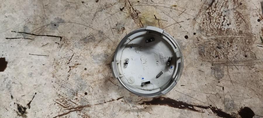

I suspect they are the same size for most wheel diameters. The centre "hole" is 54mm. As can be seen they are secured using a round length of spring steel exerting an outward force. The part number for silver finished "Hub Caps" is 46203 - YY150. Yours are a different finish Emma, to match your wheels.

Mine most definitely don't turn. However, as Lee suggests, if they don't fall out, leave well alone! They are, of course, made from solid platinum, so expect a financial shock if you do have to buy one or more. Upwards of £15 each for the real thing (in silver).
