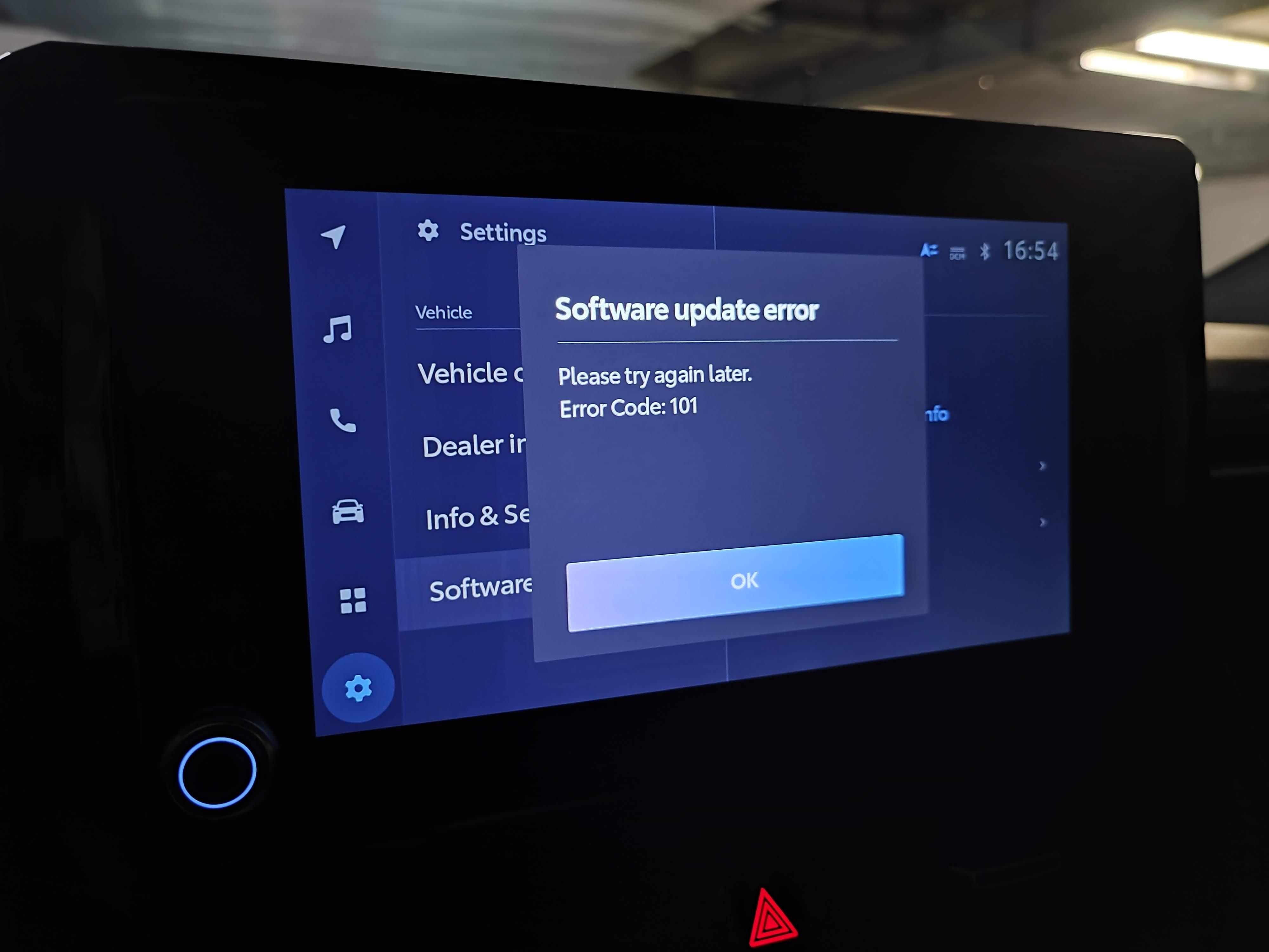

mine sometimes tells me an update can be installed but i have avoided it due to previous comments on this blog.
Still have a problem with searching for address, but meanwhile...
That is a new one on me. The message that I used to get was Unable to update Software, please try later. ErrorCode: 110. What version is your HU SW now? It is listed under the Model Info link.

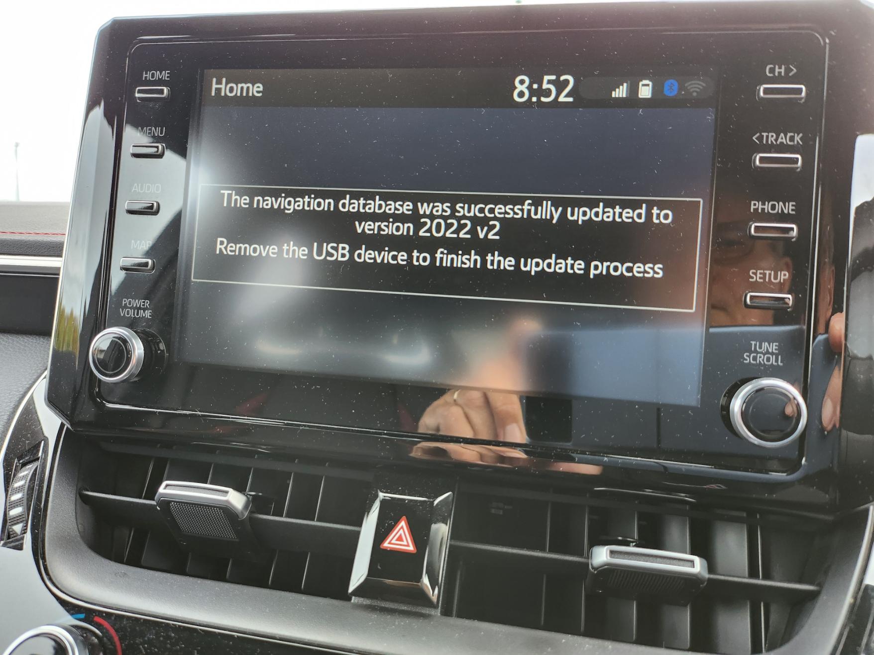

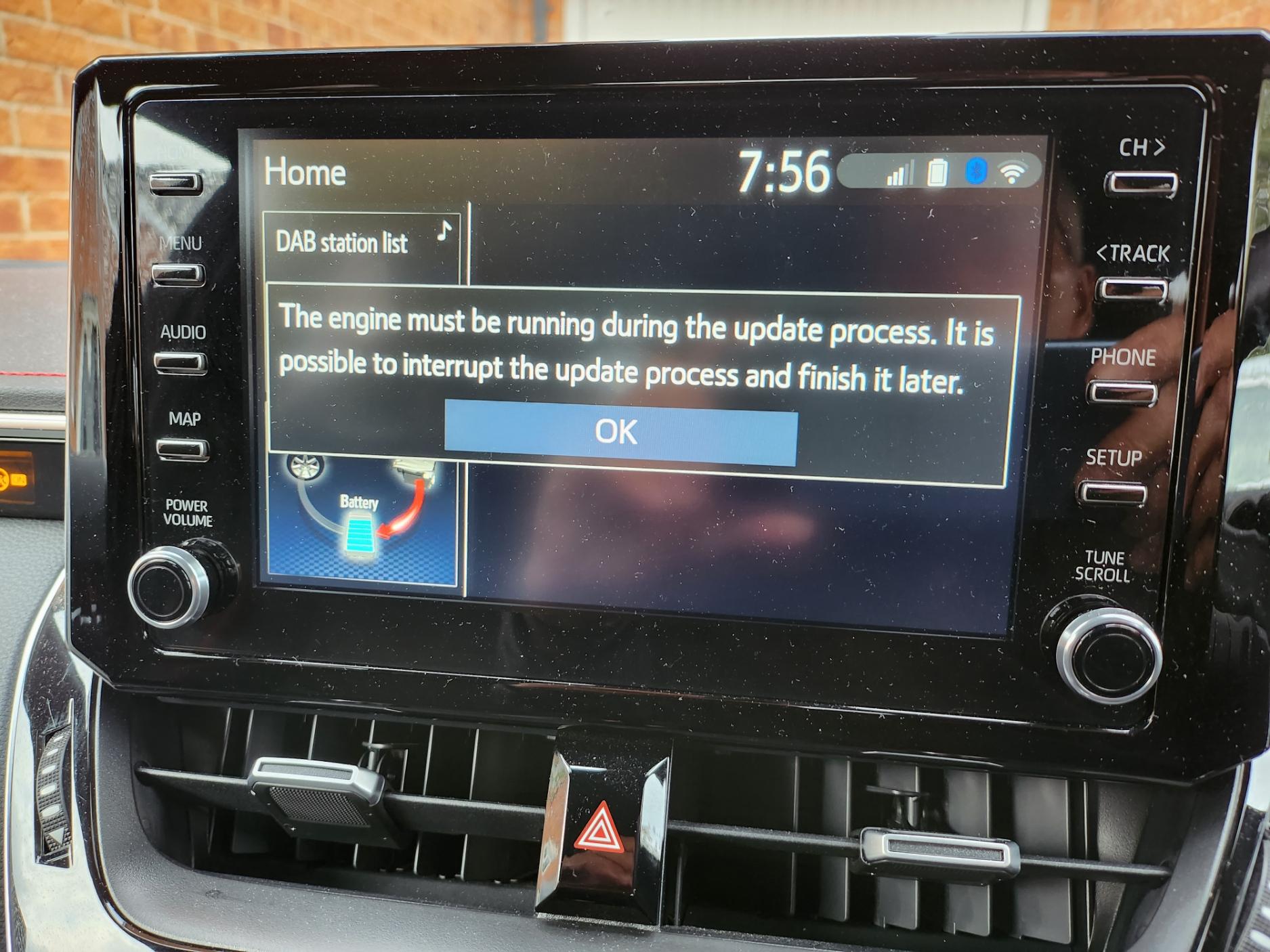

Finally got around to the 2022v2 nav database update. My car's running the 2022v1 version. I rarely use this built-in navigation, preferring Android Auto and Google Maps via phone and head unit. But I do like to have the built-in system up-to-date, just in case (Android Auto isn't the most reliable tool you can have).
But this time, it's been a real process and I've not yet completed the update. After nearly 90 minutes, the update has barely completed a third - it's got to starting package 8 out of 21. Every previous update I've done has taken about an hour or a little more in total (this is via the USB drive) - this one looks like it will be 2 hours at least.
So I ended my drive around while the update was going on, returned home and switched off the power. Anyone else had similar experience? Nothing amiss with the update package of files as the update does run. But it's taking forever!
Am I right in assuming the update will restart when I next turn on the car? Would it be at the point it paused, or will it start all over again?

The 2022v2 update took the usual 1hour 20 mins to install for me. I don't know why your update is taking so long though. I believe it say's at the start of the install, do not remove USB while installing. I reckon you may have to start over again as you have stopped the install. Check that 2022v1 is still working ok before you try again just in case this has been corrupted in some way.

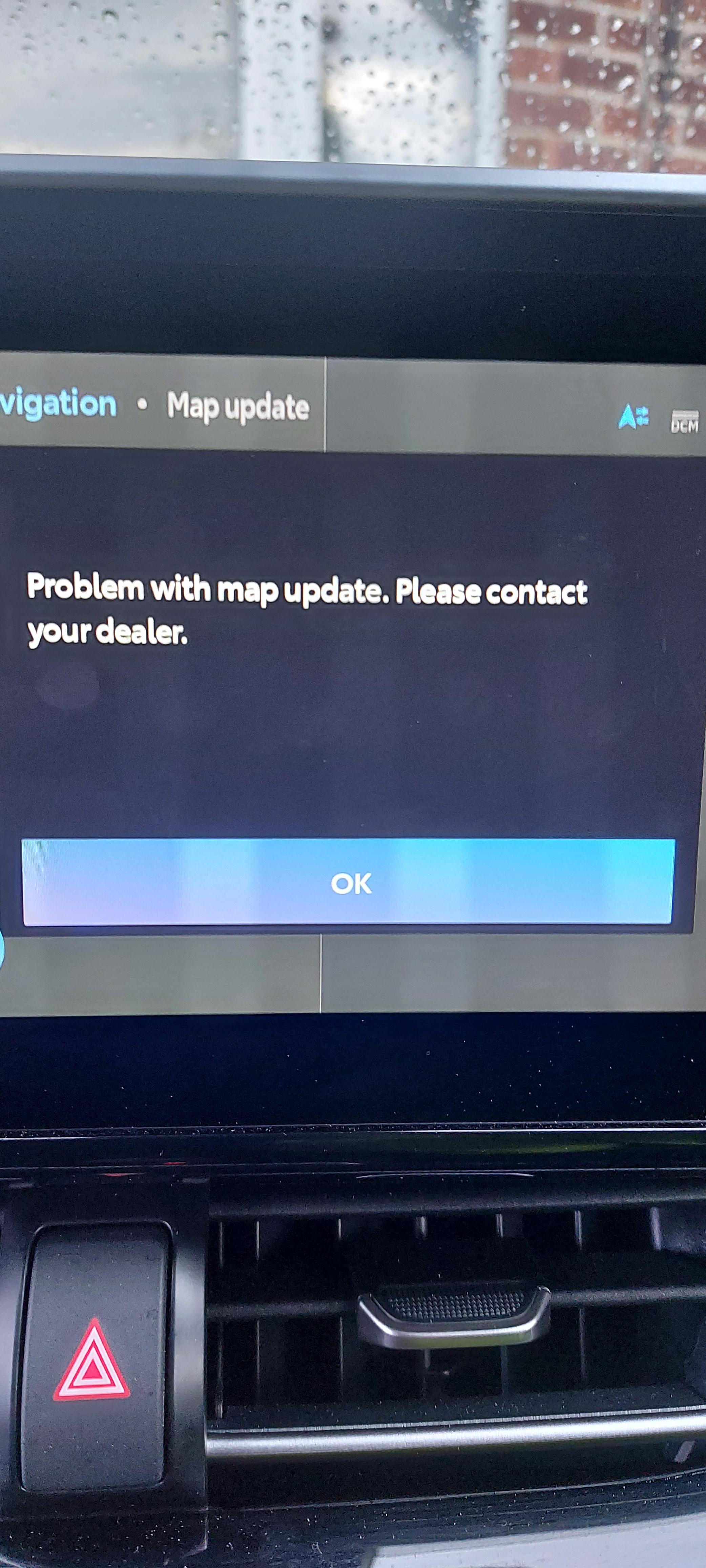

I have a 2022 CHR I have same issue being unable to type in the postcode manually it only works on  voice my system is showing no updates. But the map updates is showing problem with map updates. Please contact your dealer.
I have also contacted Toyota Multimedia support team this is known problem. I booked my car in at the dealership mid November to try and sort it.
That will only update the back up base mapping data stored inside the Smart Connect unit.
The navigation system only ever uses that when it hasn't got a data signal via the DCM.
The DCM as been checked at the dealership its showing strong signal and SOS button light is green not red and I am getting traffic updates. I have been told other owners are having the same problem with the new Toyota Media system.
Smart Connect uses LIVE mapping data for navigation via the DCM - it's always up to date.
The base mapping back up data can only be updated via a Toyota dealer.
The system only uses the base mapping data when it cannot get a data signal via the DCM.
Toyota should really update the owners manual / information message or better still remove the map update option from the Smart Connect system as its just confusing owners.
When I next used the car yesterday and powered it on, the database update resumed from the point it had stopped when I powered off the car a few days ago.
And then, about an hour later, the update successfully completed.
At least the software is smart enough to know when an update attempt happened that then paused so it didn't want to start again completely from scratch. And I noted that the navigation system prior to the update attempt was still fine, ie, with the v1 database operating normally.
But odd that the update took nearly 90 minutes to process packages 1-8 of the 21 in the update, and then a further hour to do the rest. Such an archaic process!
Glad it carried on installing for you. It looks like a successful install. But that does puzzle me why it took extra time to do it. All's well that end's well as they say.
