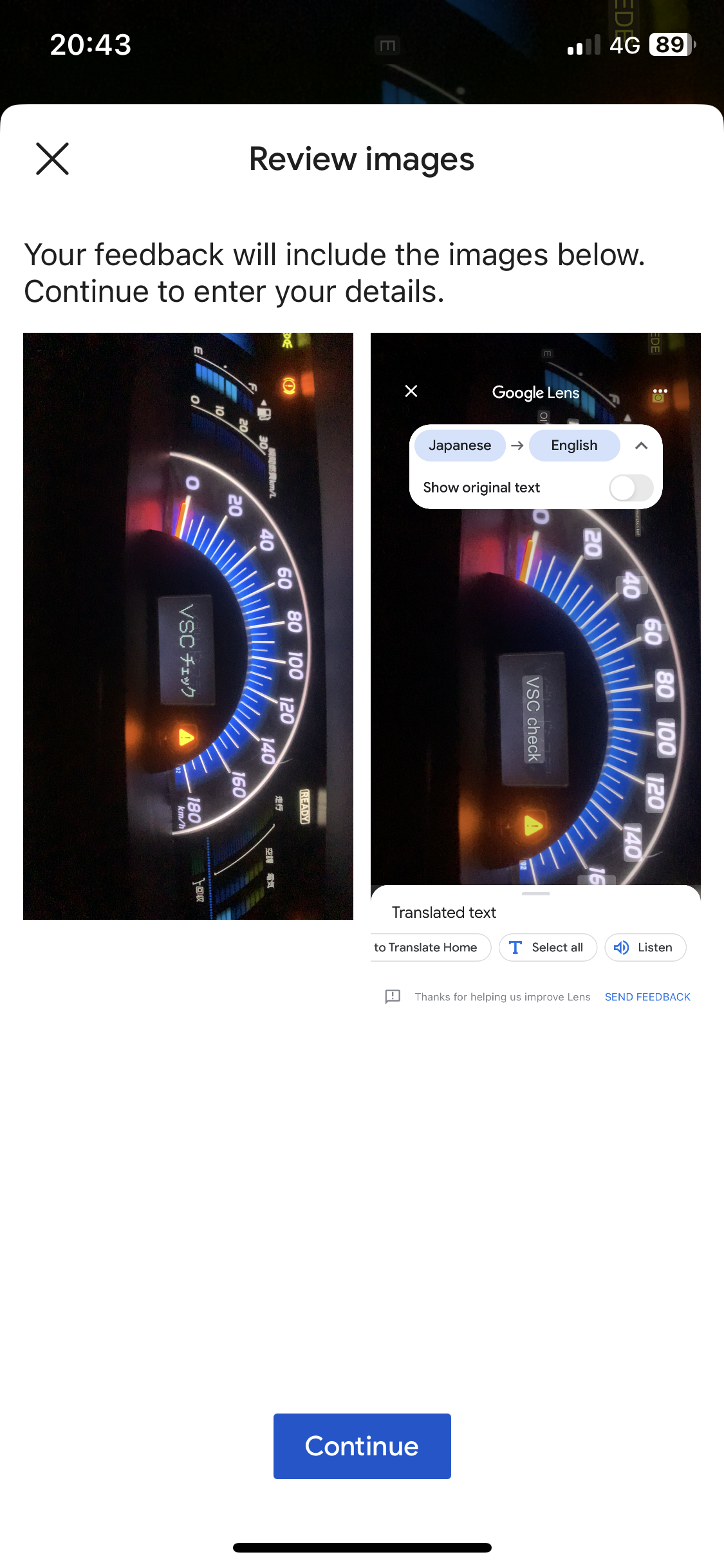

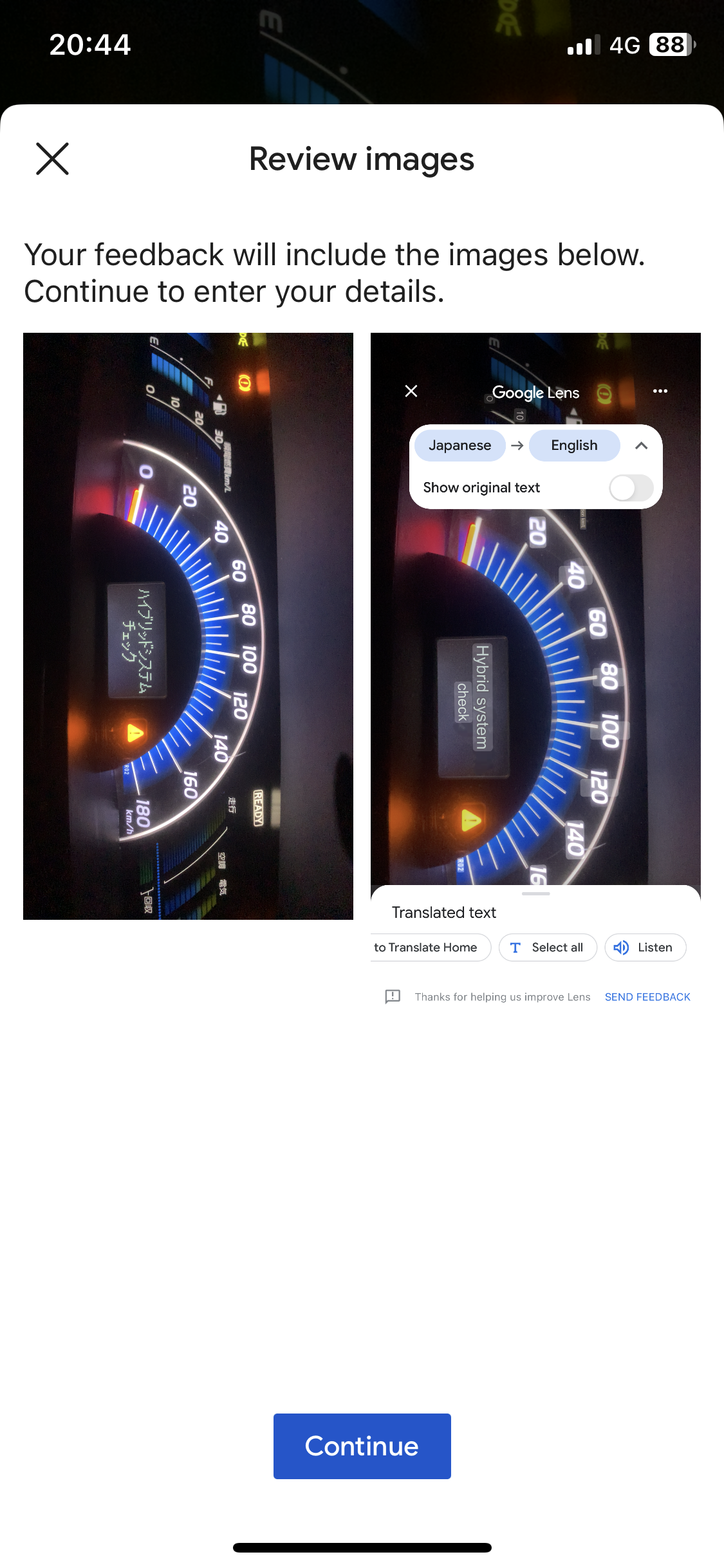

I recently got engine light on on my Toyota estima x 2006 petrol hybrid imported car, so took to local garage where I normally go to, after diagnose he said replace hybrid Battery pack,
while I thought hybrid Battery is for life,
anyway my questions are
1. Do I have to replace Battery? Can’t I just run the car as it is now? If I have to change battery then where To get it from?
2. Is this safe to run the car without hybrid battery pack? Although it’s running on patrol fine, the only difference is it is not running on hybrid for 1st when you are at speed of 30 or less miles per hour,
3. If I don’t change battery and just run on patrol, how to switch off engine light, I believe having engine light on is mot failure, please confirm,
4. has any of you come across in my situations and how did you deal with it?
thank you for reading and replying

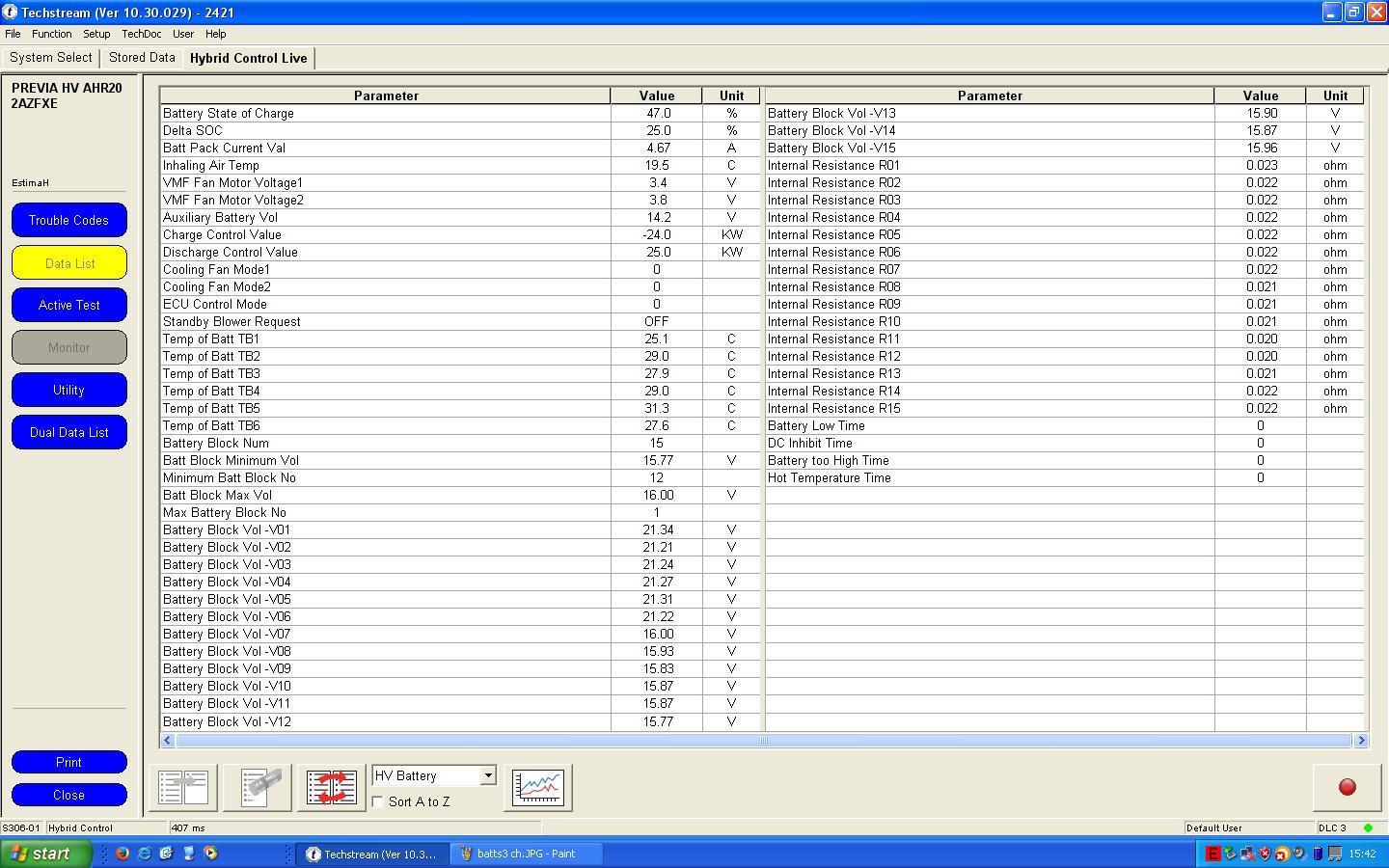

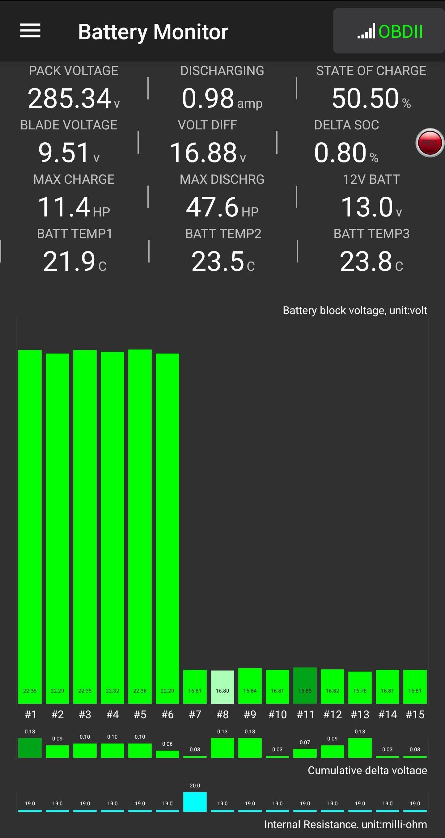

What level ov voltage is displayed from your High voltage pack 3 pars or more will be normal.
