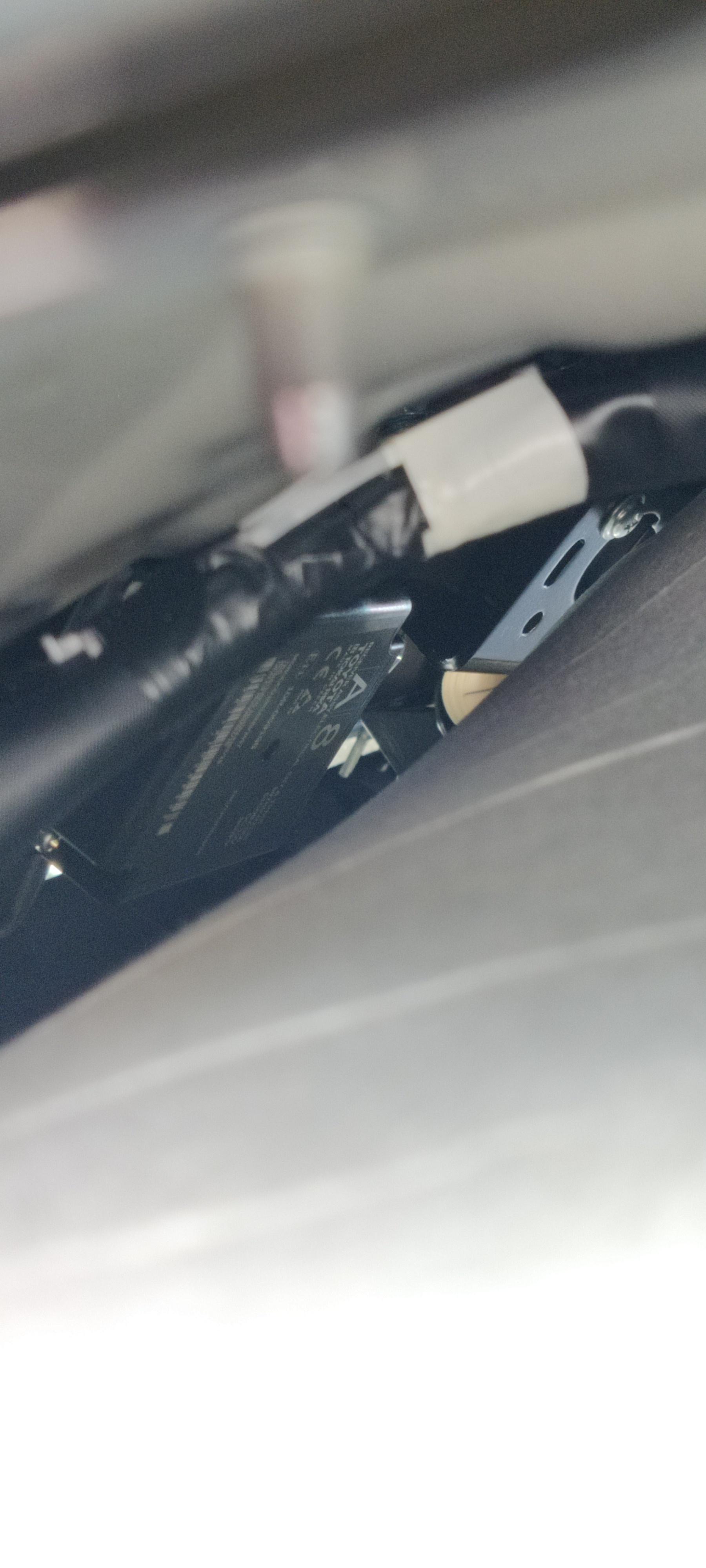

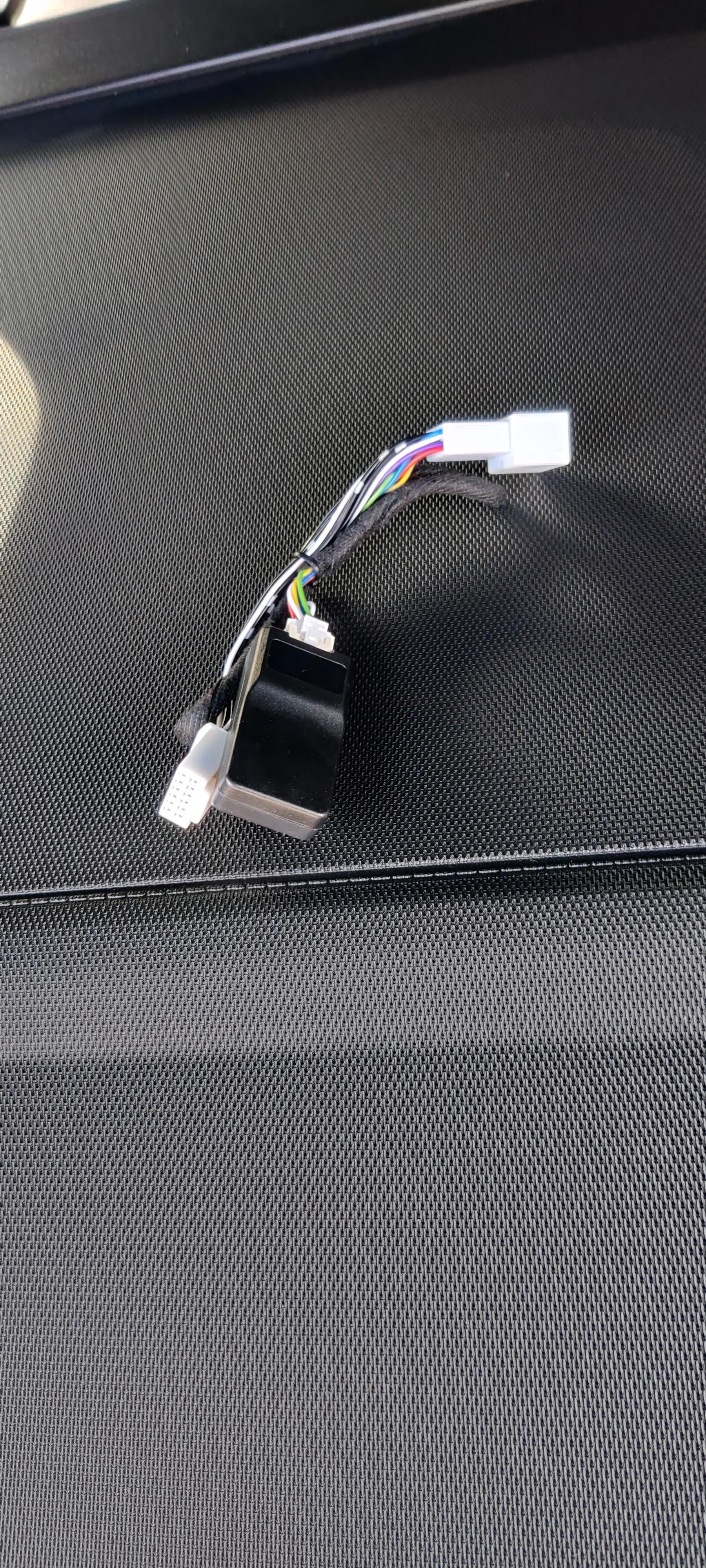

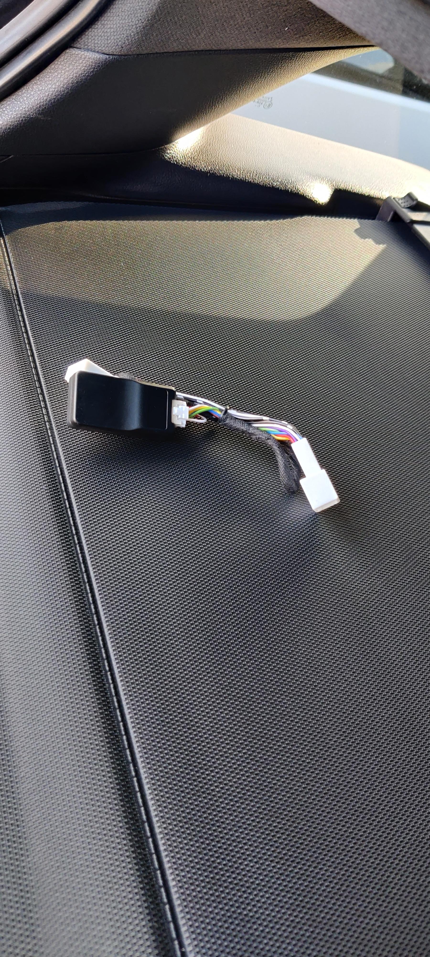

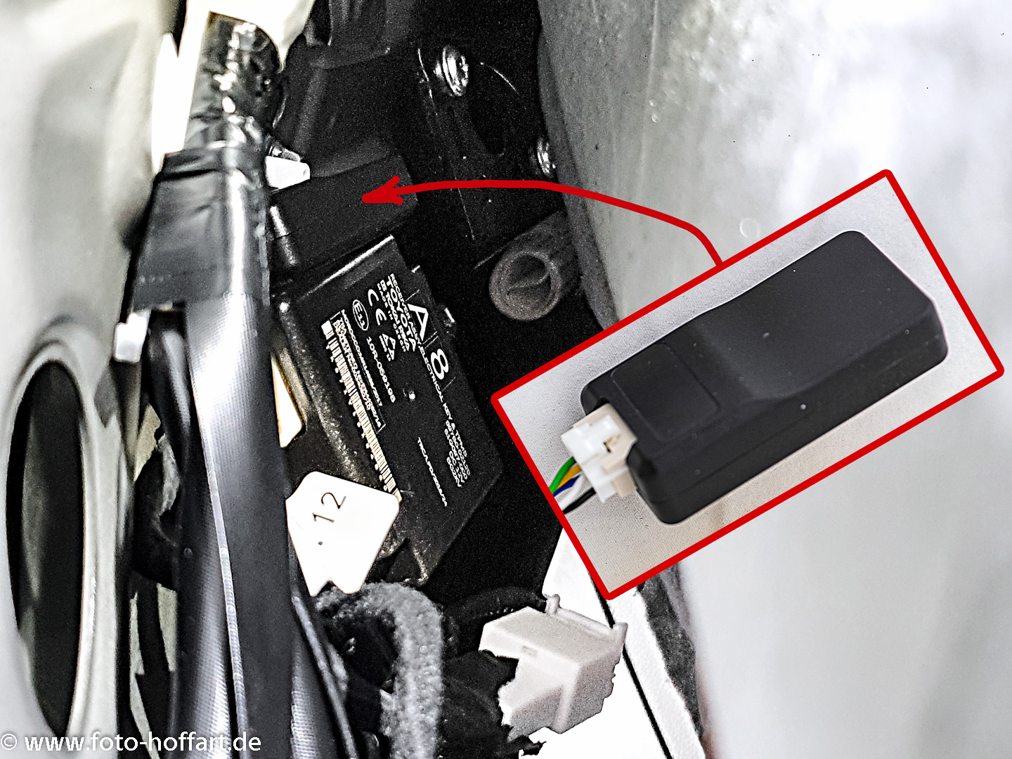

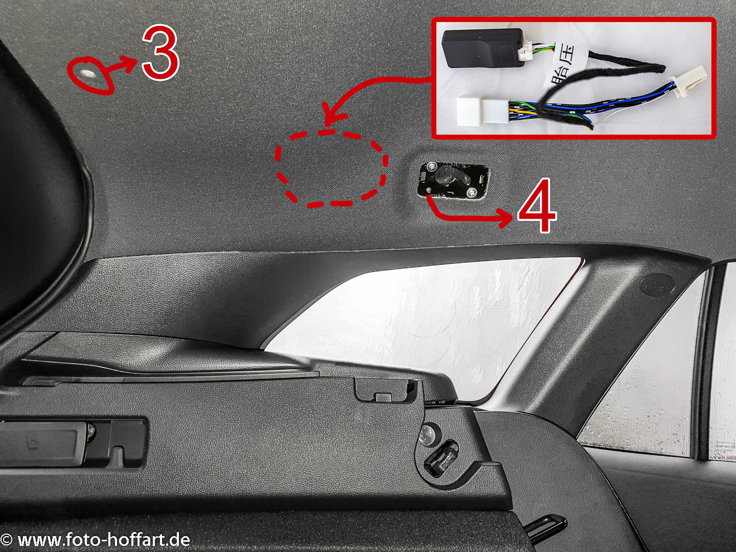

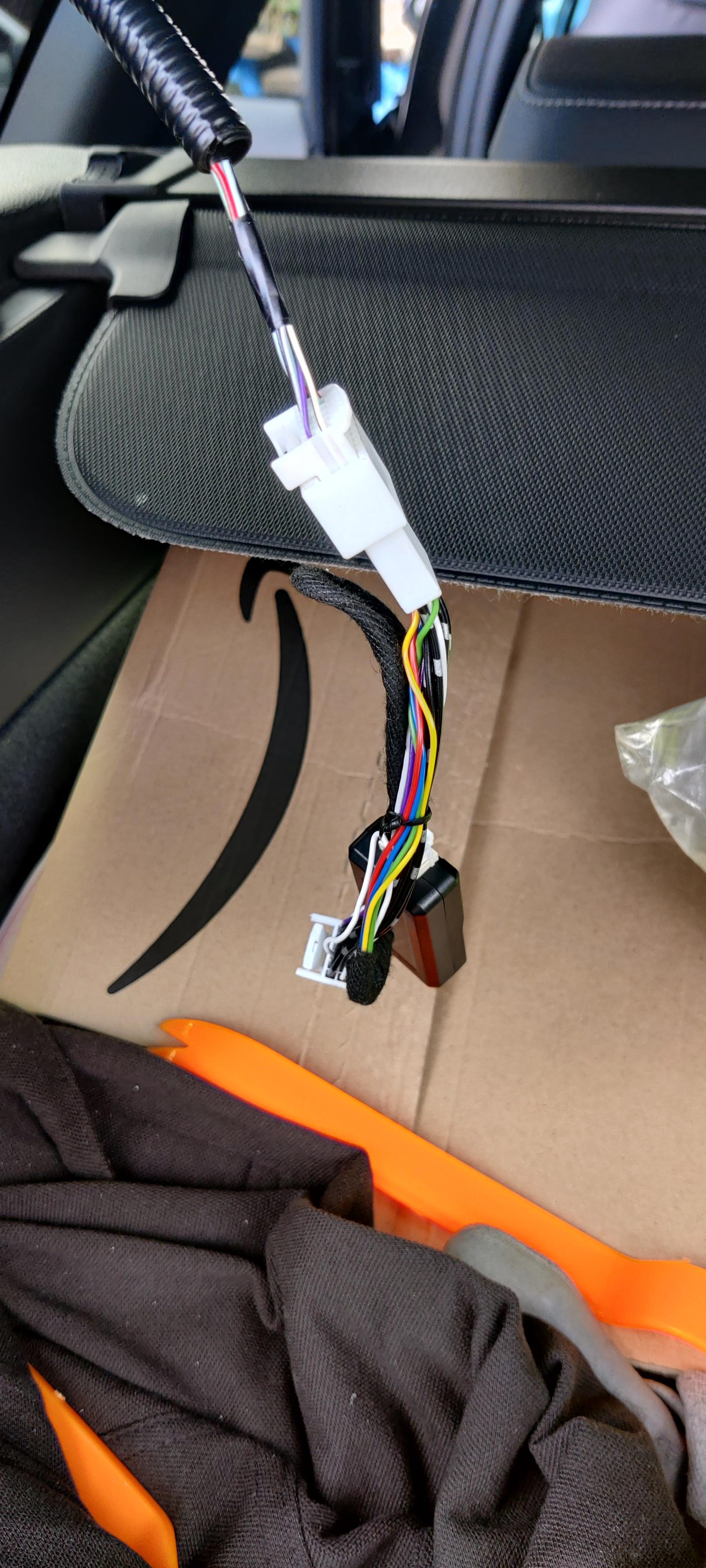

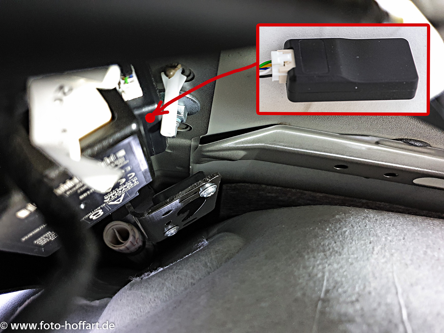

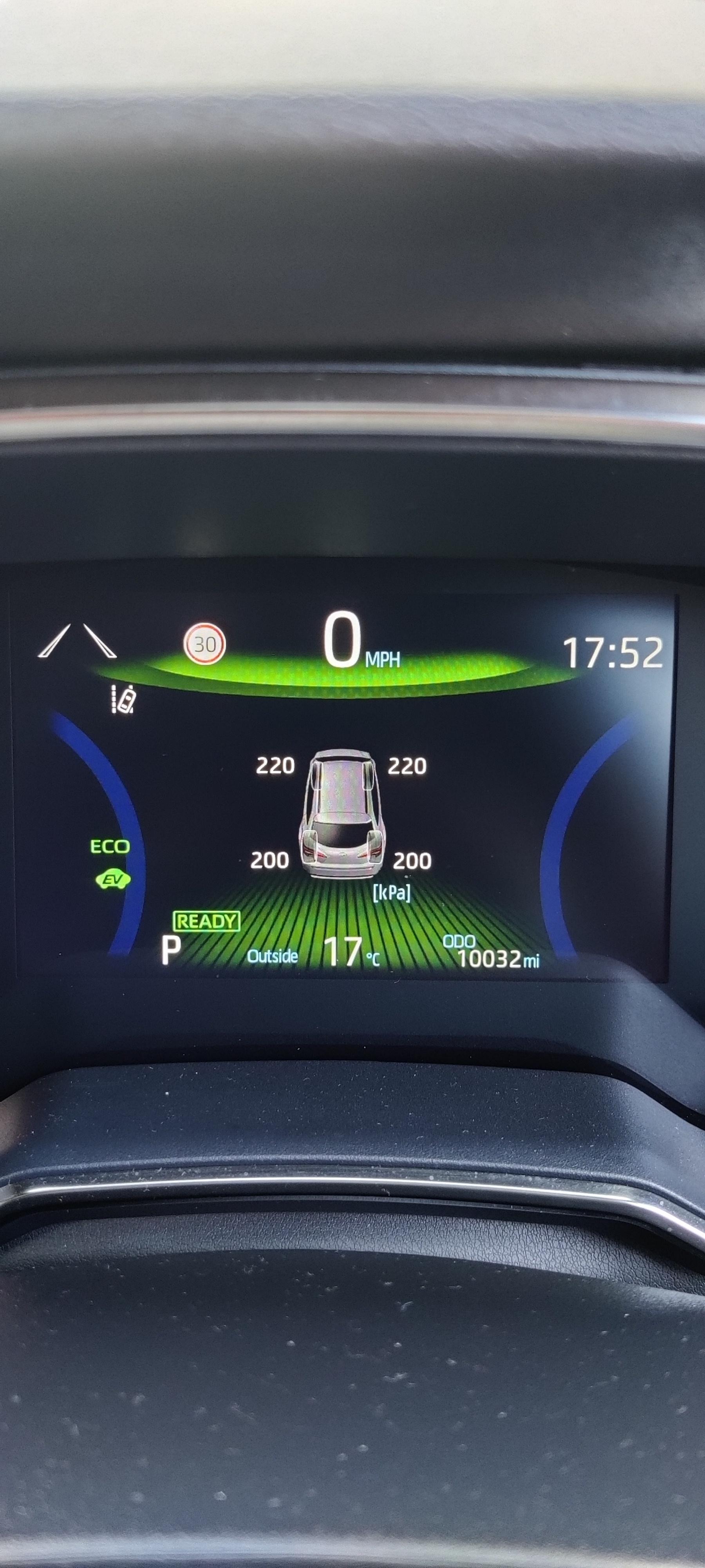

So today I just installed a piggybacked tmps to my toyota corolla touring sport.
Kept getting low pressure light in but couldn't figure out which one but this was a big help.
You just unplug & replug back into the Y lead adapter.
This was ordered of AliExpress for £30.
Only took about 15 mins to install

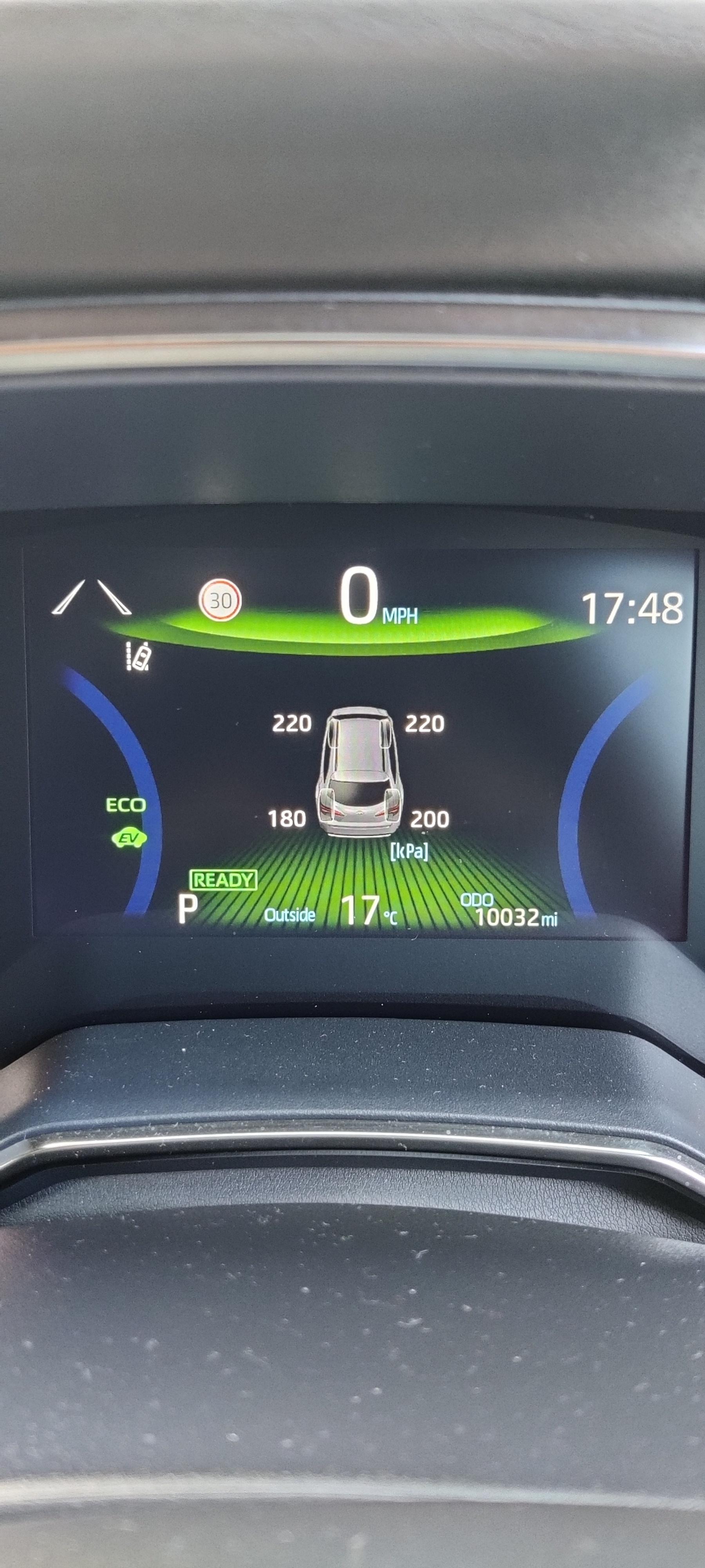

That's a neat little mod, did the dash update automatically with the tyre pressures once installed?
Yes mate takes a few minutes to balance up.
Notice when cold the tyre pressure drops then when driving you see it go up.

How does this integrate with the dash?
When you go through the instrument settings you see just the car but when connected it shows the values.
