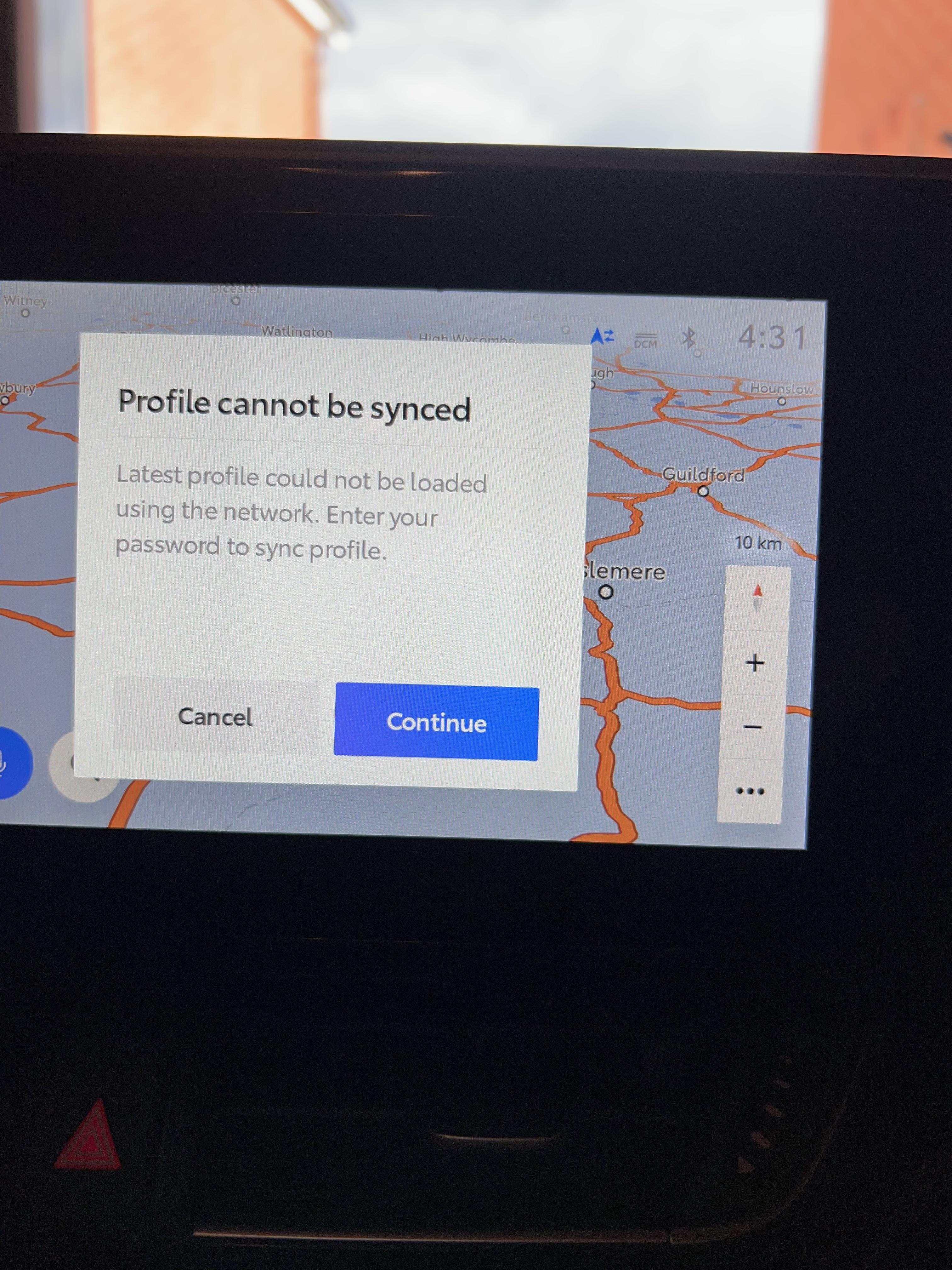

Roger F
I keep getting the above message and it’s very irritating when driving. Everything is working fine and Apple car play is great. The problem is when I go to log in my old e mail address which I stopped using nearly 2 years ago comes up. I cannot find anyway of deleting it and putting in my current e mail.
I am thinking I may have to reset everything. Any ideas guys. Thanks Roger.
I still get this on the very odd occasion but has got better with using Android Auto, I only ever had one email so do not get other option other than guest type account. Have you looked in your account on the web to see if the old account is still there, if so surely you can delete ity from there as I have found that you can do so much more from a computer than the app on a phone.

Delete your profile from the head unit then re-scan the QR code via your MyT account to re-link, the email should match the one used in your MyT Account.
