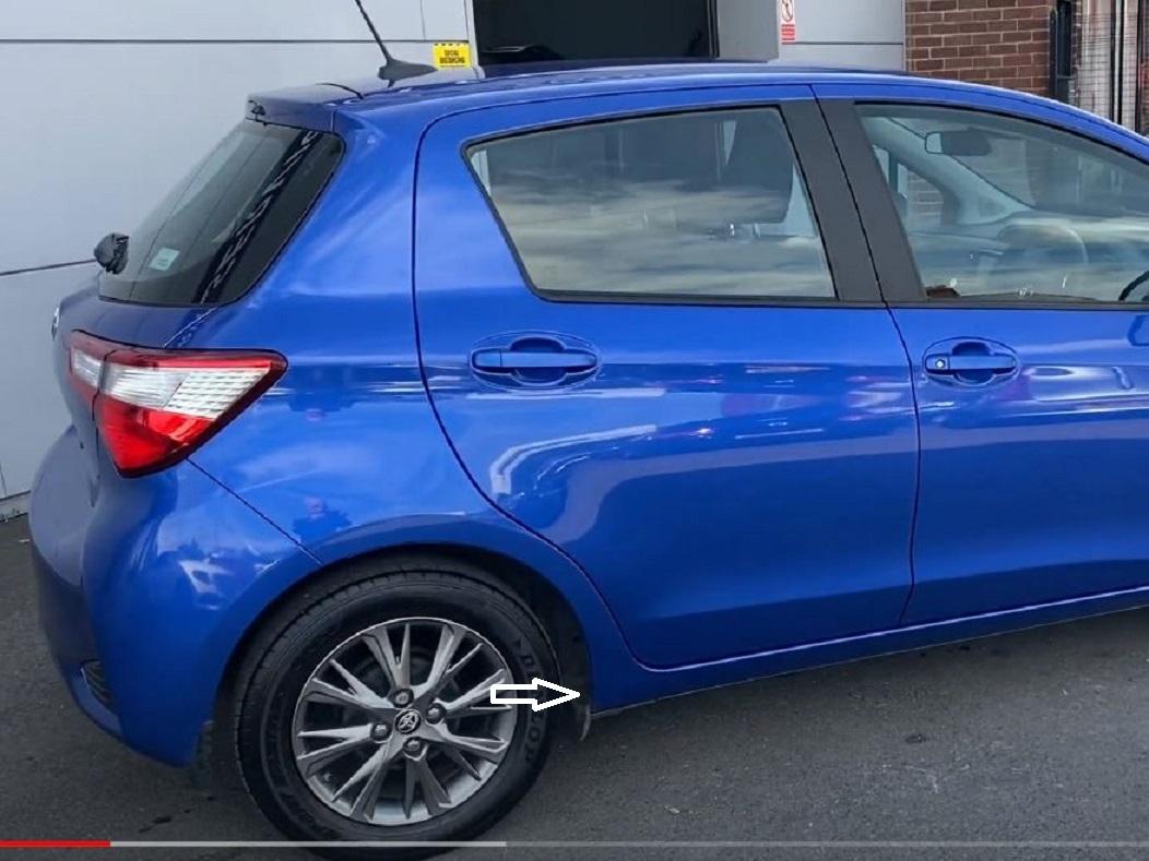

I noticed tonight that the rear wheel arch (arrowed below) has no plastic liner the bumper half does but the front part doesn't, its bare metal with some kind of thick tar like substance painted or sprayed on and there is quite a "shelf" at the point i have marked is this normal as it will gather mud, road salt and other nasties if not cleaner regularly and i would imagine over time it will rust.

All the mk3's are the same, no rear liners just the rear cover for the bumper
Thanks, as rear arch corrosion on earlier cars is not a topic i have seen i guess i can rest easy having read your earlier prediction of 15 - 20 years before problems may appear 😉
The yaris has decent rust protection, 15+ years is conservative
early jap mk1's (99 - 02) can rot around the arches and inner and outer sills in the same place, the French built cars don't seem to be as bad, TBH any car at 18+ years old will have some rot no matter the marque then your getting in to cheap end of the market, run the car till it dies territory or fails its MOT
average life for a modern car is 7 years - Nissan (Renault) have it down to 5 years now

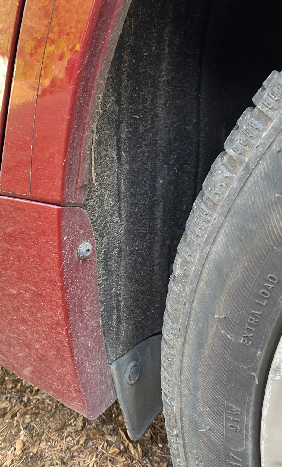

Most Toyotas come without fully lined rear arches. Lexus do. Although, I think that's more for sound deadening than outright rust protection. To allay your fears a little. Here's that very same spot on our 2003 Yaris - no liners...

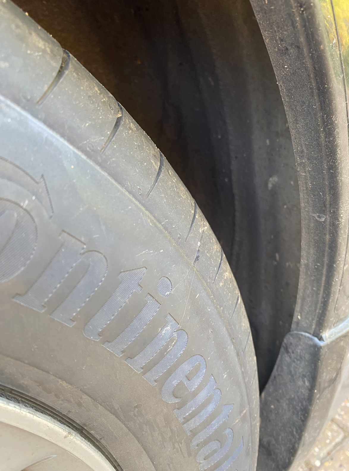

I see now that the clumsy photographer didn't set focus on the wheel housing. But if you're interested in tyre walls, that's very much in focus!

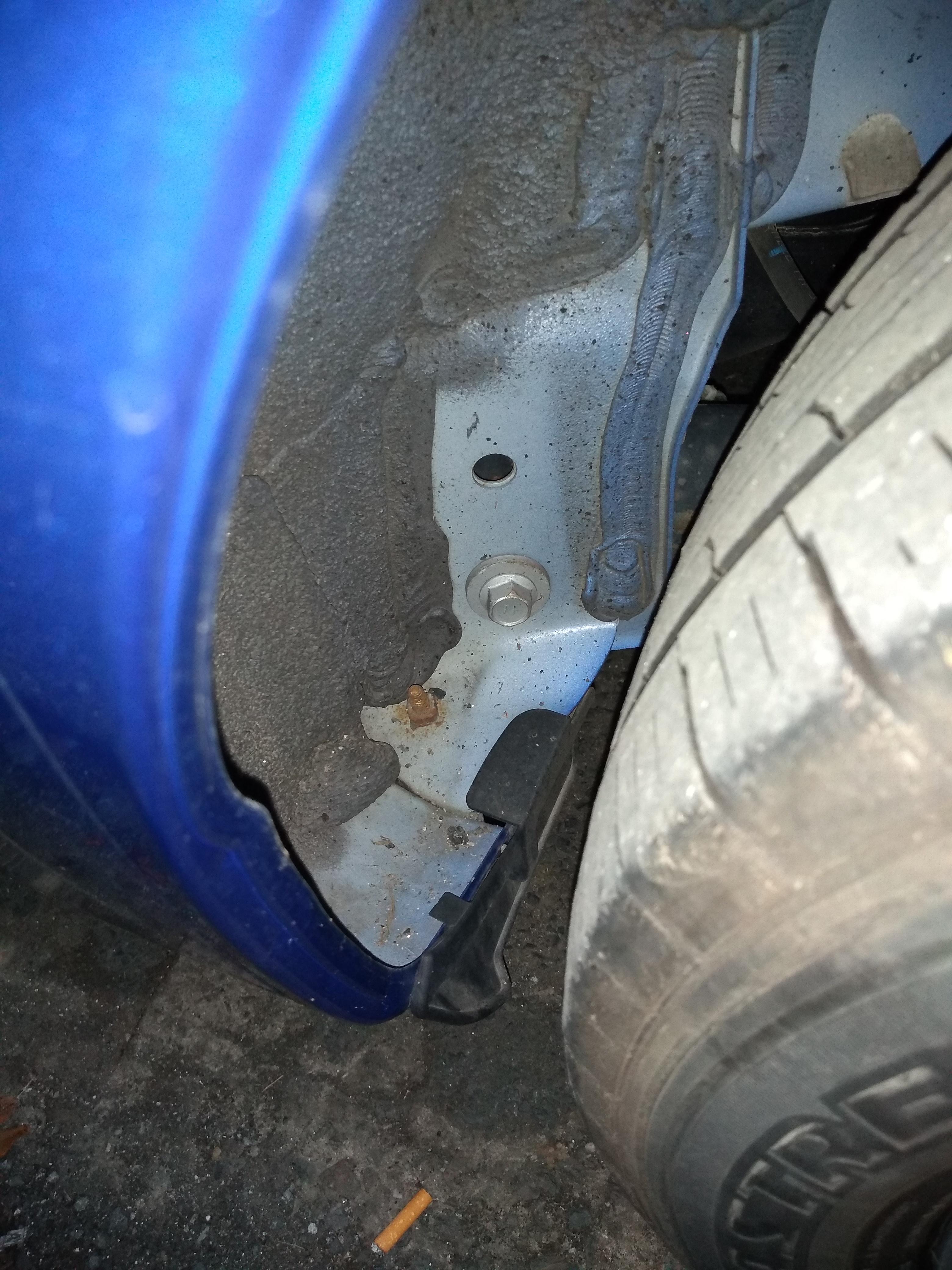

Here it is, you can see the underseal black stuff ends before the metal at the bottom would it be worth spraying some waxoil on the metal parts or am i being paranoid?
Click for large image -
It's been a while since I've used it, but if it's the clearish. yellow, liquid Waxoil I think it would get blasted off quite quickly as it doesn't really set up. It's more for inside cavities where water or condensation can lie.
You need some of the stuff that sets to a thick layer like bitumen so it can withstand 'water-jetting'.
Unless you plan keeping the car beyond about 2030 then yes, probably paranoid 😉
