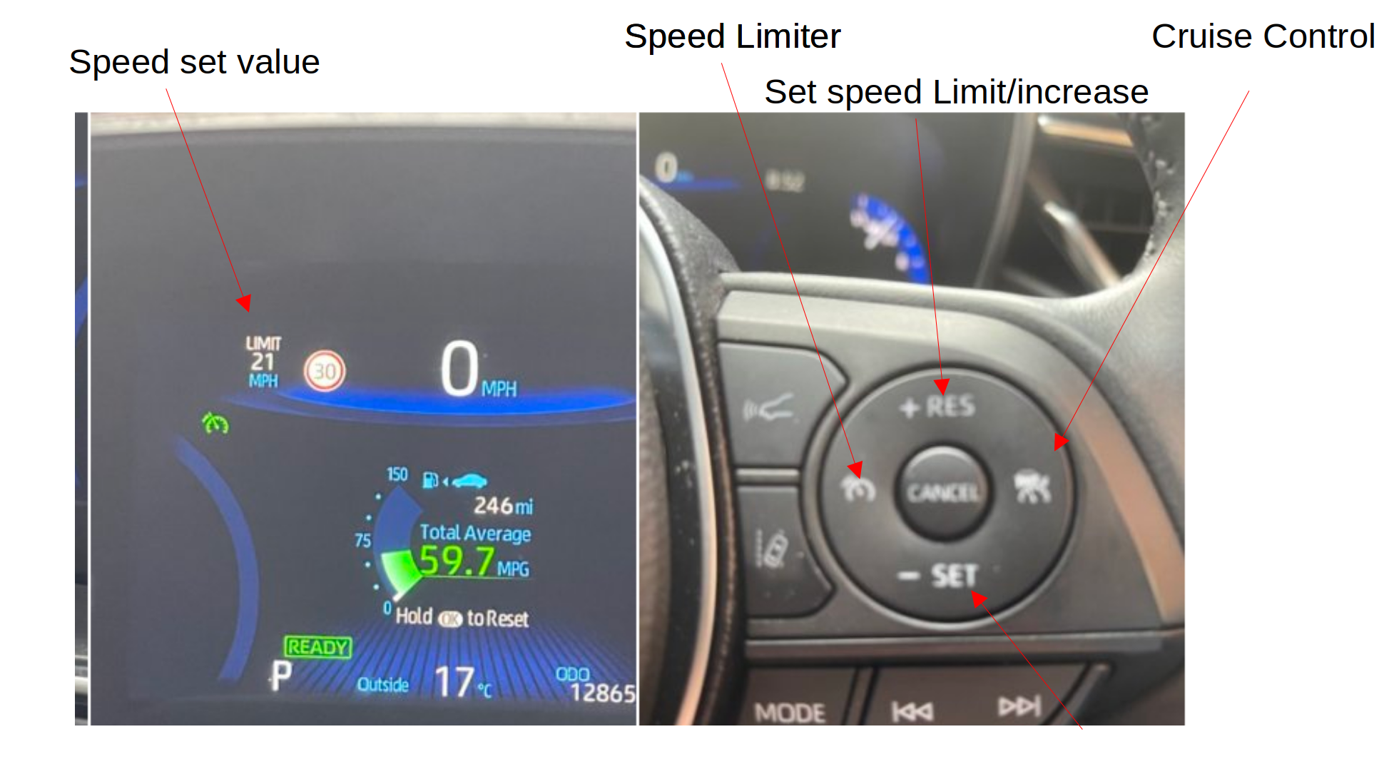

Thanks for the replies looks like no one is experiencing what I am. When its working its brilliant. If set at say 27mph then hit the plus in a 30 limit it goes to 30 then I can adjust it up and down +5 mph. However sometimes I lose the digits that show you what it is set at and they wont come back if you cancel etc If I turn the engine off its working again. Sometimes I get digits up that seem to be a speed limiter so the car doesn't move to the setting. I'm going to take it to the salesman next week just in case it is user error. Apart from this niggle very pleased with the car.
It sounds like you sometimes are activating the speed limiter (9 o'clock on right-hand selector) rather than cruise control (3 o'clock on right-hand selector). I rarely use the cruise control, but I am a great fan of the speed limiter. Once you have used a GPS device to work out the speedometer error, you can set the requisite limit and cruise past the queue behind the police car doing 67mph on the motorway.
Thanks yes speed limiter is one of the places I end up. Below shows it working as I expect. Trouble is at some point I seem to get out of this mode and then cannot get back there until I've restarted the car.
Well I went to the dealers this afternoon and it looks like user error🤭 it seems I was switching it off and on again. Once you have switched it on if it is cancelled by the cancel button or use of the break you just press set again. I cannot believe it as I thought I had tried all combinations. Hopefully it was user error and I can continue to enjoy the car which the dog likes very much as well!
