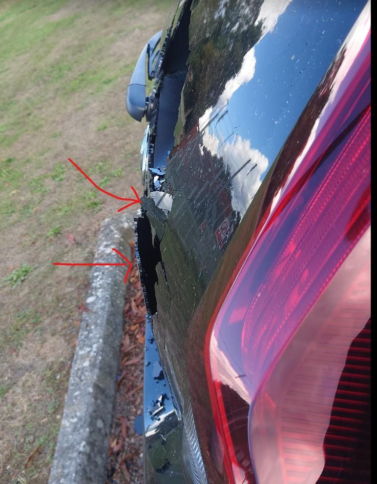

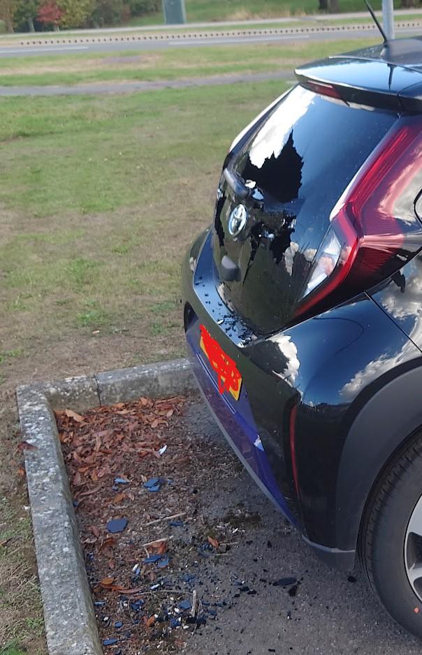

I was just wondering if any other Aygo X owners had experienced their rear windscreens rupturing?
I came back to my car to find the rear windscreen in the condition above.  Initially, I thought that the windscreen had been smashed/ vandalised by someone walking past.  However, on closer inspection, the vast majority of the glass appears to be on the floor away from the car, and a clear image of the glass remaining in place bowing outwards.  This suggests to me that the glass had been forced outwards, rather than being smashed inwards.
In addition, the boot cover (which as people will know is very flexible and only clipped in) showed no signs of damage or disturbance, as you might expect if someone was trying to have a nosy in the boot (regardless, my car was completely empty of all personal effects at the time).  The car was also parked in a secure location, away from the general public.
Unfortunately, the Toyota Warranty Team have concluded that this is NOT a warranty issue, as they haven't come across a similar issue before, and therefore I am liable for the cost of replacement.
I am therefore curious to know if anyone else has experienced something similar and assumed it was vandalism, or if I really am just unlucky.
Many thanks

Yes - the glass around the handle also blew out.
Even the top corners of the windscreen were damaged, a significant distance away from the main hole.
I have more photos, which is just as well as they have had my car for over 2 weeks now!

I’ve seen rear screens break from the heated screen being left on, but being parked and locked up, this cannot be the case.
I found a video of glass being smashed in curiosity of which way the glass goes at the point of smashing.
The tempered chopping board was interesting because it blew outwards at the point of smashing.
I think it is going to be impossible to be 100% sure how it happened. It could of been a defect in the glass, or the area around the wiper motor defective or somehow clamped too tightly?
Out of interest was the rear screen facing South into the Sun? Heat expansion could of played a part. A lot to think about, but ultimately almost unsolvable, let’s hope it’s just a rogue occurrence, rather than a looming issue for early Aygo X’s !
Remember when the C-HR originally launched there was a issues with windscreens unexpectedly cracking which Toyota cured.
Wonder if this is the start to reports of a load of Aygo X rear windows shattering? 🤔

To me look like something/someone has smashed it. Usually any car window when broken explodes outward because of the difference in the air pressure between car interior and outside. This is also the reason why many if not all cars with frameless doors has automatically lowering the side windows when closing the doors. If the door handle or any other part is missing then this explains everything. Best to speak with insurance what should be your next steps. If you have no claim bonus protection the next year premium should not be much more expensive, just a bit on top.

I'm sure that he will look for burrs or imperfections on any glass-attached features; ones that could cause stress-raising points in the glass.
Whilst my opinion carries no weight, I'm inclined to think the glass was mis-handled and has suffered a 'serious' scratch during manufacture - this shattering was just waiting to occur.

The 2 images above in the OP give me little idea. I lost my rear window from a stone thrown by my lawn mower.  It shattered like the glass in the video.  The stone did not penetrate.
I have seen another where a strimmer fired a stone through the window and it landed on the back seat.  The glass shattered but apart from the hole it remained intact.
The pictures above are not clear.
