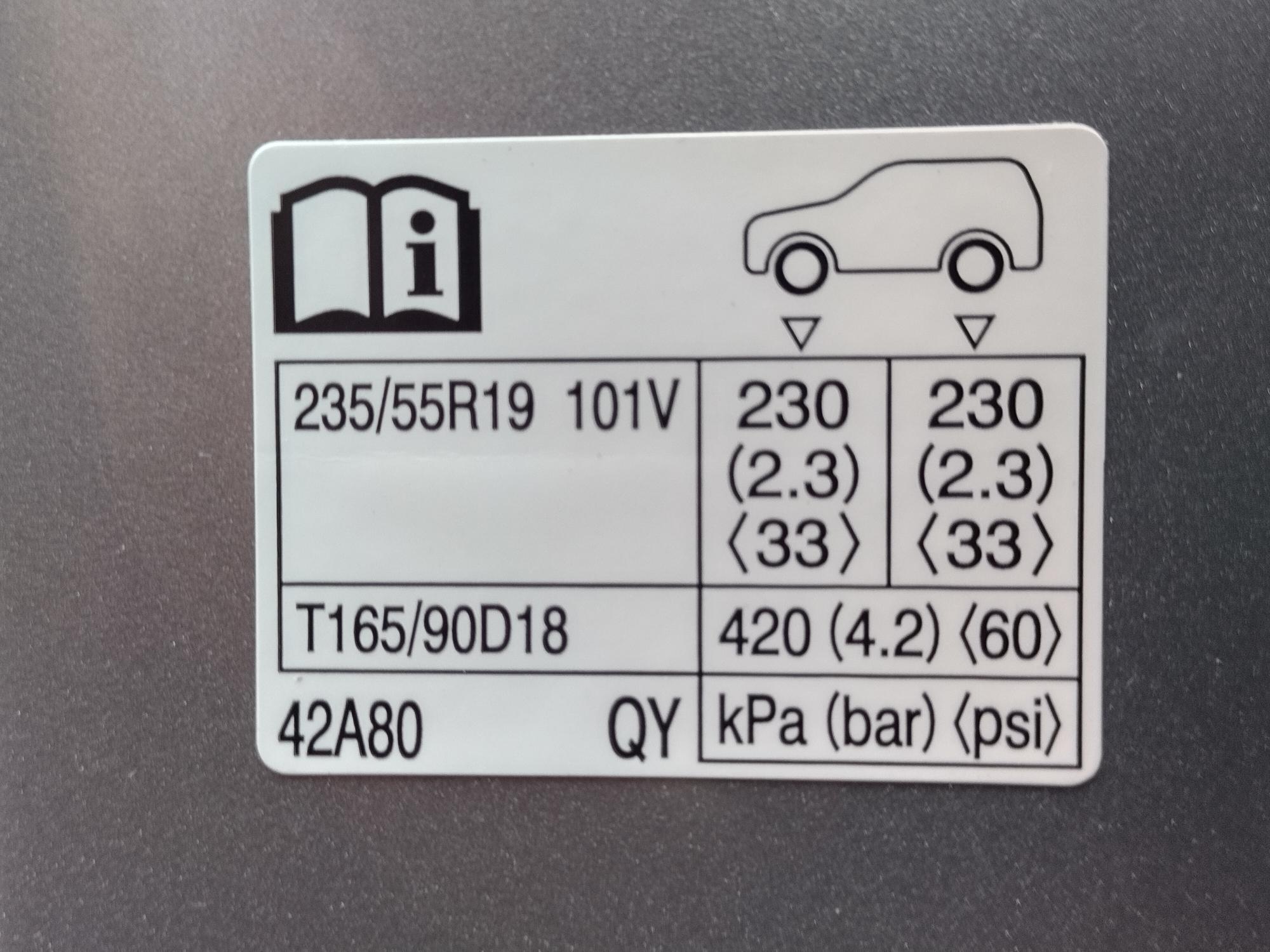

22My HEV Dynamic with 19 inch alloys comes with an 18 inch space saver.

Yes I'm sure it's UK spec, there was a change from MY2021 to MY2022.

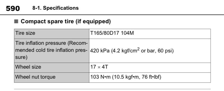

The manual states T165/80D17 104M on a 17 x 4T alloy wheel  for all wheel  /  tyre combinations.
