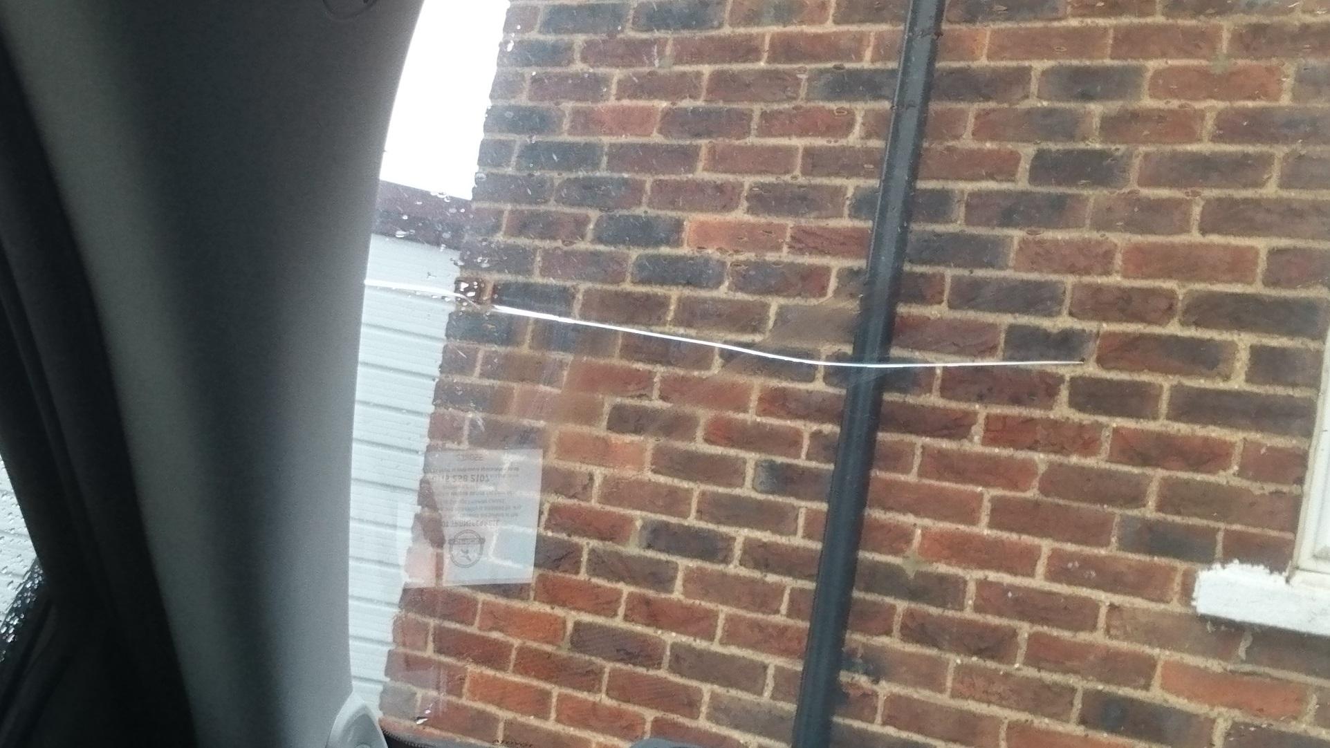

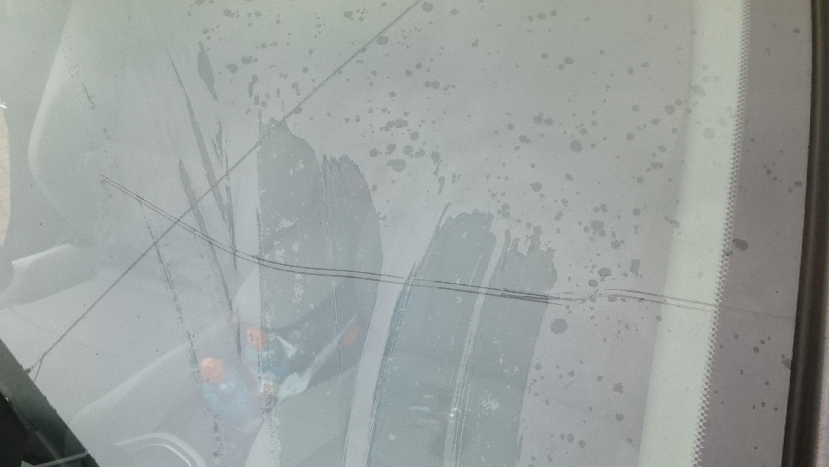

So apparently this is Bad Luck Month for me - Noticed my windscreen has a massive crack on the passenger side; It wasn't there when I left work yesterday so must have happened on the way home while it was dark!
Normally this wouldn't be too big a thing since insurance covers windscreens, but this is the first time I've had a car with all these sensors attached to the screen - Has anyone had their windscreen replaced on a newer vehicle before? Does whoever replaces the windscreen need to re-calibrate the sensors? If so, do they do it or do I need to get Toyota to do it, and how do I arrange this as part of the replacement so I don't end up getting charged for it??
I'll need to make sure they get the right one for a HUD-equipped car too...!

Sorry to hear that happened to you too.
It’s simply unavoidable thing with the amount of salt and grits on the roads already. A stone has hit your windscreen perhaps you didn’t noticed and after the car been left parked for a while the screen changes it’s temperature and cracks has developed, it has happened  to me two times within few years on two different cars. Thanks to transport ministry for been very good to organise salt on the roads and to majorly of drivers who overtake and immediately cut in front of me, great. Even my recent screen has already two nasty dots from a fiesta driver.
The autoglass will take care of everything, you just need to double check and perhaps tell the technician before he start the replacement to be sure that windscreen seats flush or lower with the roof line. When all is set drive the car and listen for extra noises inside the cabin, wind blowing too. Hopefully they will sorted correctly first time. 👍

The crack on this is a really weird one; I've had stone chips before that took a chunk out of the glass but could be repaired, but never had one that caused a crack like this; There's a tiny chip where a very small stone might have impacted the glass, but it's so small I can't imagine it would have caused a crack like this, given I've seen much bigger impacts that just chipped the glass but didn't cause a crack to form.
It's all just a bit odd, as previously I'd noticed a lot of GR4 owners having cracked windscreens, and in a lot of cases they apparently just suddenly formed without any obvious impacts, starting from the edge of the glass and working its way in, and this seems very similar in its MO to what's happened with mine! One post speculated the windscreen was part of the increased structural rigidity in the TNGA-B platform and was under a lot more stress than a normal windscreen, which might be why they were more prone to cracking.

Exactly same crack and place as per my car 🫢
Best to make some pictures before you take the car for screen replacement and some after the new screen. Also make a note for road and particularly wind noises and regenerative braking noise levels inside the cabin with the oem glass and afterwards. The sensors and calibration should not concern you as much because if they don’t do it correctly it will trigger warning messages but not properly fit windscreen may cause wind blow and a lots of noises plus moisture introduced inside the cabin, something that you definitely don’t want. 👍
