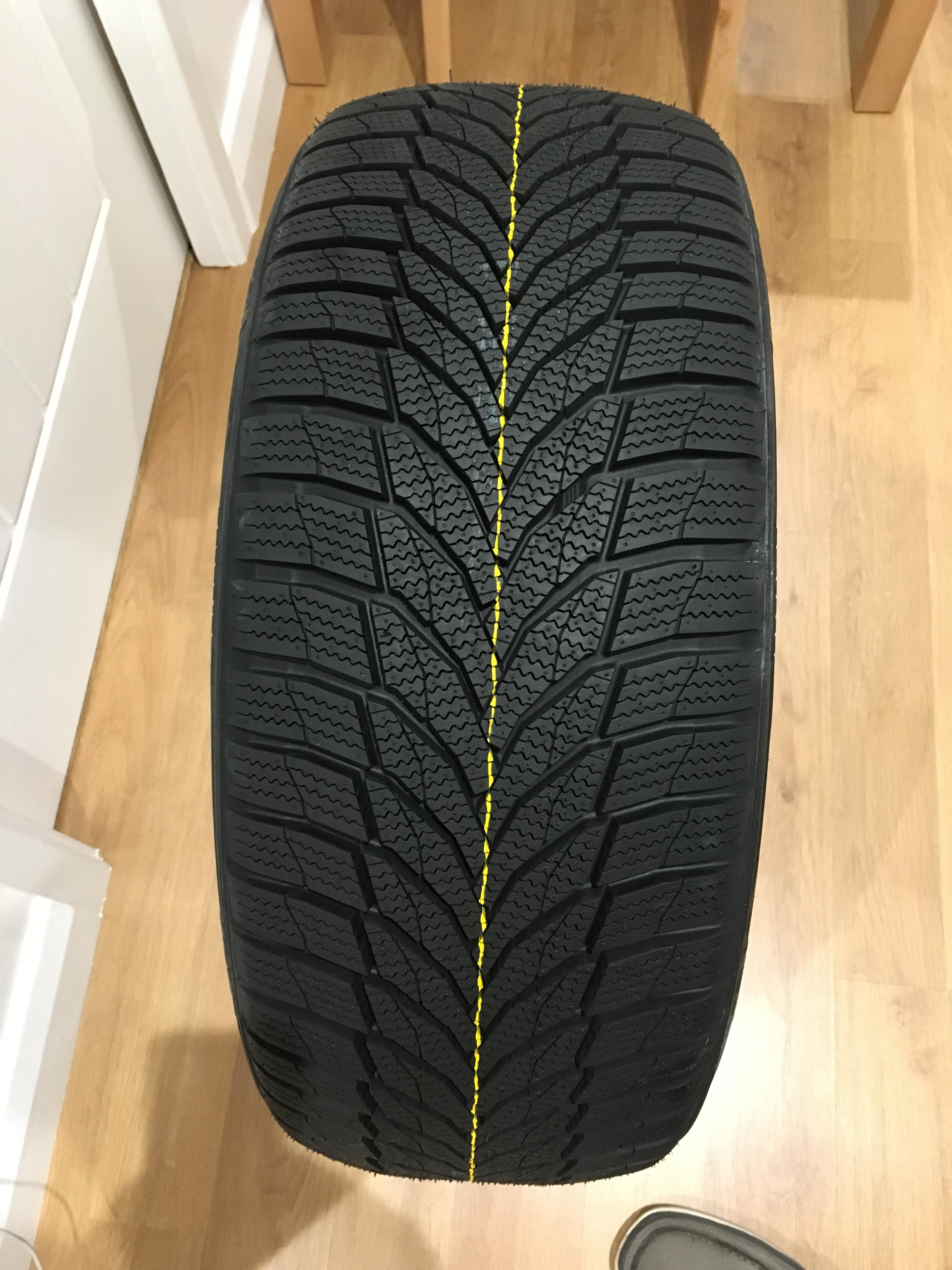

These were very good on snow and ice, also ultra quiet, sadly couldn’t last more than 4 seasons thanks to the salty roads. Tread depth 4-5mm but huge cracks formed. Not safe to drive anymore. Btw the mud and off road tyres are not good at snow and ice at all,  they are almost as bad as summer tyres.
