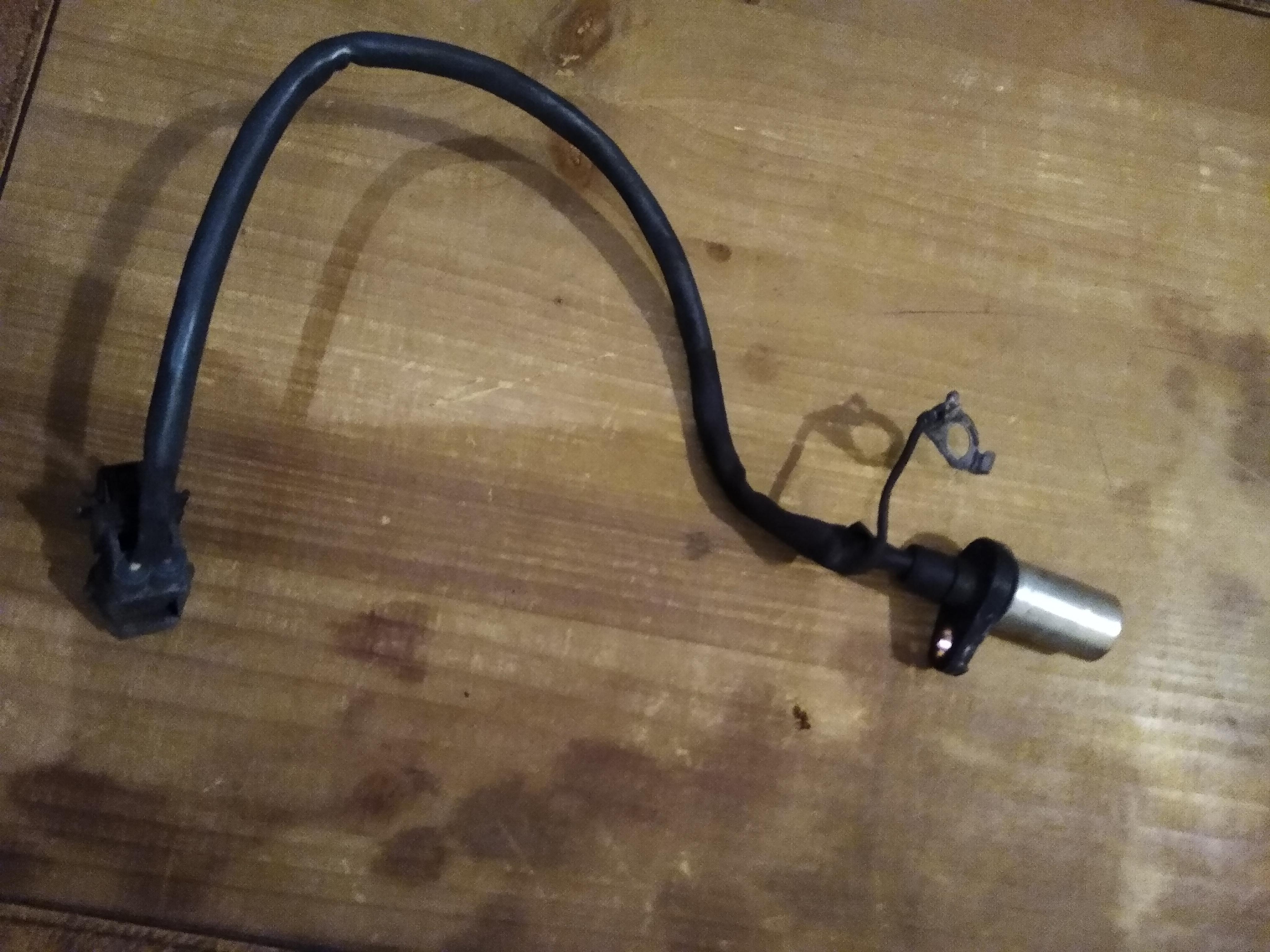

Hi, I'm struggling with buying a replacement crank sensor for my 1999/2000 Toyota Corolla (Petrol FWD -- _E11_1332cc 63KW 86HP 4E-FE) and am hoping someone may be able to advise me on finding the right part. On eBay using the 'My Garage' filter it initially brings up plenty of options but then when clicking through it mostly tells me it isn't compatible after all (a lot seem to be for models/engines ending in '4ZZ-FE' rather than 4E-FE). To be honest I'm not convinced the eBay My Garage filter accurately captures the particular (sub)model of my car.
The part number of the sensor removed from my car is 90919-05019, and this only seems to be available without the cable attached (e.g.: this one), and I need the cable.
The link above (without cable) says it's for a Toyota Paseo, but it's the same part number (it actually appears to be for a Cam Sensor rather than Crank Sensor, but I think these must be interchangeable, in this case at least - please correct me if I'm wrong on that!). I'm confused about how specific the compatibility needs to be and what features I definitely need to ensure are correct before buying, and which elements I don't need to worry about. There are plenty on eBay (example - this is one for 4ZZ-FE) that look just like the one taken from my car (although I've just started to notice that the metal cylinder on mine might be slightly thinner/more elongated than the ones pictured on Ebay etc. - I have attached the image of my old one in case this helps)

Hi,
Would first use one of these free sites along with your Vin number to confirm the part number and if its been superceded, plus it might also show a separate part number for the cable.
toyota.7zap.com, megazip, toyodiy and Toyota.epc-data
i will look it up on the epc shortly
90919-05019 comes back as a Tercel or paseo part
I think you may have misread the part number 9 and 8 can look a like, when worn
90919-05018
hope this helps, PS take eBay compatibility charts with a pinch of salt
90919-05018
https://www.megazip.net/zapchasti-dlya-avtomobilej/toyota/corolla-38234/ee111-54077/ee111r-dlhnkw-921636/engine-oil-pump-17876346?nid=3891508#g17876346/engine-oil-pump/il-413967978-3891508-3891508
You're absolutely right, thank you so much for checking this!
With this correct part number much of the doubt has gone - I still can't find one in the UK but found one for a good price from China, so will just have to wait a bit longer for it.
(ps 'oldcodger': it seems this part number includes the cable)
i would avoid the cheap Chinese ones - unless you want to be back at square one in 3-6 months i would phone around and get something in the uk
4e and 3/4zz have very different types of sensors, the 4E type is piezoelectric that generates its own power/signal the 3/4zz type are powered and send a PWM signal back to the ecu
