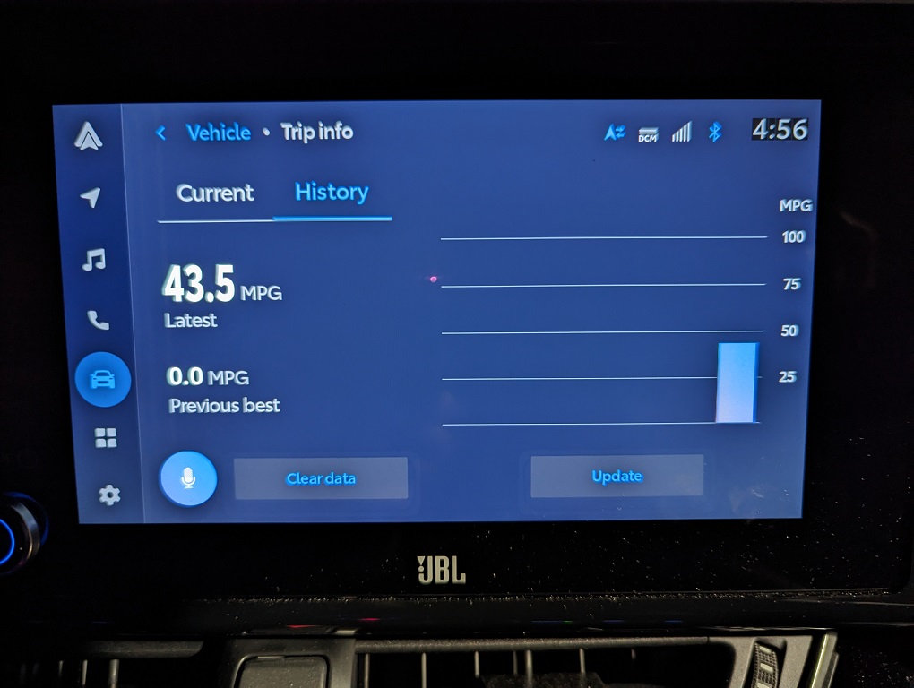

Sorry for going off topic, but is that the JBL system in your TS?
It's a C-HR ( Corolla in disguise )
