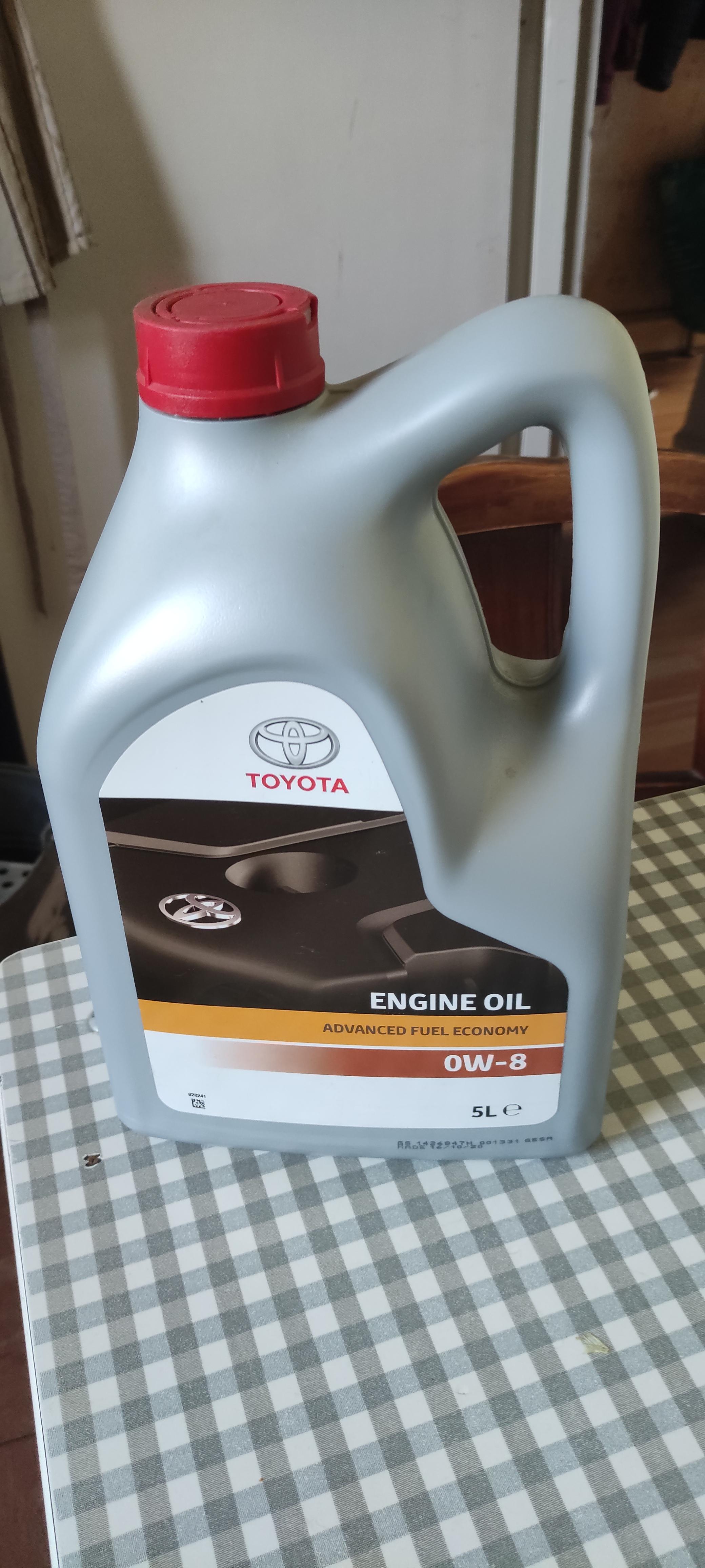

Got this to put a litre in the boot for my future MK4.

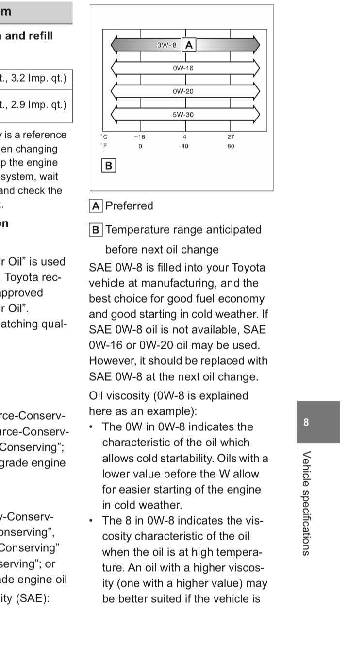

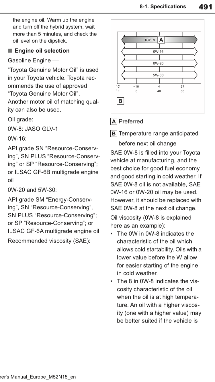

4 minutes ago, anchorman said:
Straight from the Yaris manual….
Yes Don, that’s exactly what in my users guide book, and I quoted that passage to the dealership as well, so if Cyker is reading this post, it might not be just down to my undoubted charm and charismatic tongue 🤣😂.
