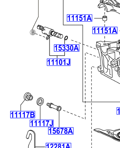

A Blocked or faulty VVTi controller can cause these issues, so can too thick an engine oil, a 2007 needs a good quality 5w30 oil meeting API SL specification or higher.
As you look at the engine on the rear left of the cylinder head is the VVTi controller (11101J in picture) below this behind a small plug (11117B on picture) is a small oil filter (15678A on picture) in normal operation this should never need attention but too thick an oil or extended oil changes can clog this up, make sure it is clean and if the oil could be at question an engine oil flush and oil and filter change should be completed.
The VVTi controller can also be active tested to ensure correct operation using a quality diagnostic machine

OCV oil control valve issue don't always throw a fault code, I would also pull the OCV filter - inspect and clean/replace
Thank you for your answer.
I will drive the car for another oil and sparks change, ill ask for quality 5w30 oil meeting API SL specification and Denso sparkplugs, and ask mechanic to also inspect
throttle pedal sensor
OCV oil control valve and OCV filter
VVTi controller

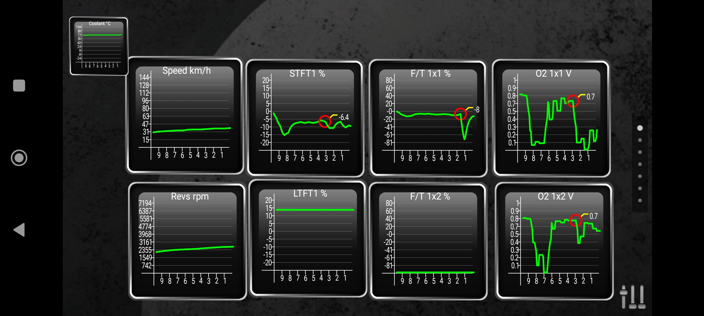

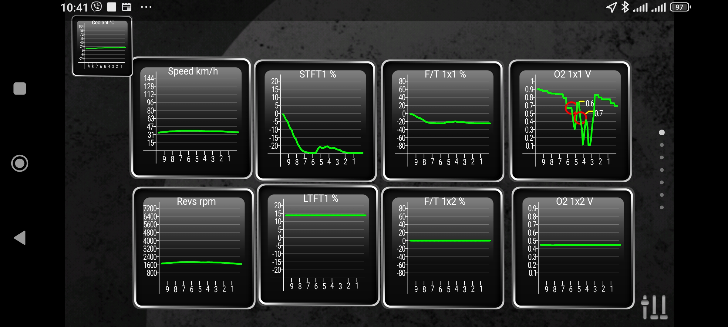

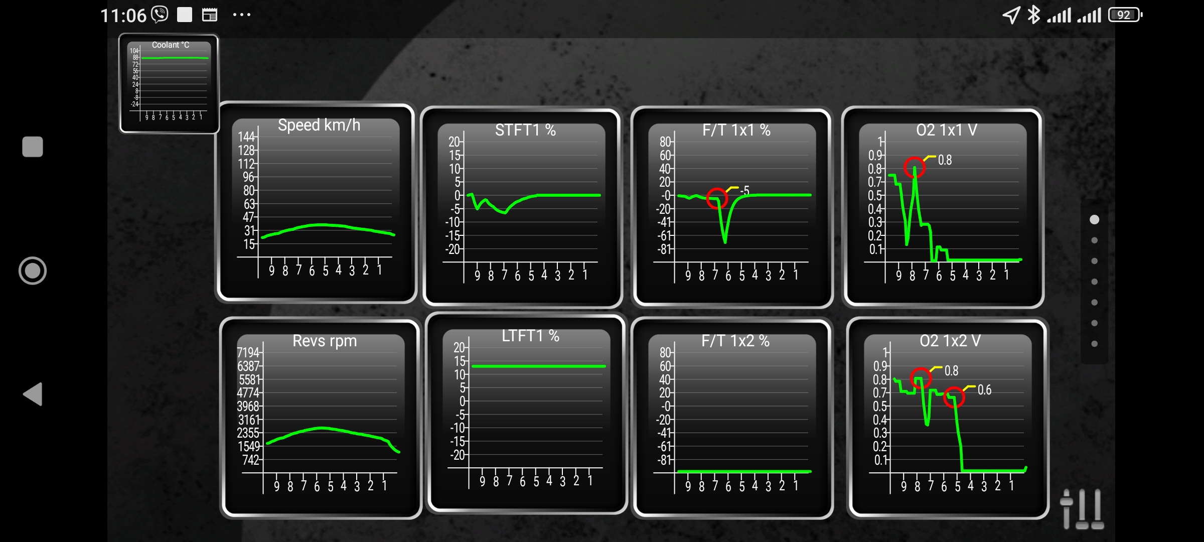

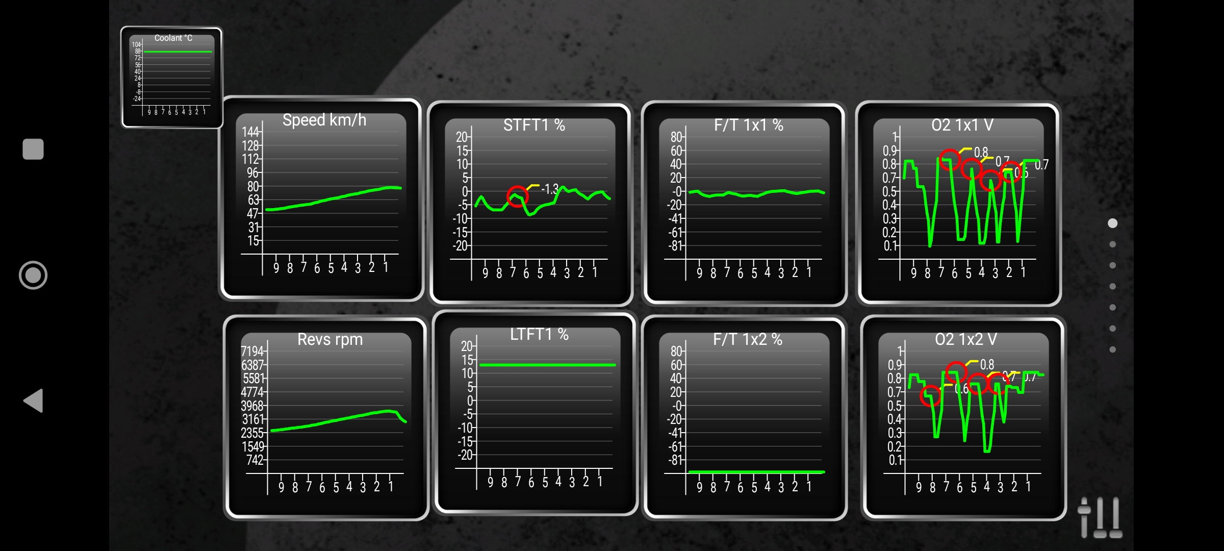

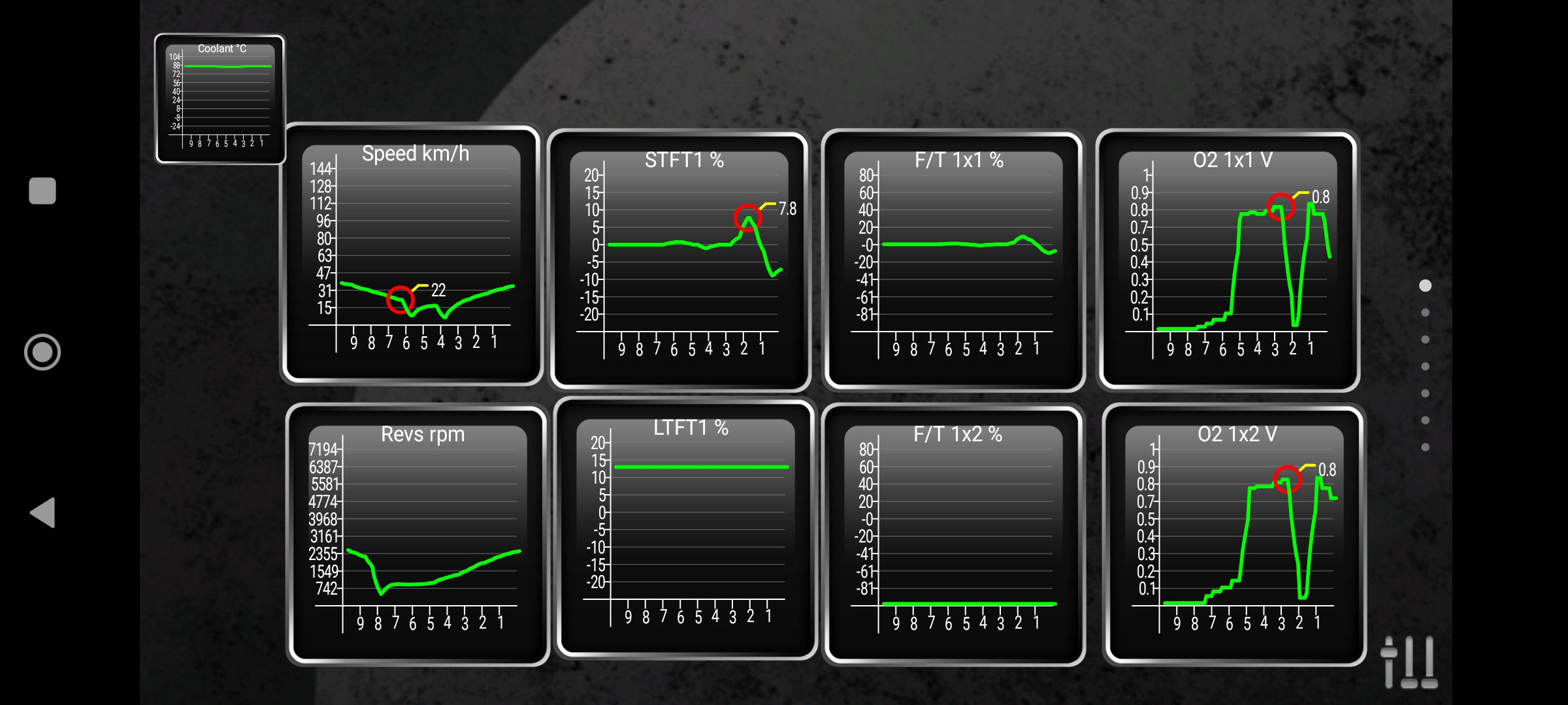

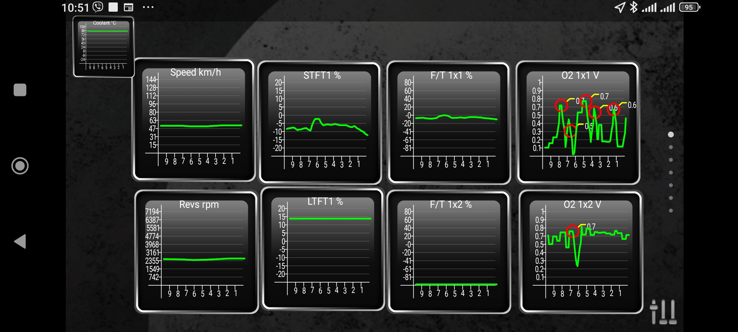

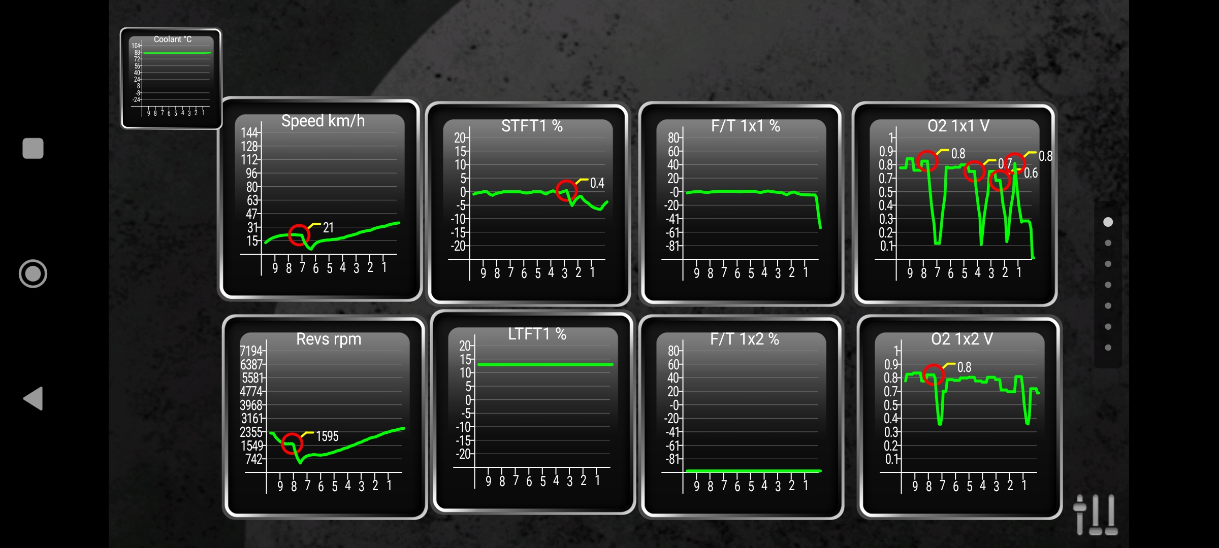

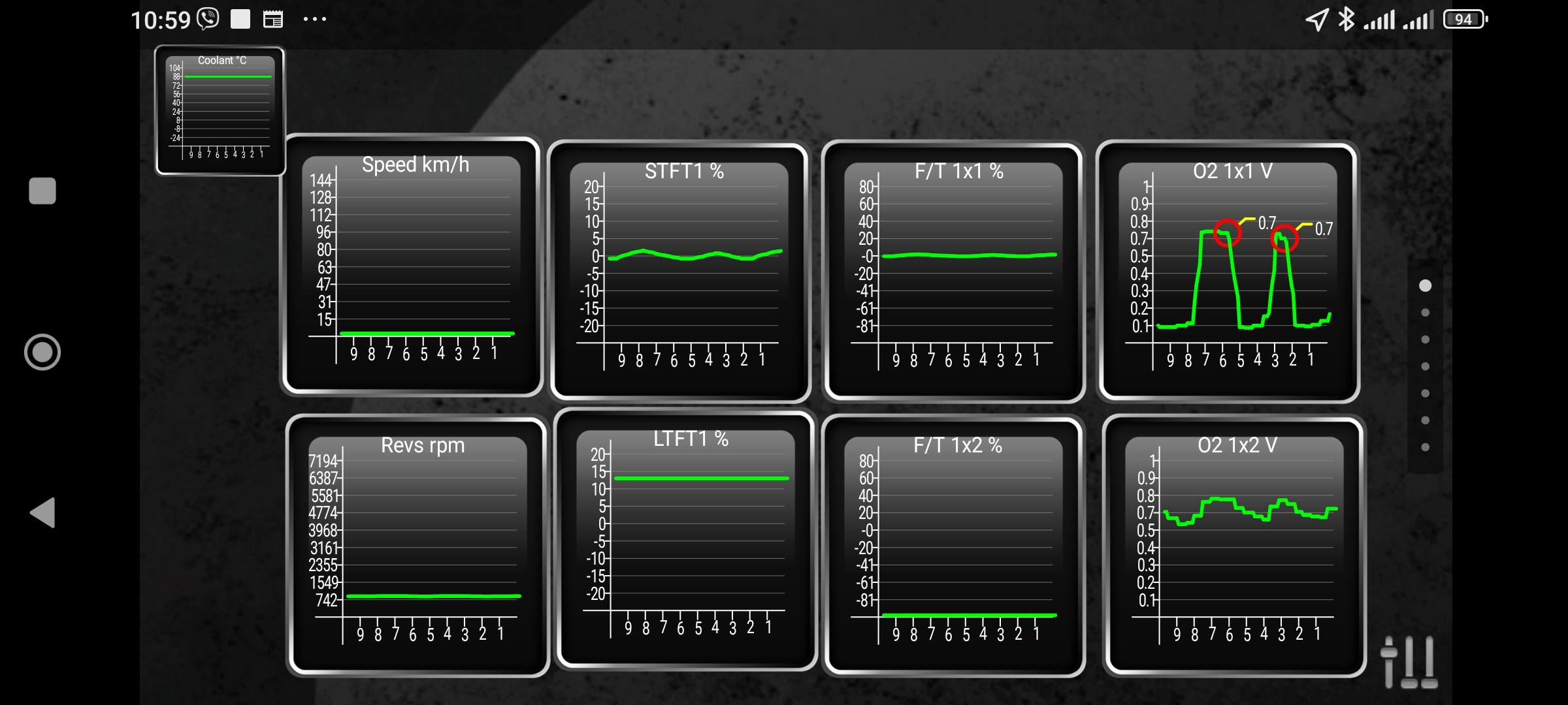

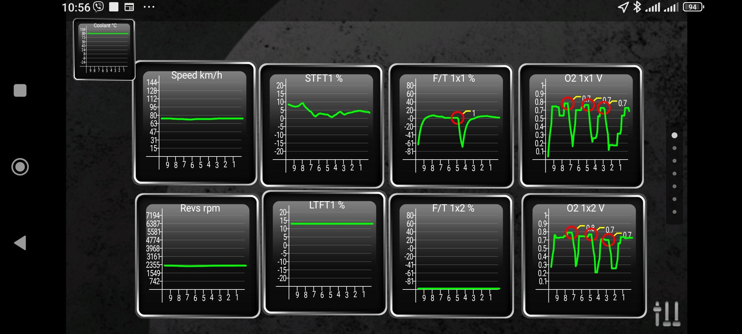

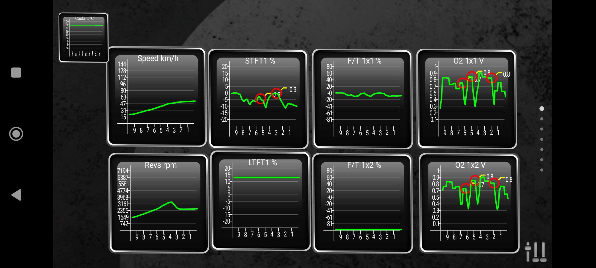

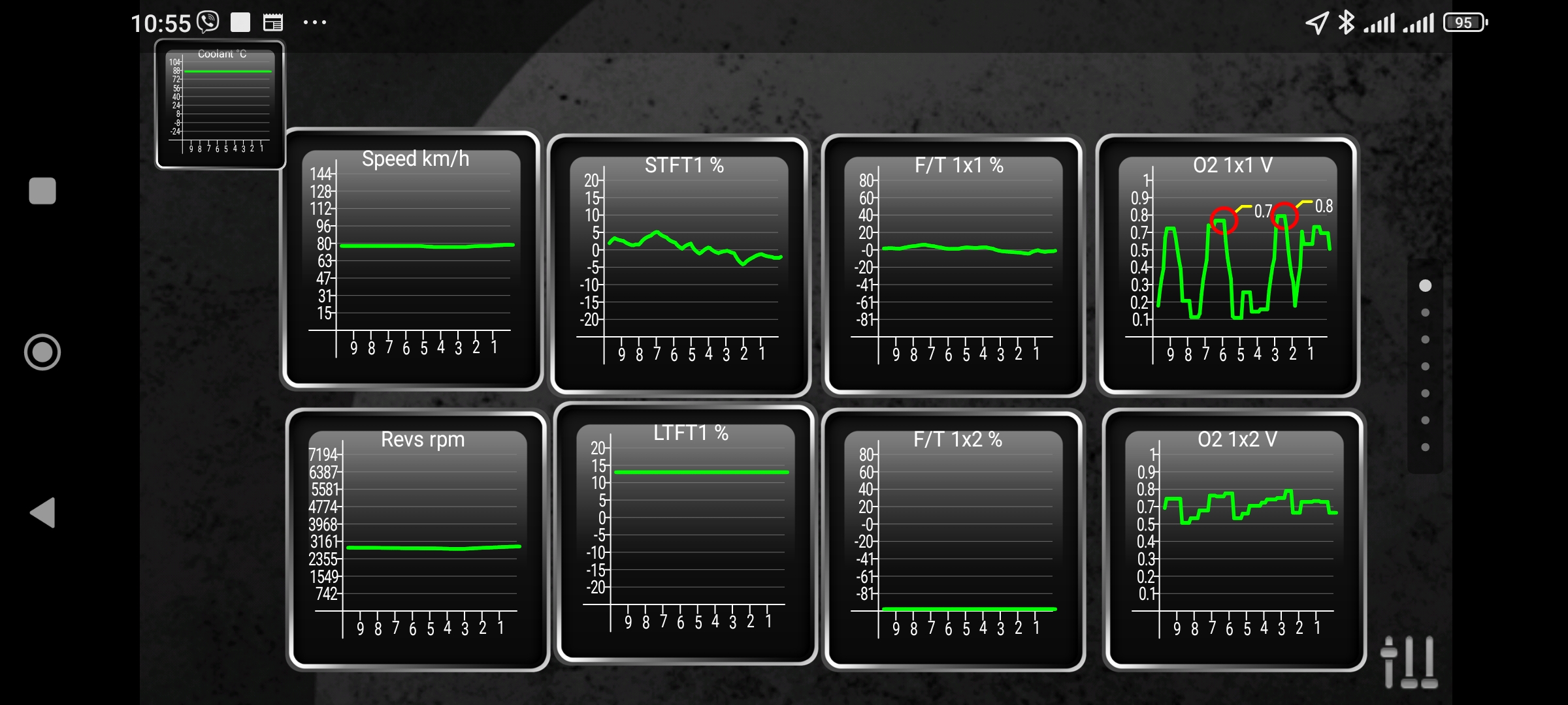

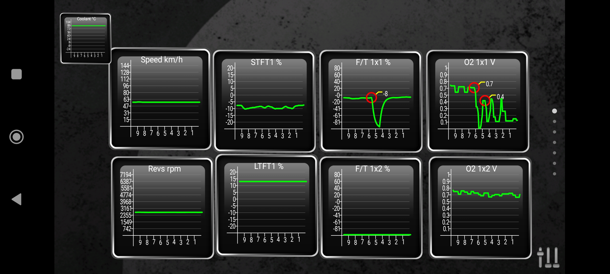

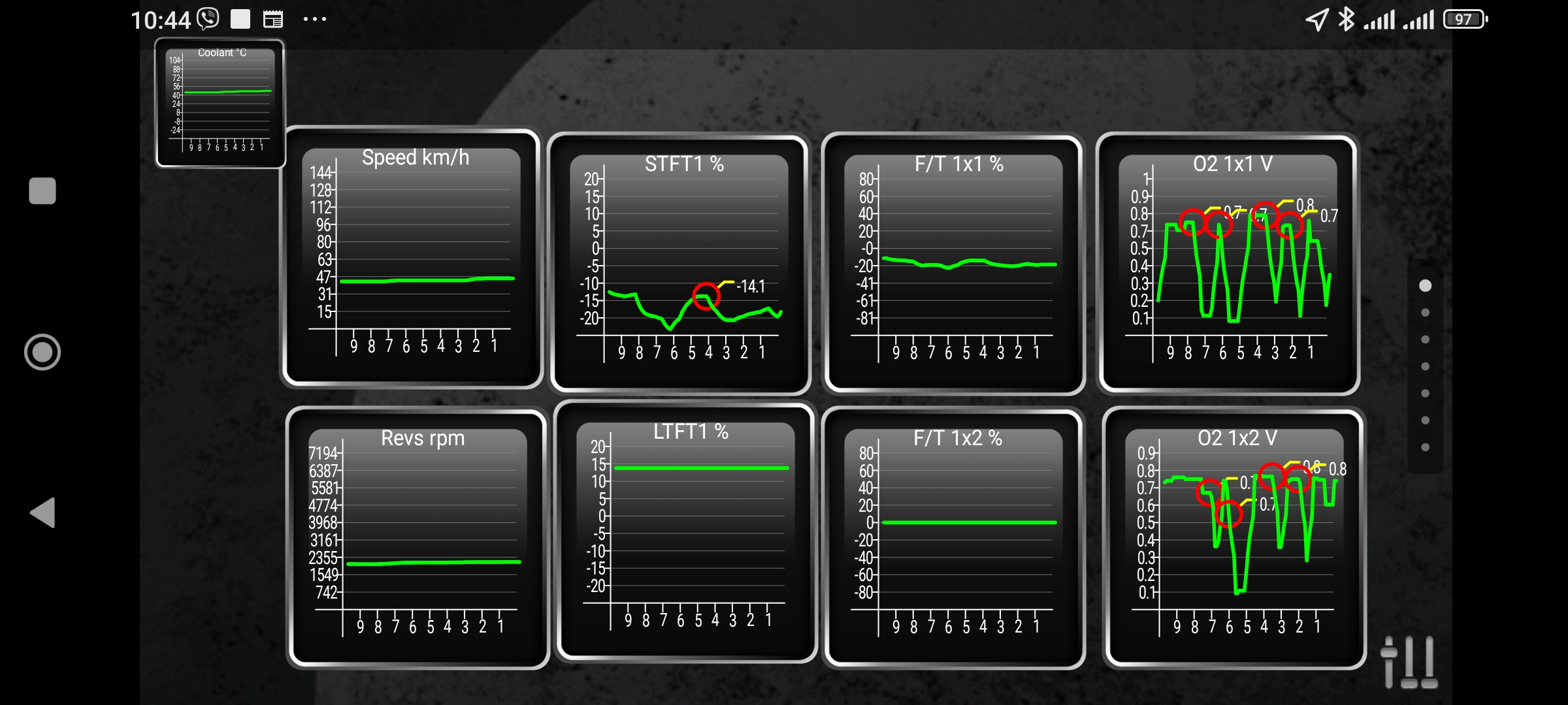

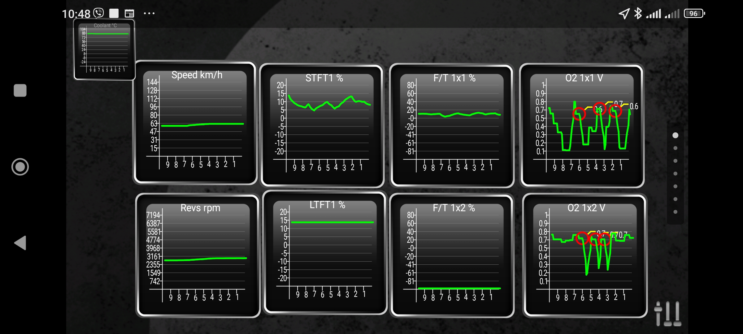

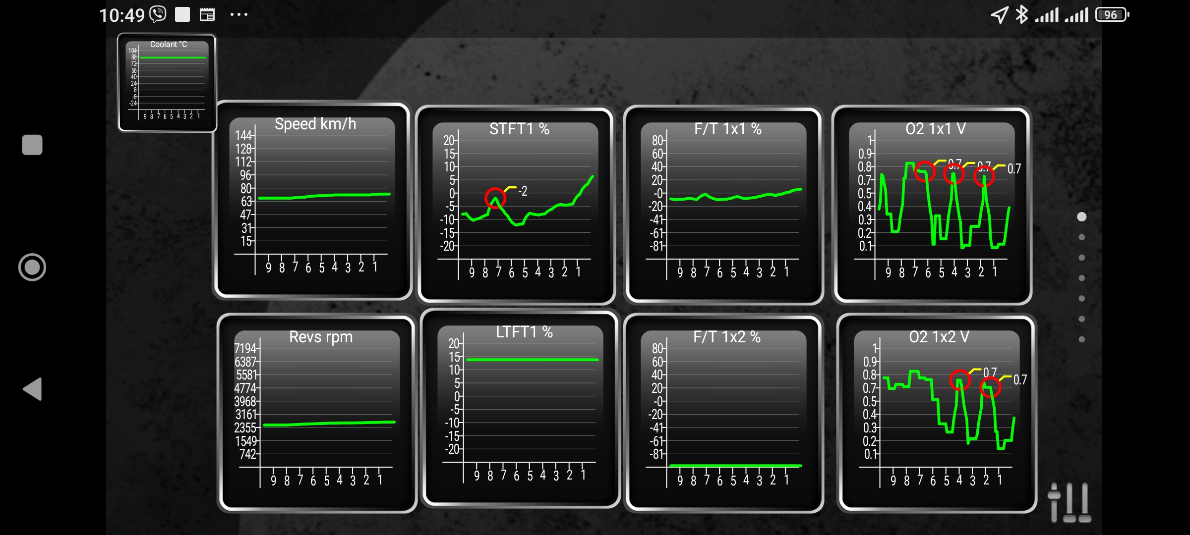

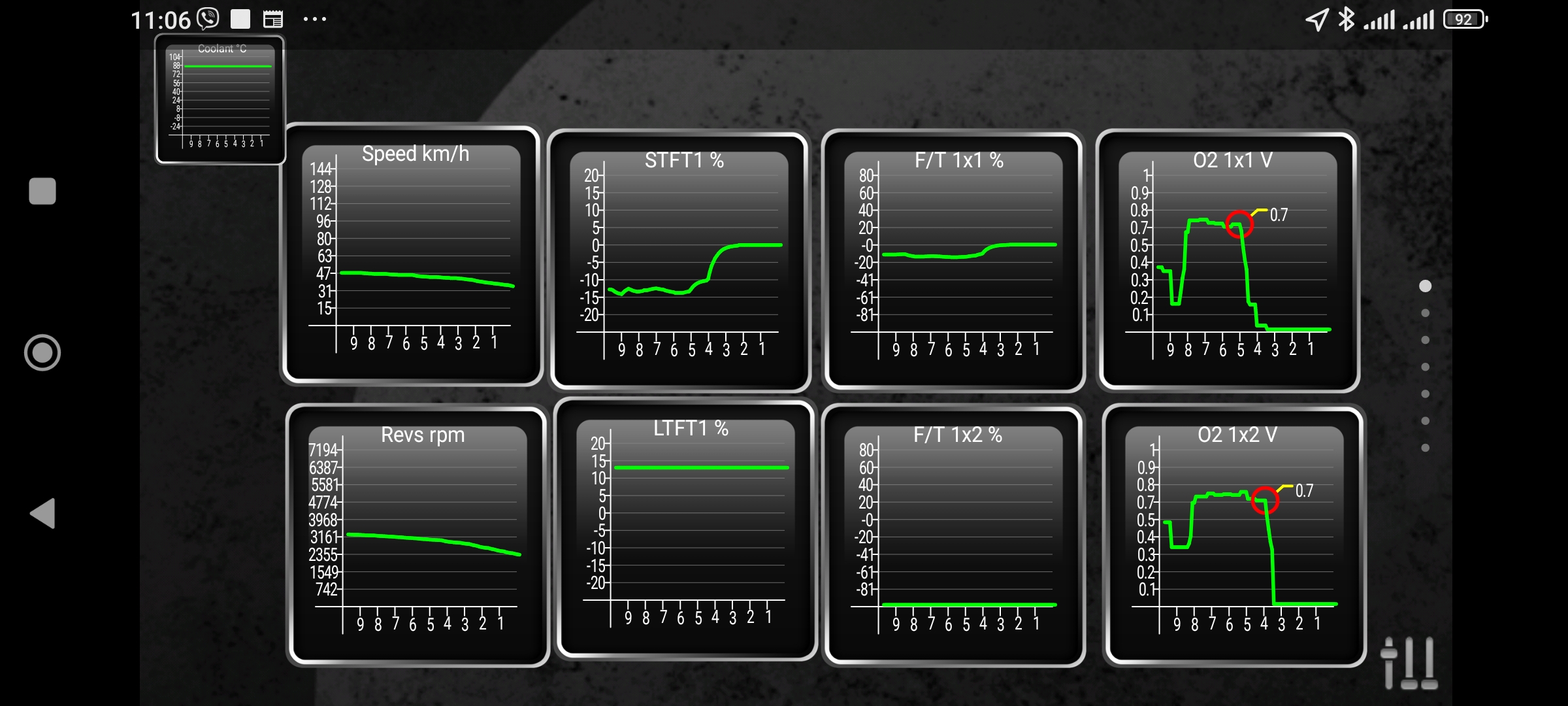

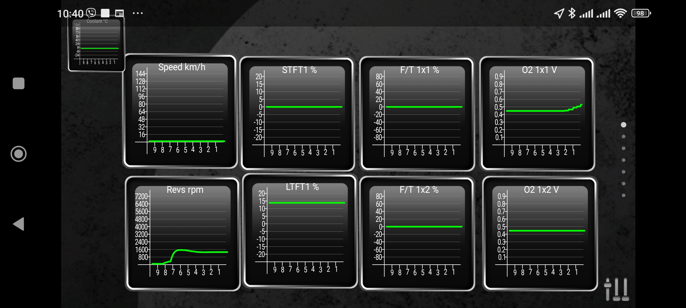

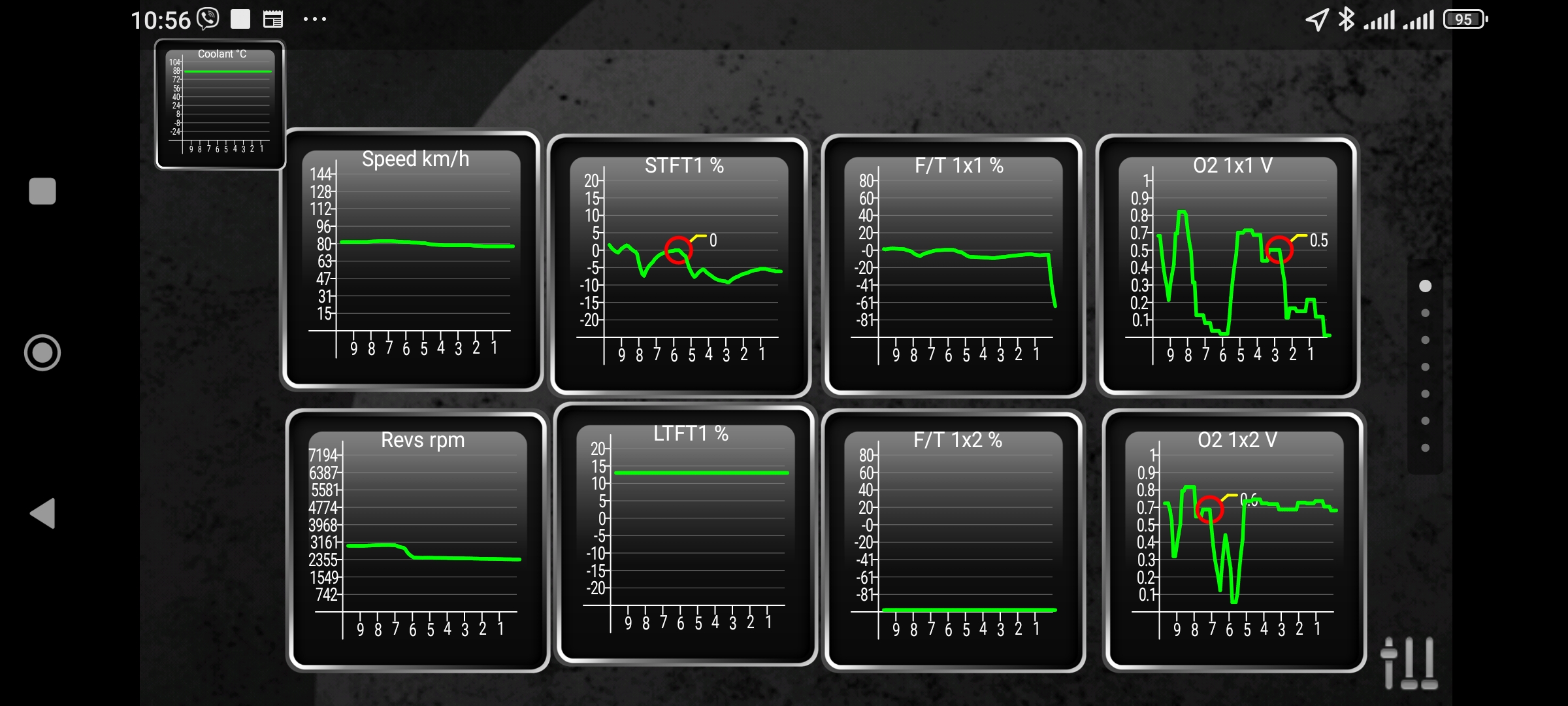

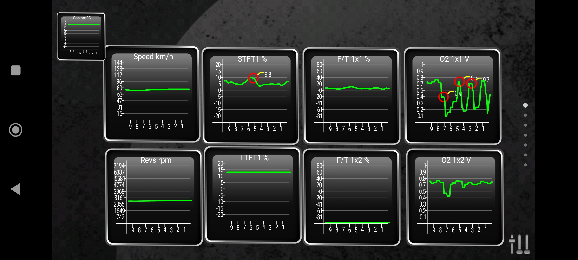

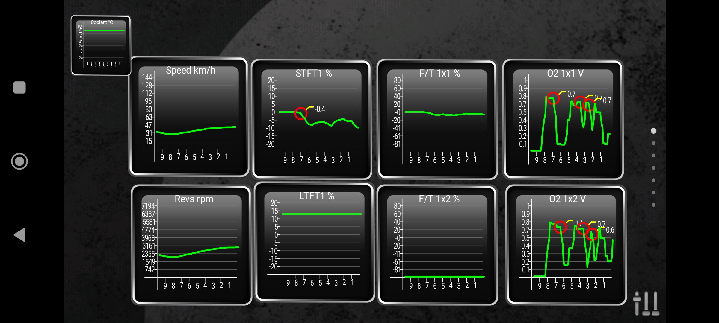

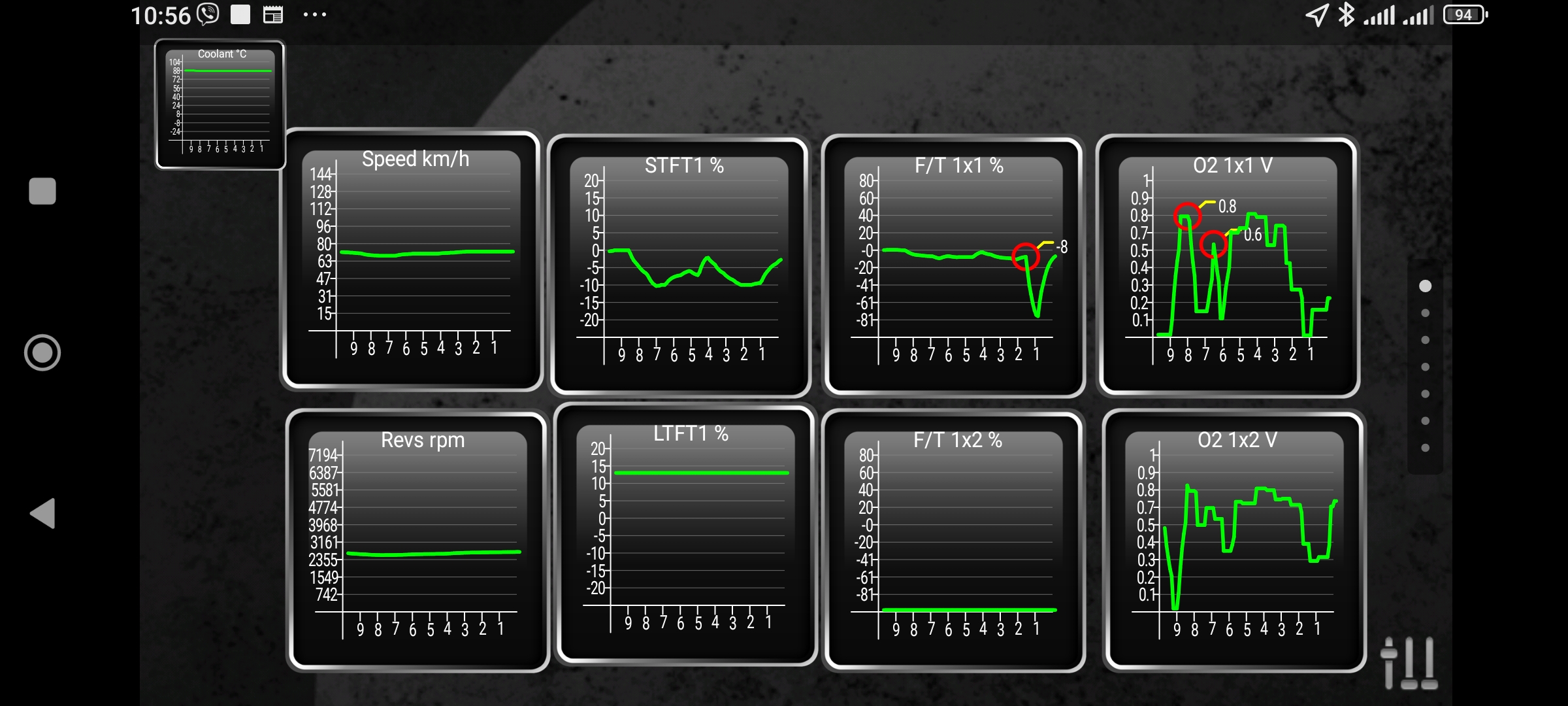

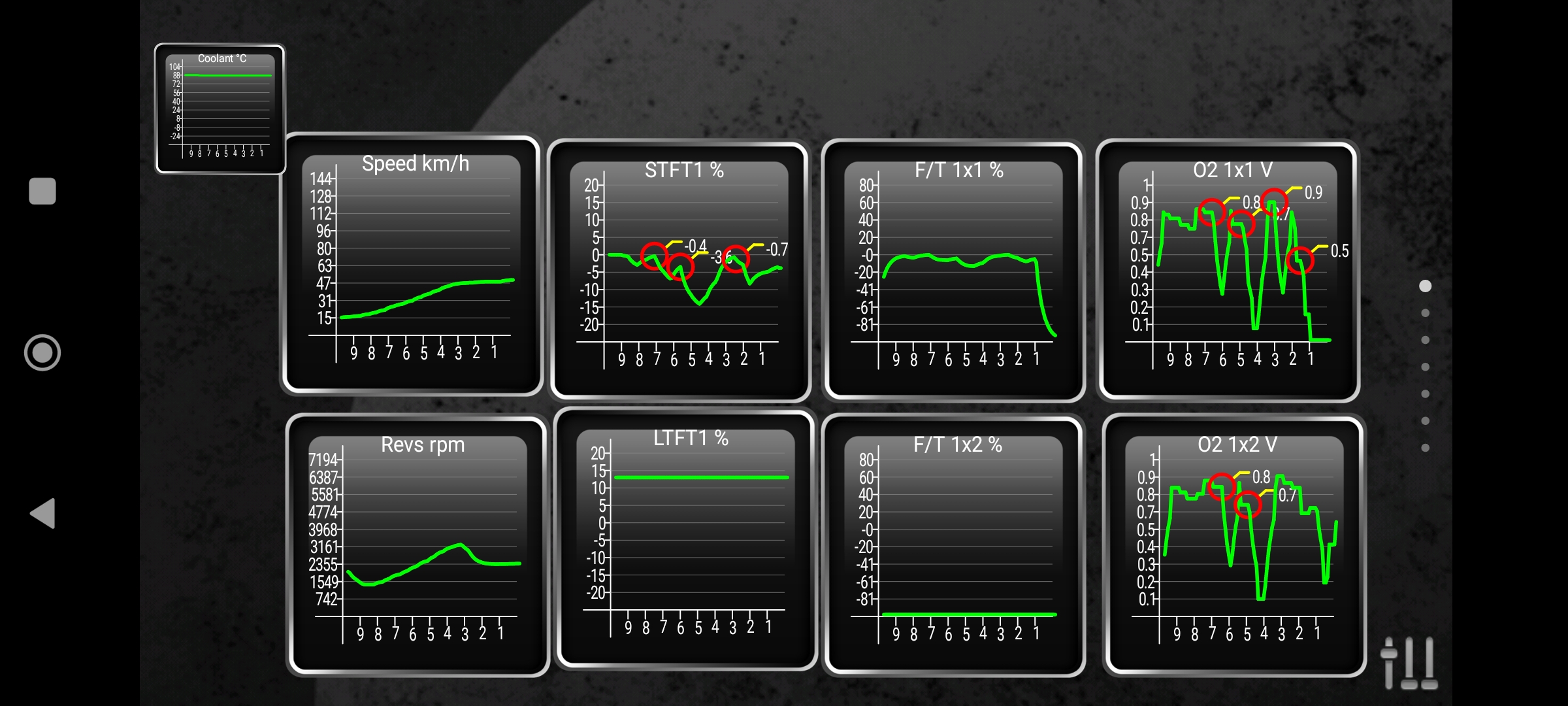

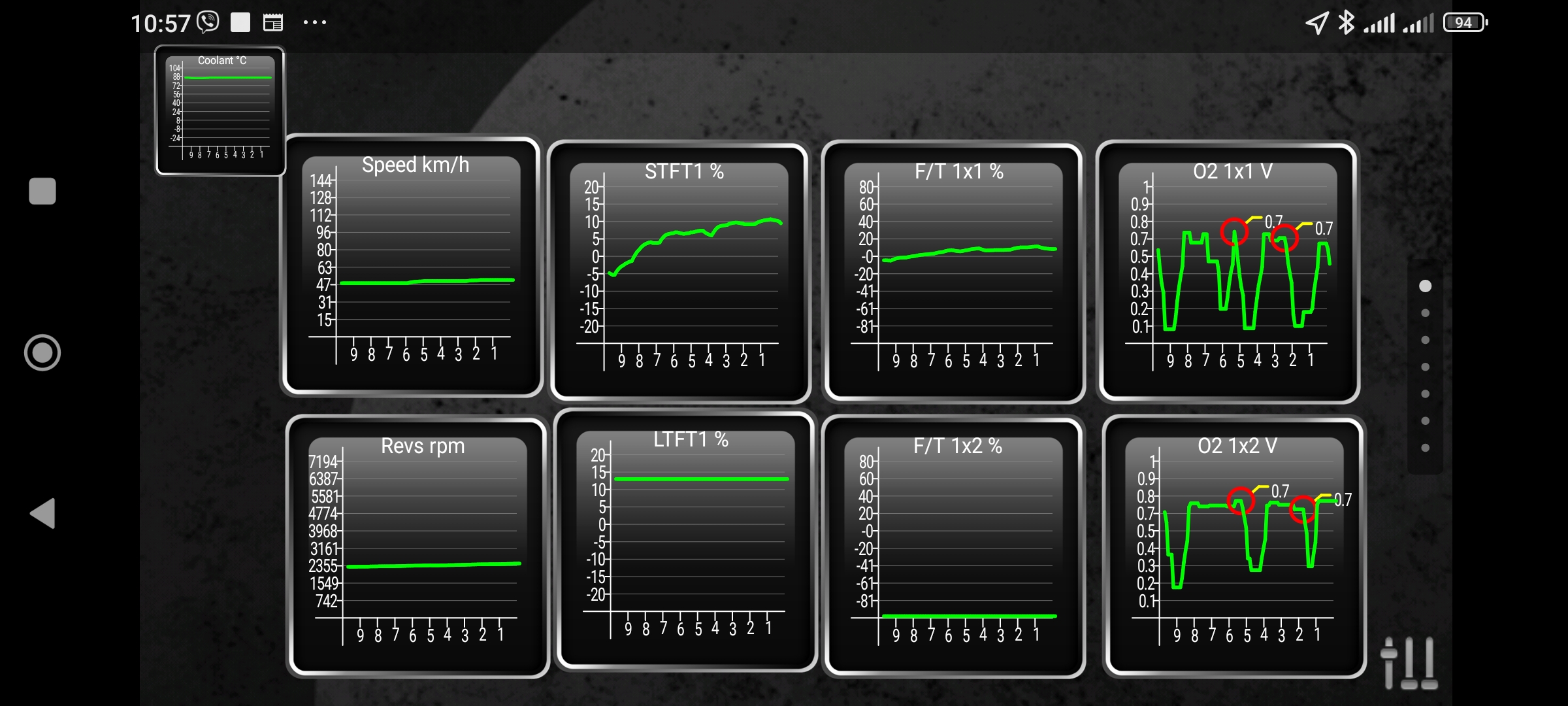

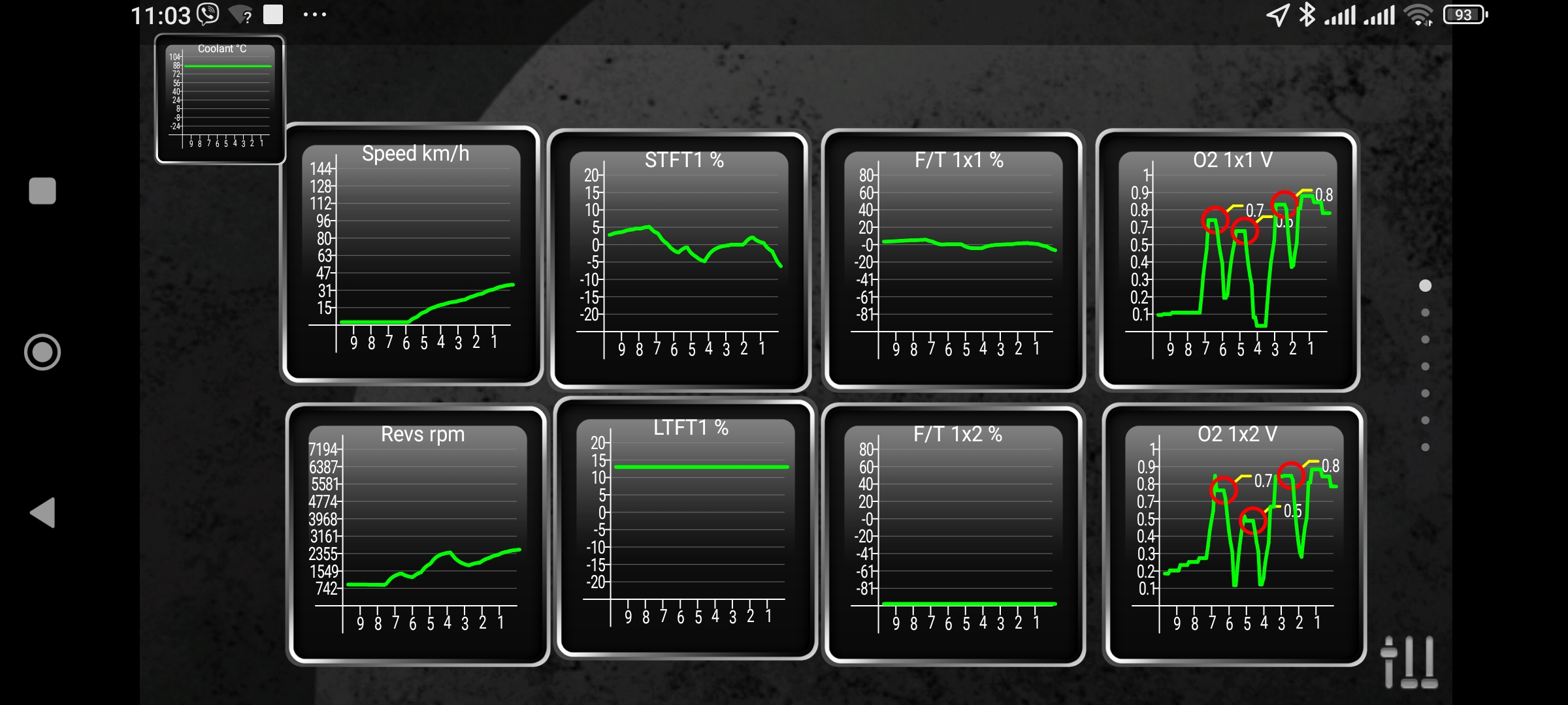

I have replaced thermostat, without any change with my problem. I also did professional Wynn's fuel system service (by mechanic using wynns machine). After treatmant i notice some improvement, but i still feel power losses (right after treatmant very slight, but gaining in intensiti how the time passes). I took the car for the half hour drive, measuring the data with torque app and taking screenshots. Since today is cold here (aroun 4 C) i felt only few gentle loss of power in last few mins of the drive. Only strange thing that i notice is LTFT which is constantly on +15. If anyone can see something else in the posted data, please let me know.
B1S2 o2 sensor post cat, it's within the voltage specs but is acting strange
what is your map reading ?
reset your fuel trims
if you replace the sensor, replace it with a Denso item - DOX-2066
Contaminated fuel maybe another problem drain the tank and put some premium fuel in it
Thank you again for looking at bunch of screenshots. I presume tha MAP reading in torque app i Intake manifolld pressure, values are 4.2 - 4.4 psi on idle engine, jumps up to 14 psi when pressing accelerator pedal.
I doubt it is fuel contamination, i have the problem for 9 months now, usually i pour 28-30 litres in my gass tank and always fill it full, in this period i did it more than 10 times.
I will reset fuel trims now and see what will happen in the future.
I will also clean O2 aftercat, it reading remain similar  I will replace it.
