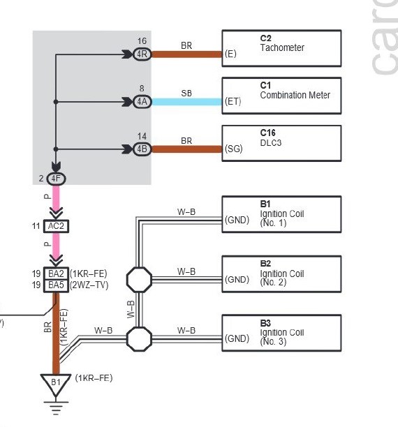

Can you here the fuel pump prime ? Try to start the car with a spare key, if you have changed the Battery in the fob or changed the case make sure the chip is in its location, Scan the car for codes
If you have a B2799 code, check the ground point B1 this is located on the top front right of the engine under the air filter/intake
picture courtesy of Markie
B493BB21-81D0-493E-9DC0-242317C376AC.jpe
wiring diagram of b1
