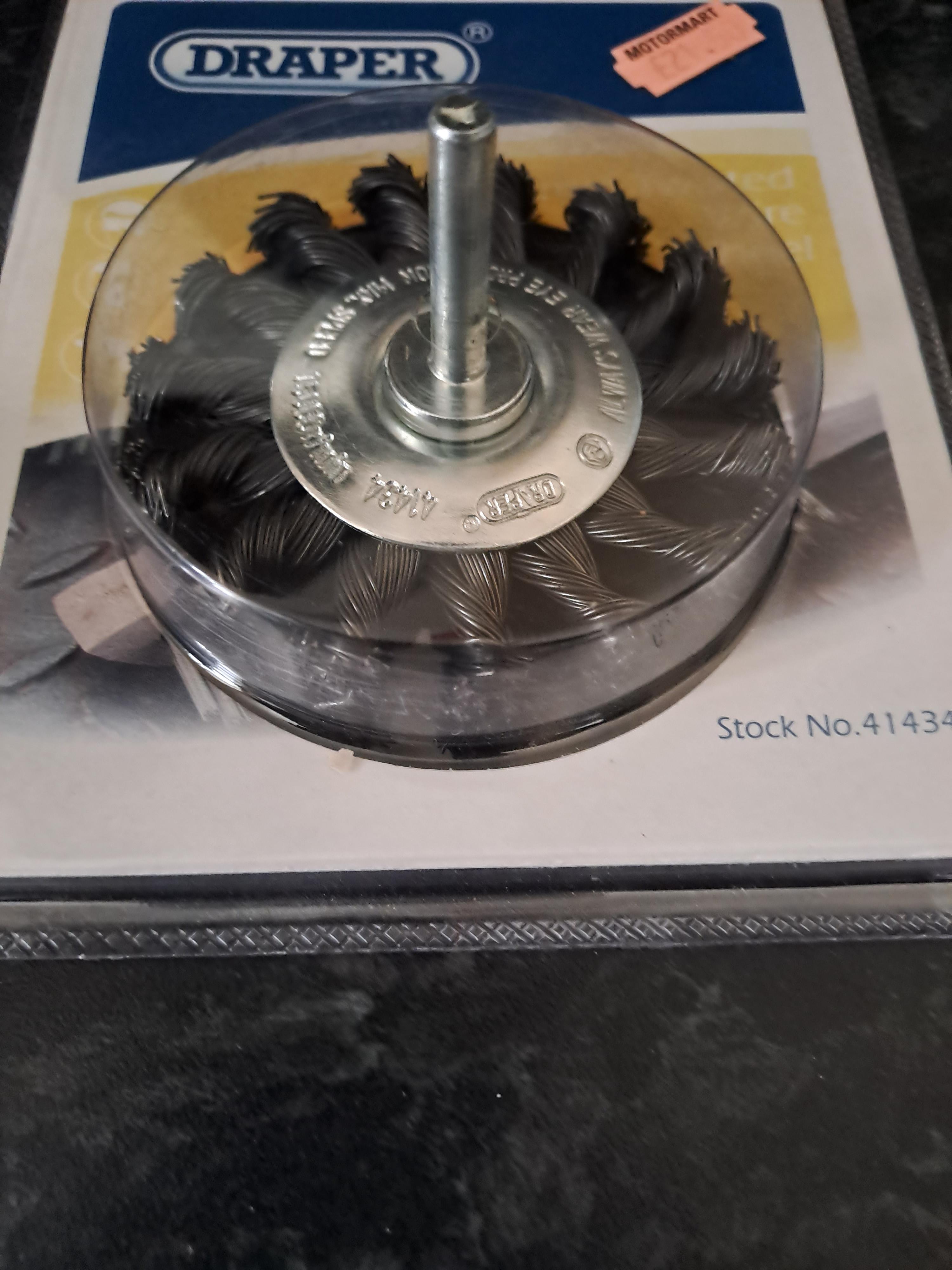

Ok thanks. Also got a knotted brush. But will a non knotted work16754312735824883517054791823558.thumb.jpg.d564b6b9087136be65dc7e4caafdfa9d.jpg

On 2/3/2023 at 1:38 PM, RHYSF00 said:
It will work, but is more gentle. The knotted ones have thicker, hardened bristles and will be more effective. The quickest, most aggressive way is a knotted wheel on an angle grinder. It still leaves fresh metal intact.
