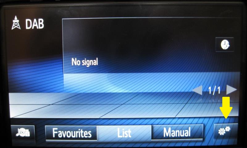

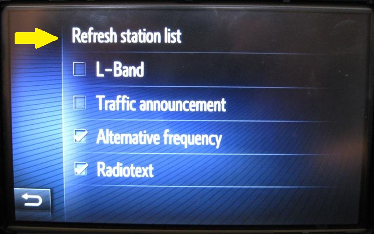

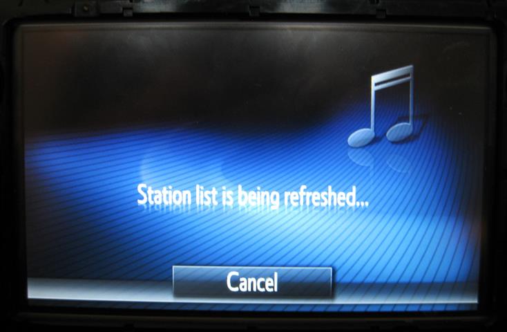

Go into the menu and refresh the list
if it comes up as in the first pic - No Signal - go into the hidden service menu - see if you have any codes in failure diagnosis - also look in the 2nd page of function check/settings - DAB

Thanks for that flash22, I have tried the refresh list but that’s made no difference I’ll try the service menu tomorrow and reply back, thanks
