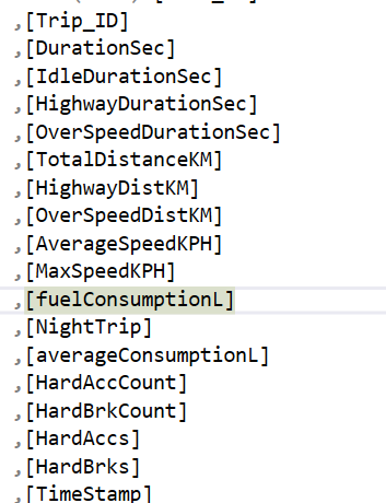

3) Trips, each trip has a VIN and unique identifier that can match to the rest of the data :
  • Start and end which have StartTime,Start Address,EndTime,EndAddress - Addresses not very accurate
  • Trip point lat/long of all the steps of the trip, no time stamps but in order also have Highway and Overspeed flags against them!

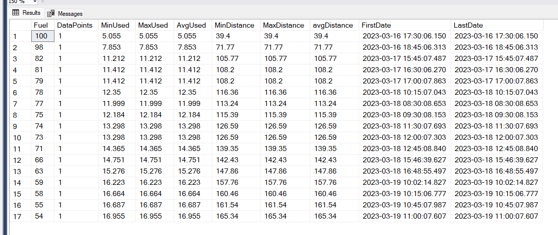

I take all this and throw it into a SQL database which throws some light on common questions :
1) Missing trips I've currently got 904 recorded trips, but also 38 "missing" trips where the car has started from a different location to where it ended (by a distance too big to be gps error!)
2) petrol :image.thumb.png.2aadfb0c55ddf1a72b00d1d13db0d3dd.png
Unfortunately I only started this recently and as the fuel/odo reading is live you have to capture it which is now checked regularly so data will improve over time, but to note that after 5 litres (from a maxed out tank) it was still on 100% I'm expecting 5l overfill (ish) 30l measured 0-100% 2-5l reserve. Although I (almost) never take it below 1 bar!

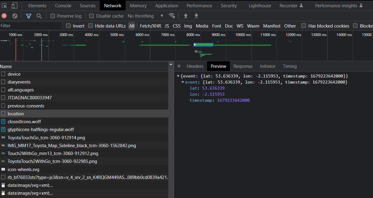

Not on the Aygo Cross unfortunately (well not non my Edge model) data available is by model, the fuel and ODO come under additional information so there may be more items in there for different cars.
I think there is also a "Get Vehicle Status" item which isn't collecting anything for my Aygo but I believe on other models captures door open etc
Two places where data might be!
I found most of the data items by logging into myToyota and in chrome choosing inspect,then Network and Preview as below
Location = Last Car location
files
1,2,3 are the trips 1 = week 2=month 3=year depending on filter you set.
Waypoint are only on the map in web version and other data may be dependent on what view you get for your car, I don't get ODO data on web but do in the app so the only way to access it to write your own code to access the API (or if you use python the link I provided)
