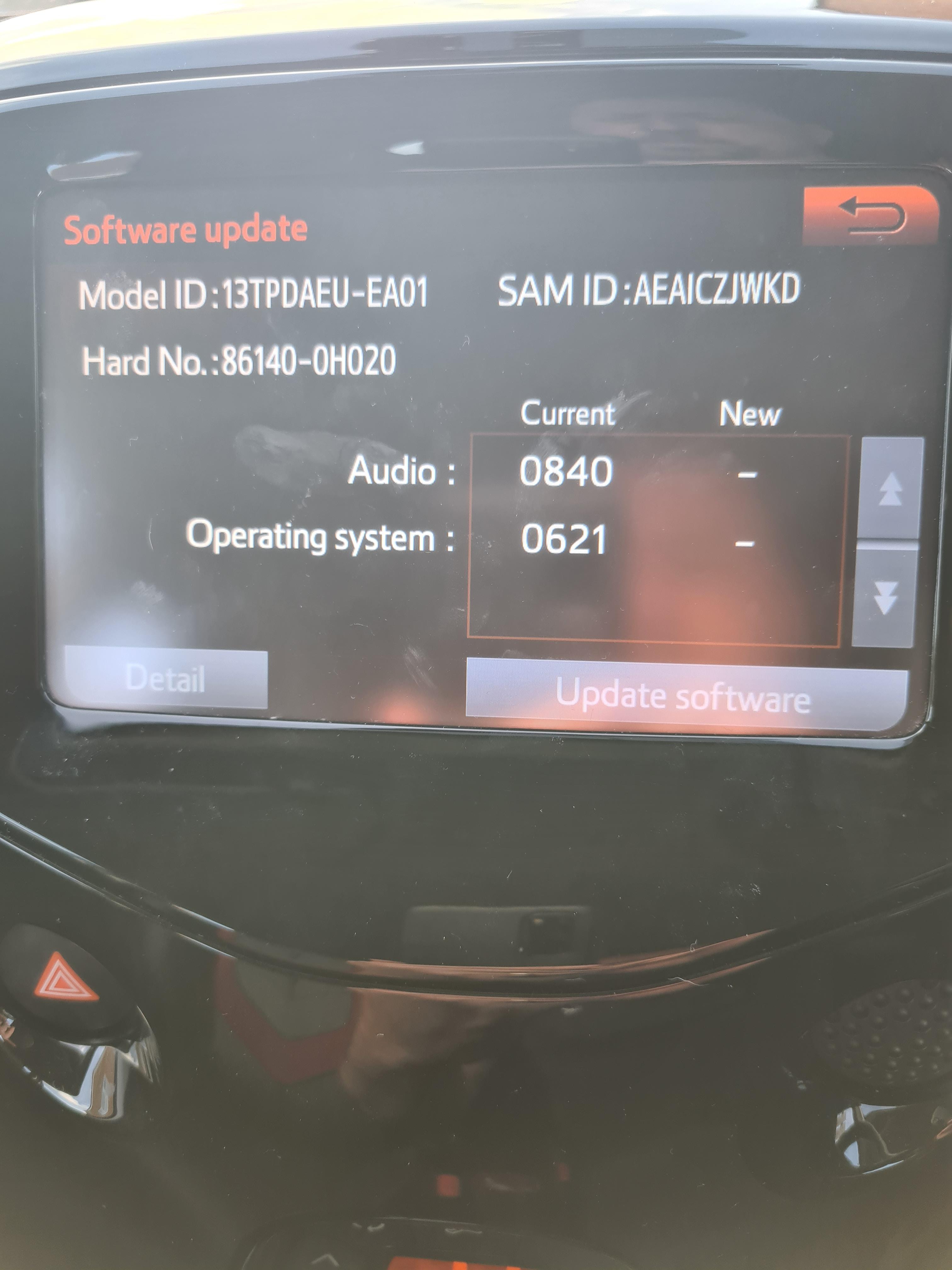

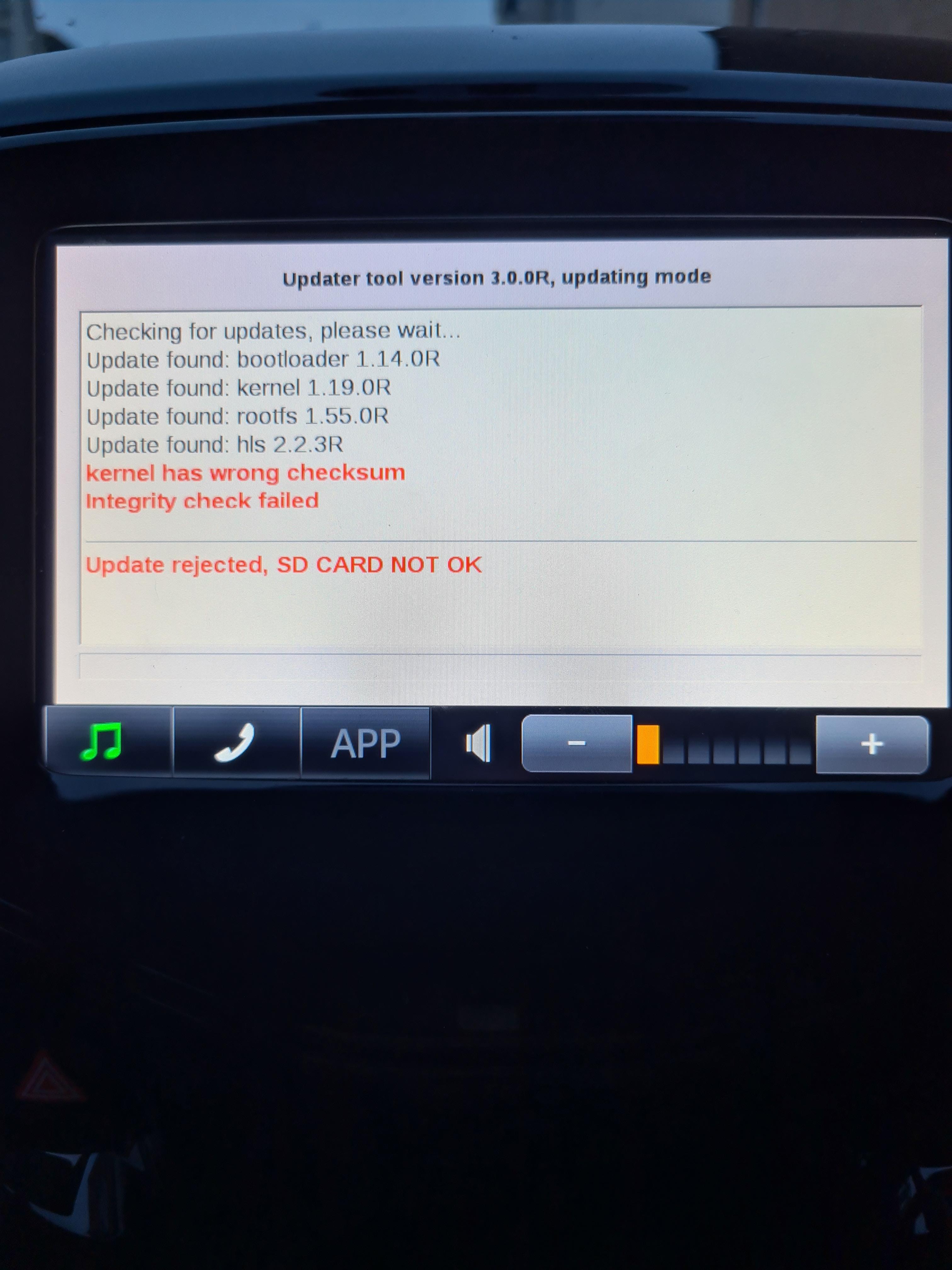

I have just got a Aygo 2017 mk2 prefacelift model. It currently has x-nav but needed updated.

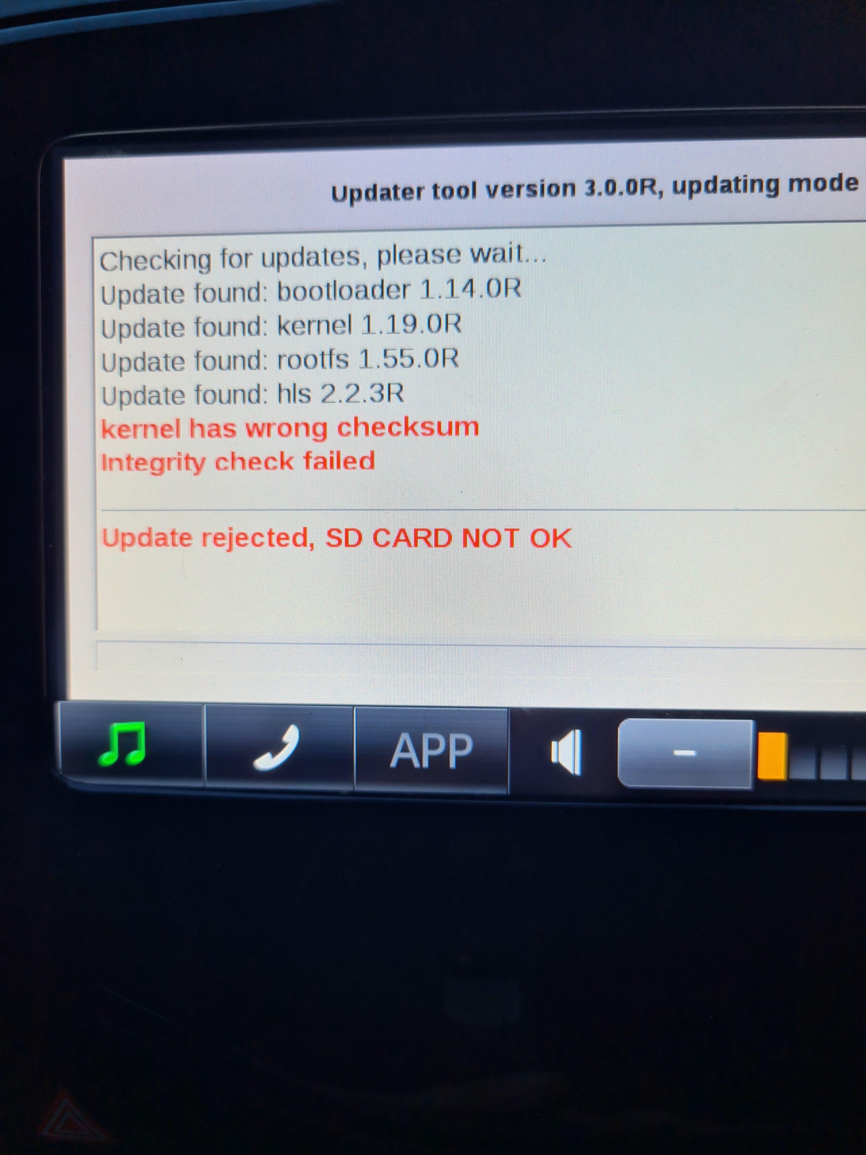

I purchased a sd card with 2022/23 maps but when replacing the sd card in the glove box the headunit is just showing me that I should be connecting my phone via USB cable. I'm presuming I may need some software to load new sd card or configure it.
If anyone has knowledge on the steps and app that I need to follow it would be appreciated 🙂
😊 Thanks
2 button and this is the error when installing new sd card

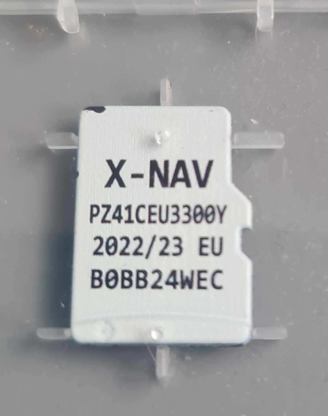

I have noticed the code on my original sd card was pz41ceu3300m where as the new one is pz41ceu3300y
Not sure if this is the issue but was hoping someone wold know.
Not sure if this is an issue but was hoping someone wold know as getting error when trying to install.

The card is corrupted, or you have picked up a cheap copy off eBay or both
Hi Flash22
Your correct in that I did buy sd card off eBay. Didnt know there was good and bad cards out there.

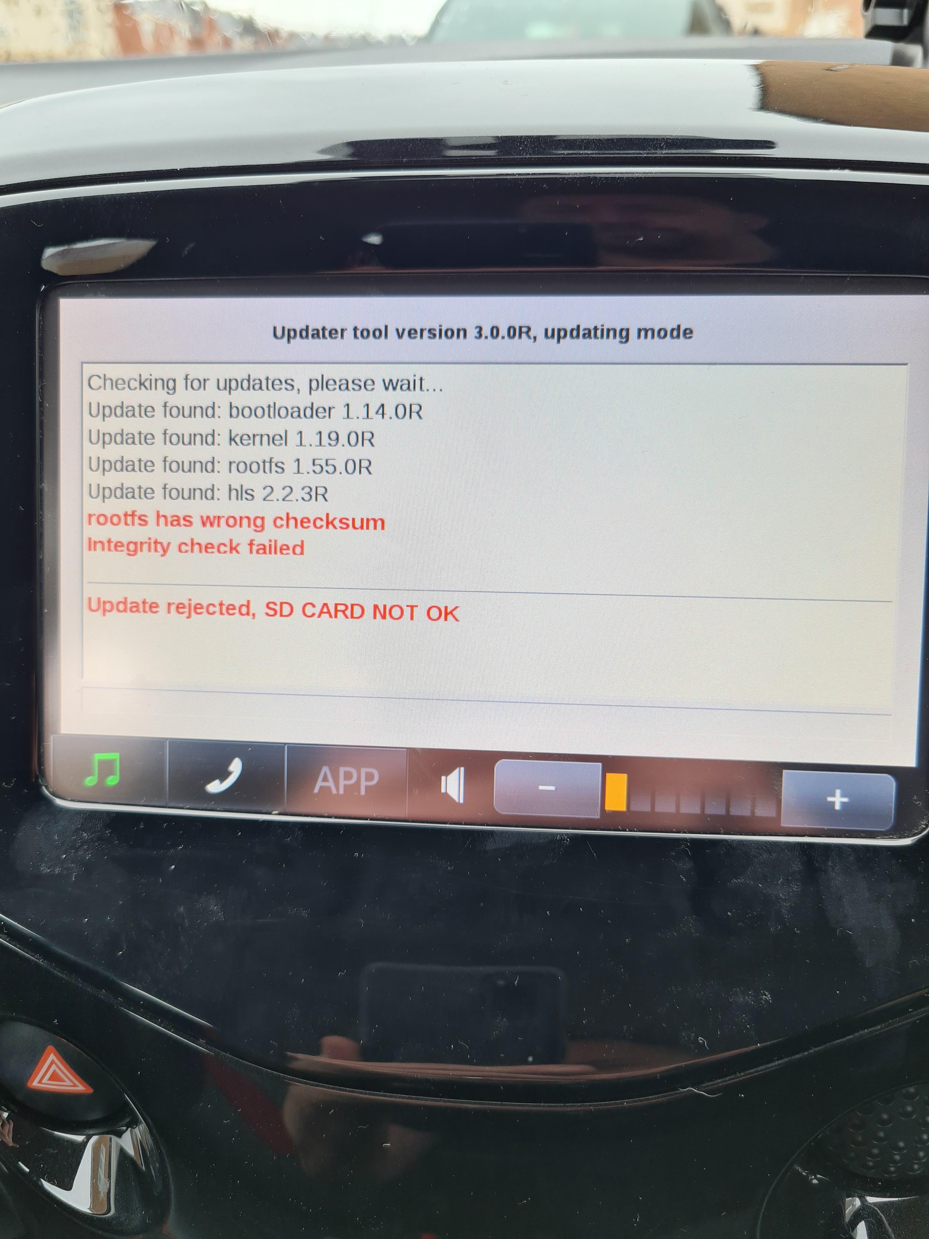

I did and it arrived today but had another error. Although different the same kind around checksum.
Just wondering if it's my head unit at fault.
It's a aygo 2017 mk2 with the 2 button unit with satnav. Which I thought would be the same as the mk2 face lift just without carplay.
Do you think this is an issue or do you think its definitely corrupt sd cards?

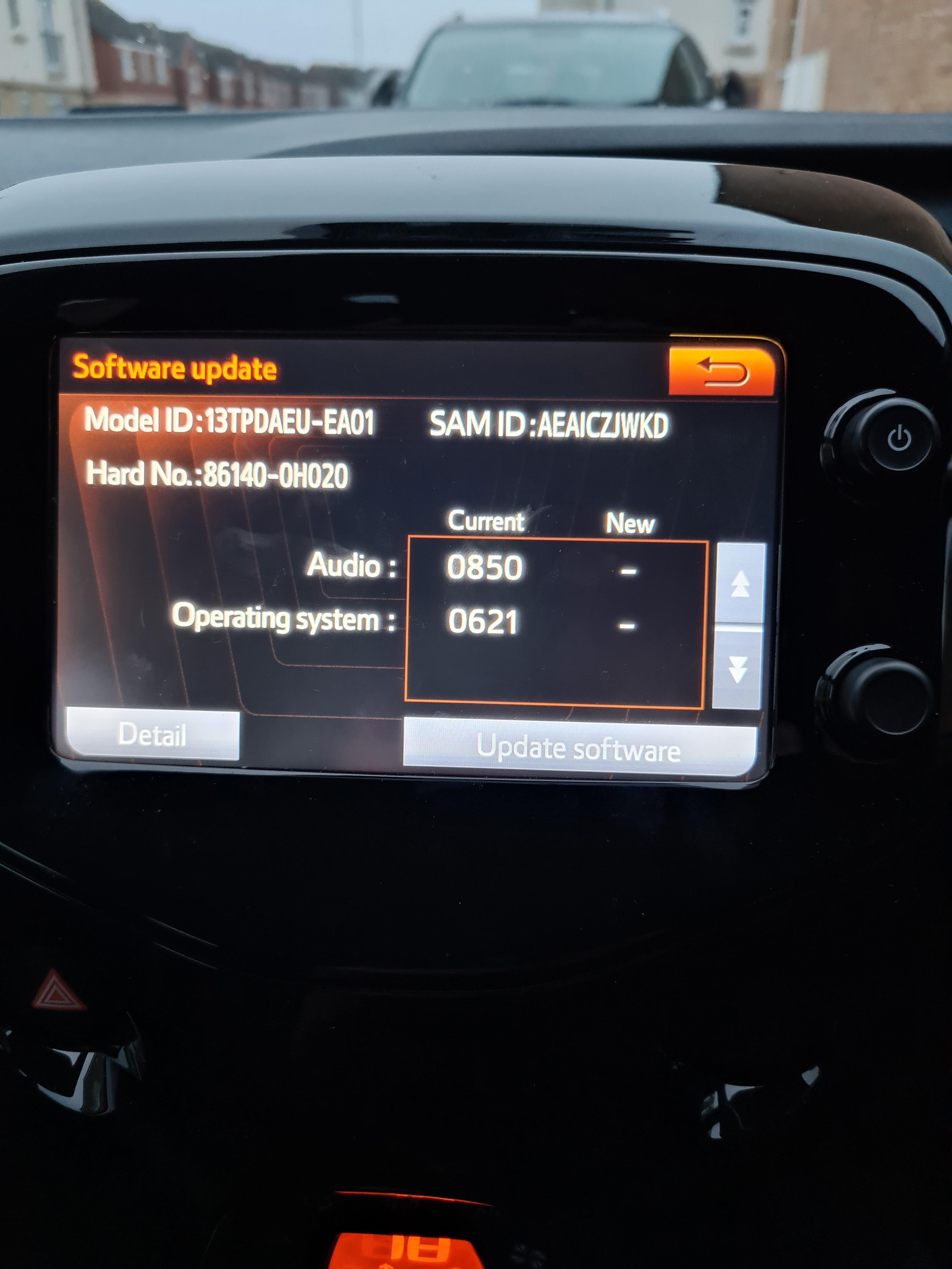

This is my x-nav version also and not sure if it needs update which may/may not be an issue 🤷‍♂️
Thanks Flash22 this is very much appreciated. 😁👍

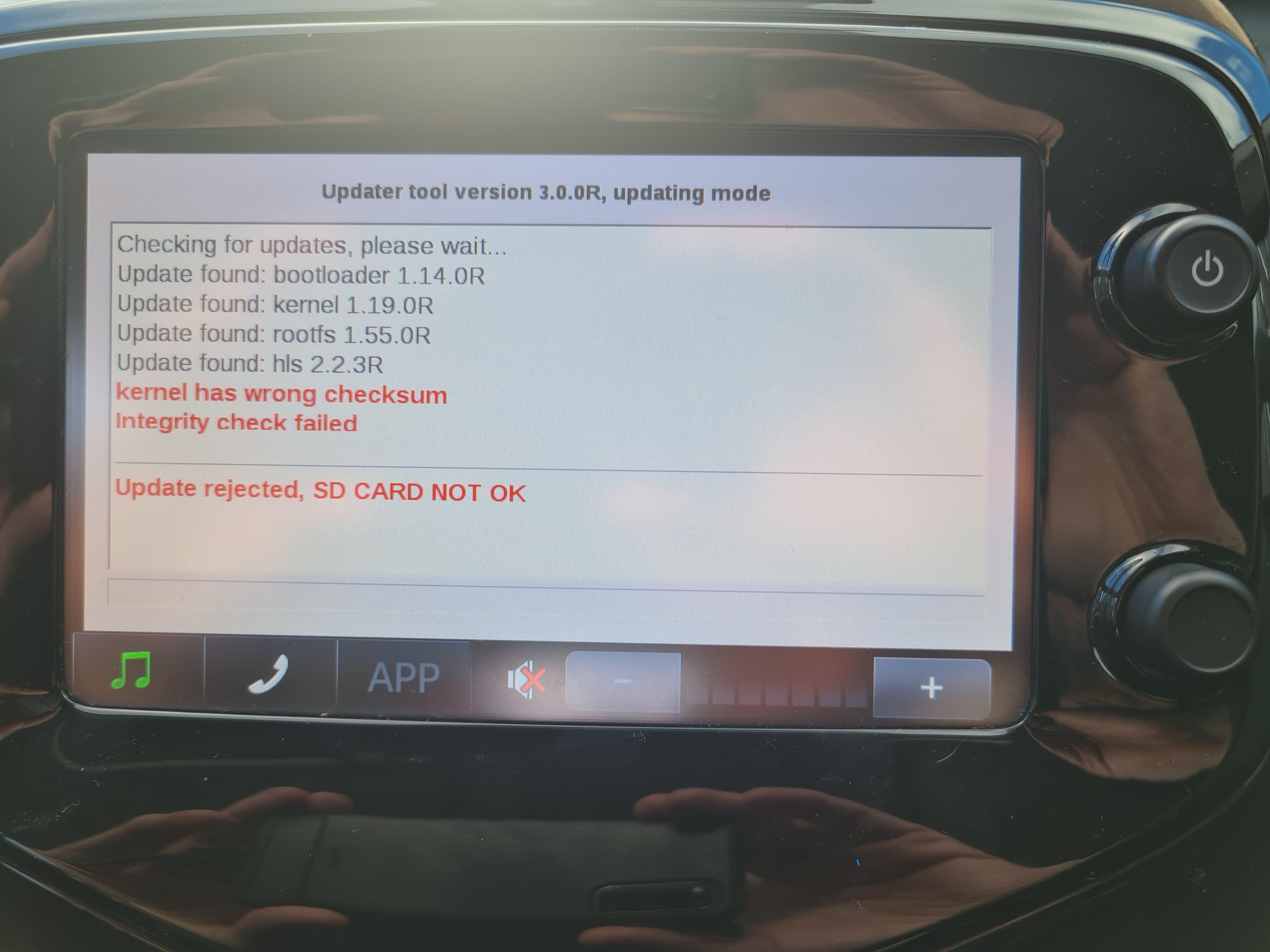

Wrong checksum is a corrupt file or flies are not where they should be you get this if you copy files or try to alter the files, I have spent many hours "studying" these Toyota update files - they are very secure IIRC they use u-Boot to verify the checksum
Updated firmware without issues so thank you 😊
Still having issues with sd cards saying checksum errors. Seller is saying he checks them fully but I cannot see anything I'm doing wrong now.
