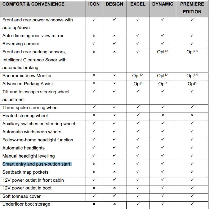

The Design spec doesn’t include either keyless entry or push button start AFAIK …..
Yeah, that's why Max chose it, as he didn't want the risk of keyless theft, but I was just offering possible alternatives.
I wouldn't have gotten the keyless either but I wanted the HUD more so had to live with it. Now that I'm used to it, I'm not so bothered, and having a push-button to start the hybrid feels less weird than turning the key, due to the lack of engine starting up :laugh:
My Y C Design has keyless and push button start
