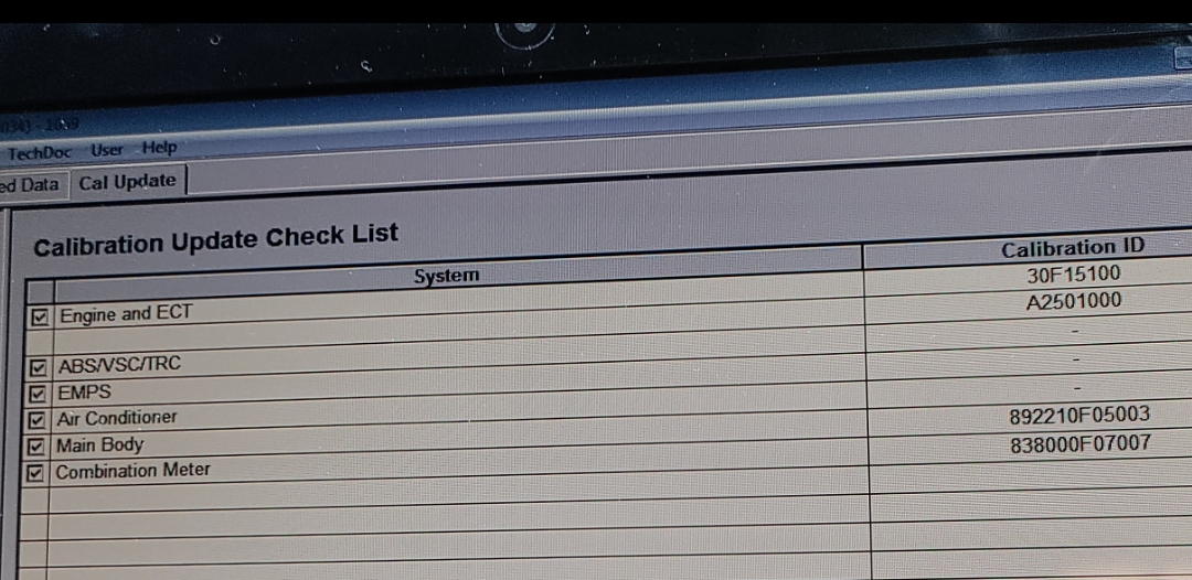

Screenshot below for current calibration IDs.

30F15200 is the latest recorded ECU version for your car and it is linked to several bulletins
EG-0111T-0910-EN - An oxygen (A/F) sensor malfunction is causing intermittently white smoke and/ or DTC P2237 - Needs software and new modified AF sensor
EG-0167T-0311-EN - AD-08 engine: A broken diesel throttle body gear is causing an abnormal noise and DTC P0488 - Needs software and if TB is noisy a new TB
EG-0043T-0611 - Lack of power or DTC P2002 Particulate Trap Efficiency Below Threshold (Bank1) = Needs Software and new modified Diesel fuel filter
Thank you Devon Aygo. Helpful as always. I don't get any codes for some reason and throttle body seems to be working as it should. 1 thing I just confused myself, so if software is up to date, does that mean there's nothing software wise can be done? Car is remapped I believe for better economy. I'm wondering if that's a contributing factor. By doing ECU update does that wipe off ECU map? I'm thinking maybe it's best to just put everything back to stock and go from there.
