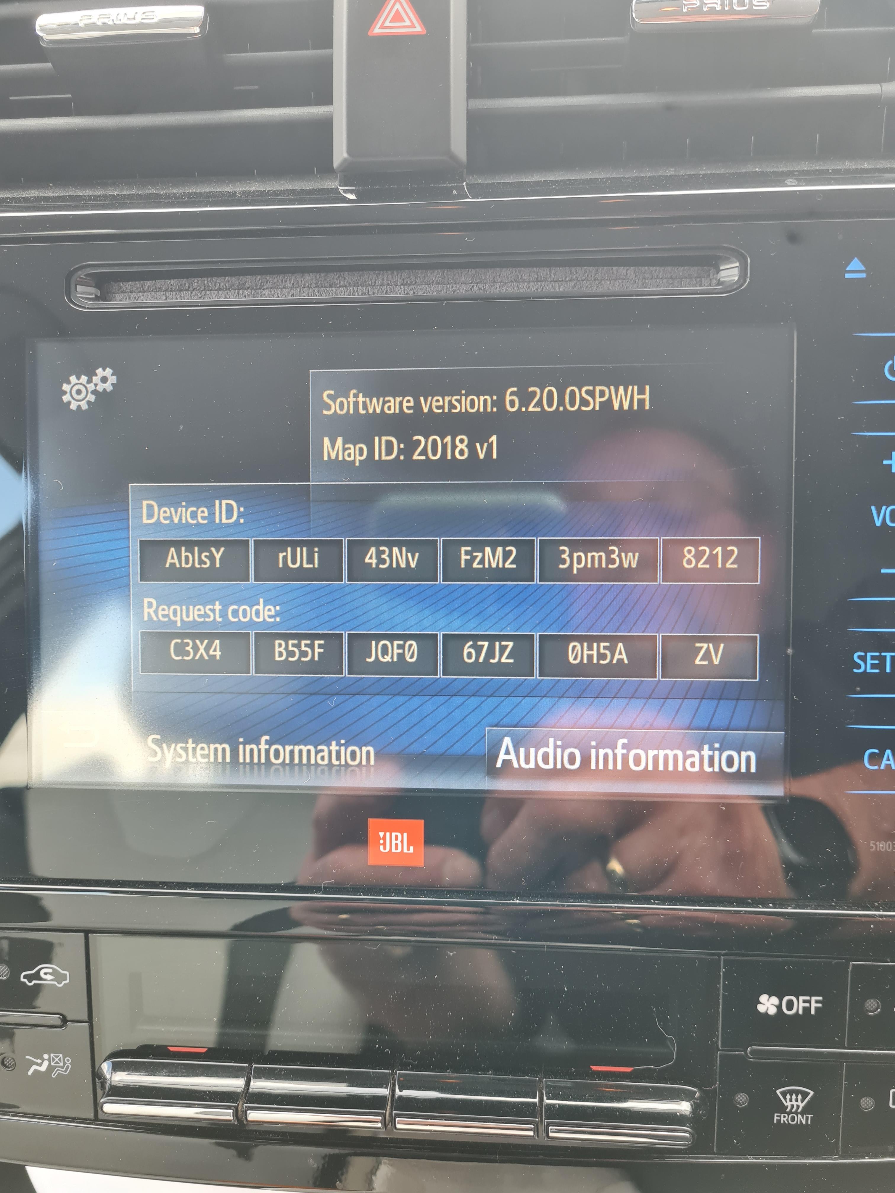

The map system still shows 2018 version1 mapping, although once it flashed 2022.....( too quick to notice)

Got myself a 32 gb stick and tried again to no avail, but noticed another map update which asks for my version type I have 2018 v1  version type 6.20.0spwh which comes up as invalid, so I've picked the closest and will try it tonight
Sorry that didn't work. Assuming it was FAT32 format? After that it's hard to say what the issue might be. I'd try putting a few mp3s on your new stick to see if they load: if not there might be a fault with the USB socket or wiring. Only other thing I can think of is the version: there are high and low versions: no idea what the difference is but my Touch 2 Go in a 66-plate needs low, which has an L not an H in the version suffix. Did you get your current version info from the car itself?
I see you've got the JBL version. Maybe that makes a difference. The software version for mine (non-JBL) is 6.21.1WL and the map update 2023 v1. Beyond that, I'm stumped. Sorry I can't be more help.
