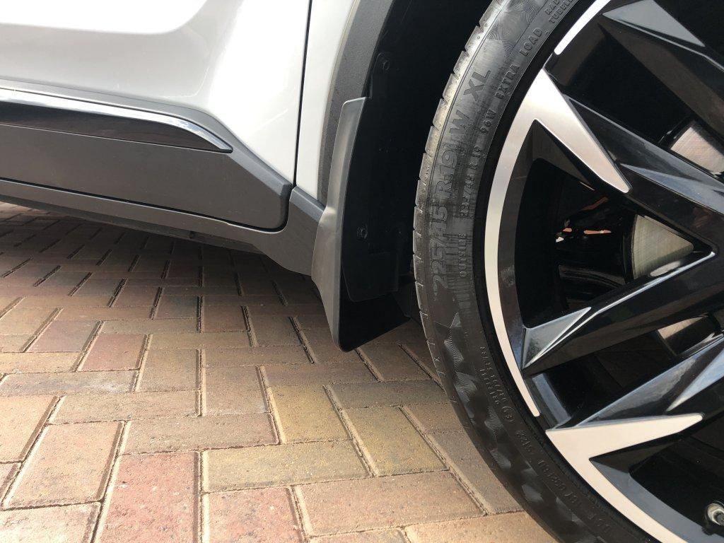

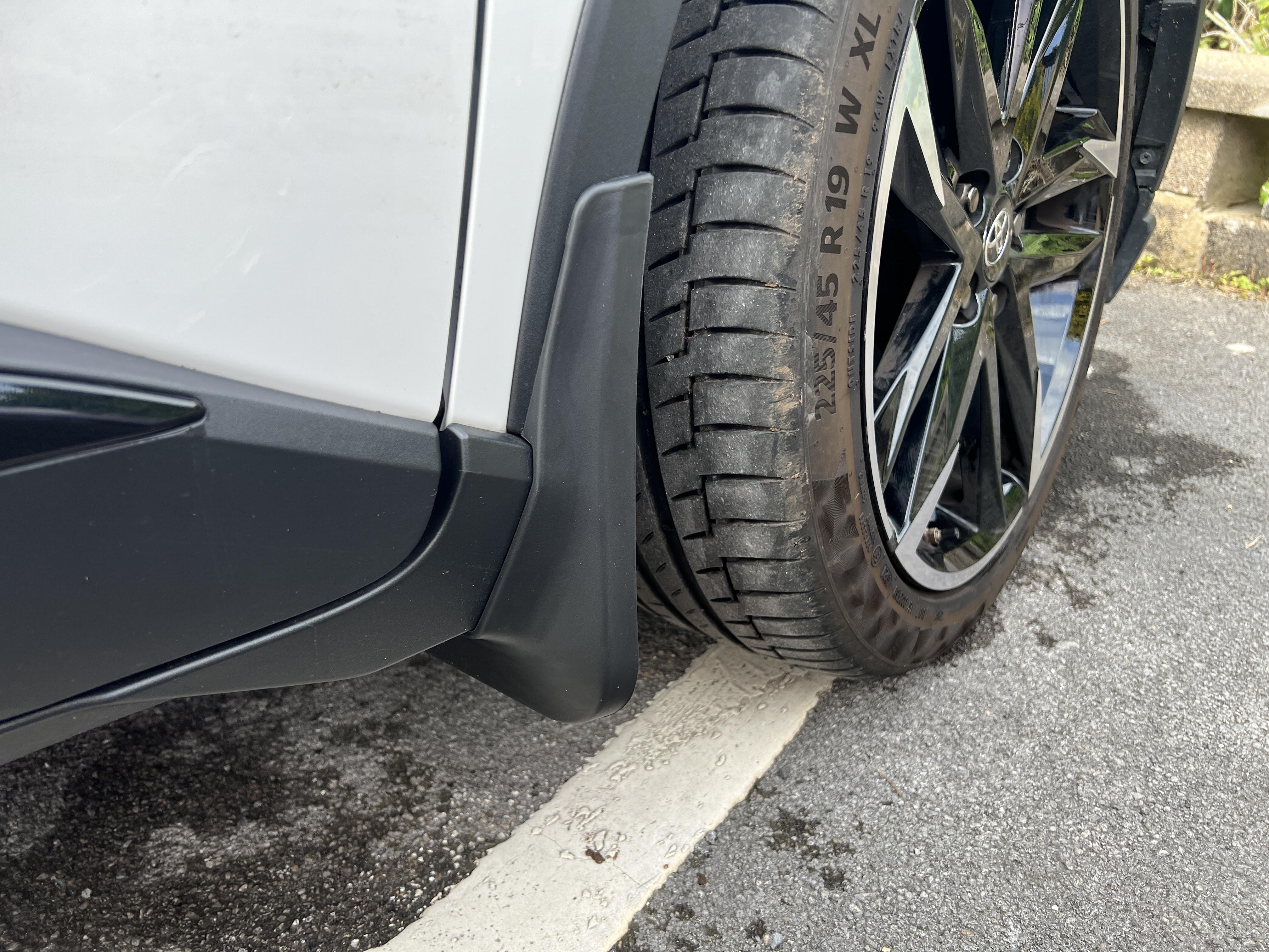

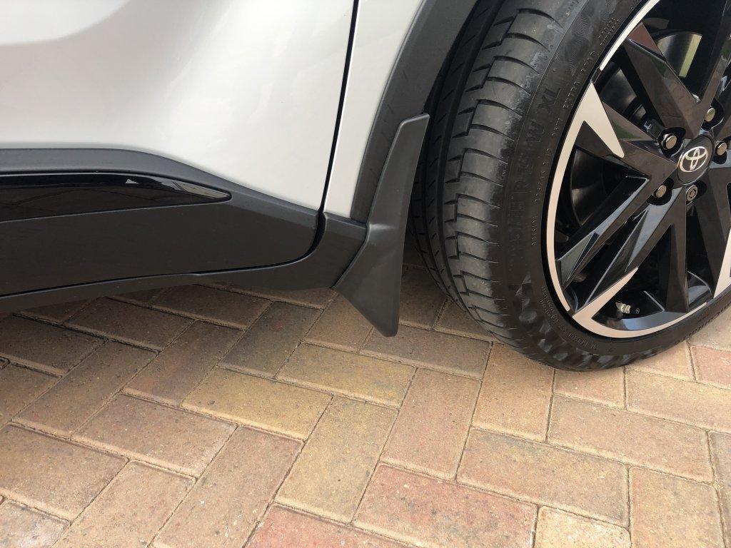

Well, I never got around to fitting the mudflaps this weekend, but did manage to get the front ones fitted today. No fettling whatsoever. Removed three bolts with a 10 socket, held the mudflaps in place and bolted everything together again. As easy as that. I'm quite impressed with the fitment and quality. Never even had to remove the wheels.
Rear ones will have to wait until I can get the rear wheels off, as per the Toyota fitting instructions. The rear mudflaps use two of the original mounting points but need to have a couple of 2mm holes drilled for the supplied self tapping screws. In order to do that, I need to remove the rear wheels, so it's a job for another day when I have a bit more time.

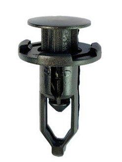

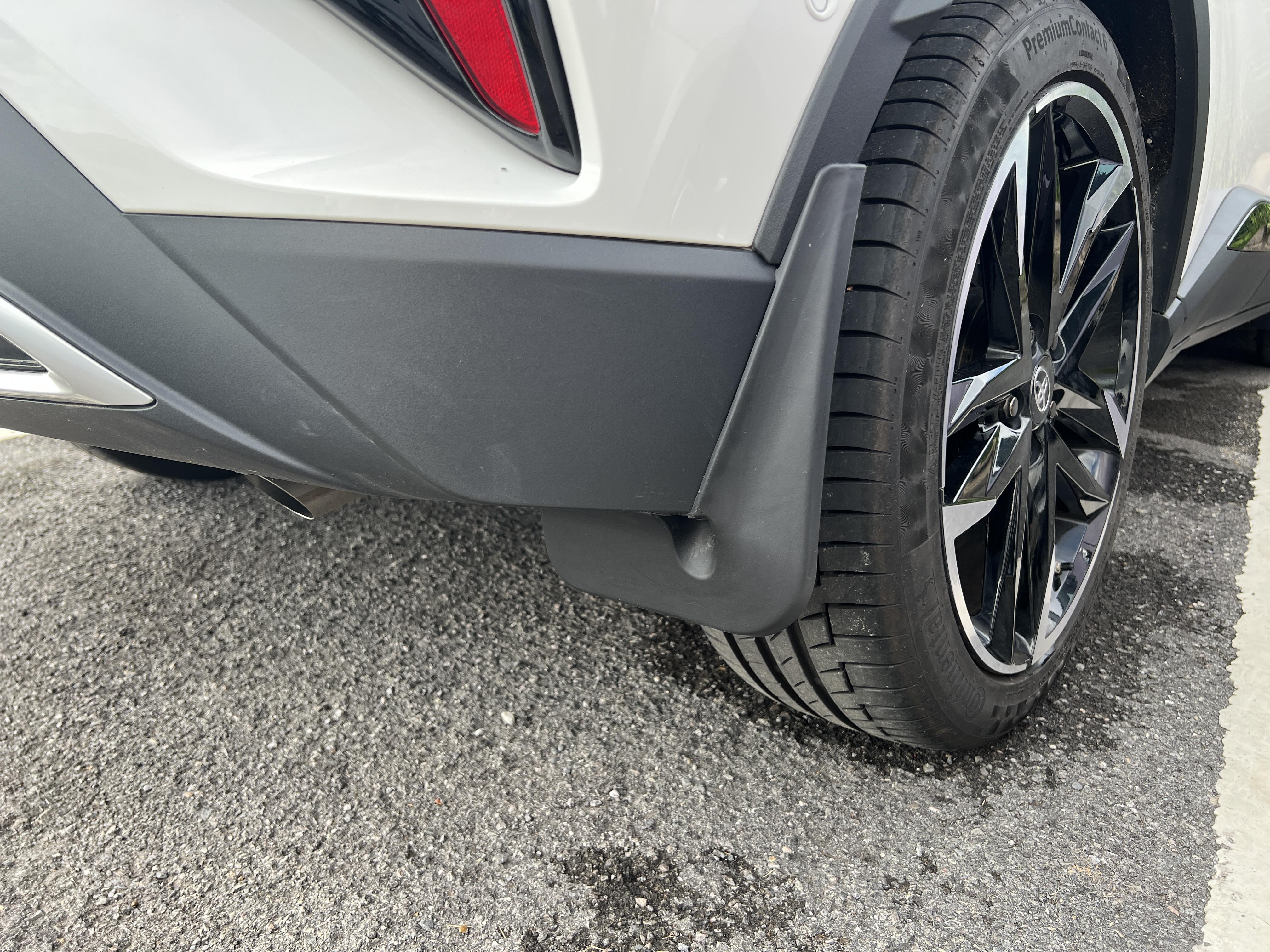

I managed to get the rear mudflaps fitted today. It was easier than I thought. The hard part was removing the plastic retaining "rivets" which will be used to fasten the mudflaps to the bottom of the car.
So, do you have to replace that revit that you had to remove?
