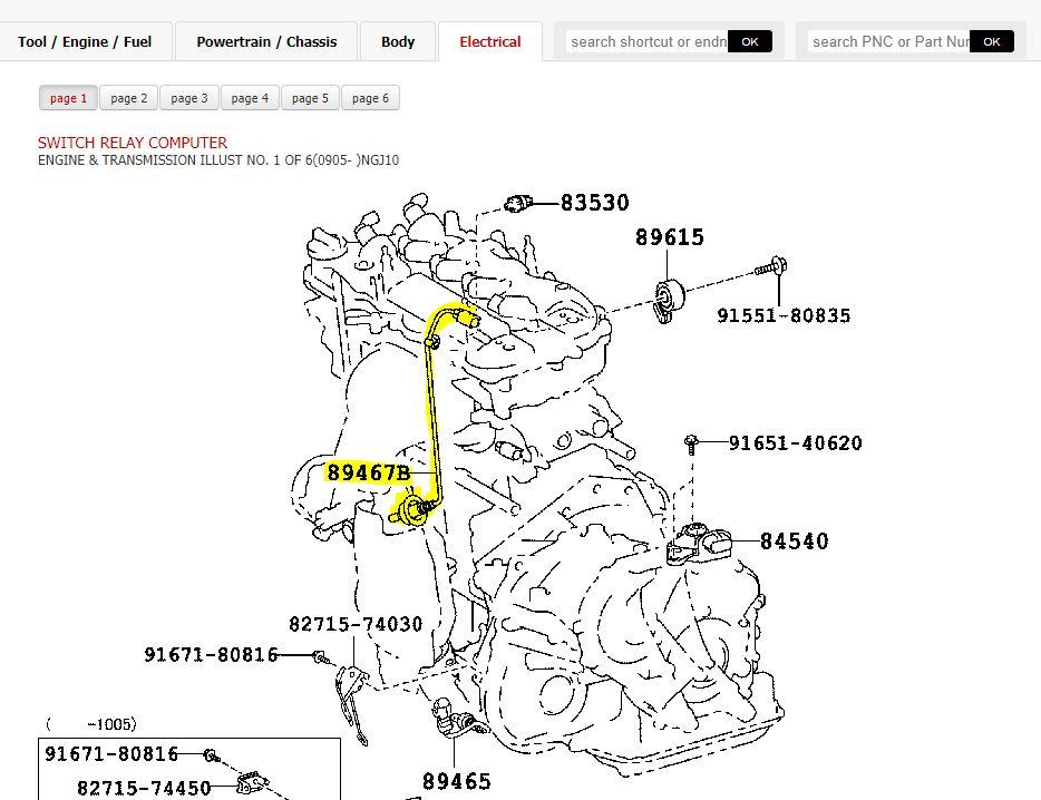

Thanks a lot Bper. Do you know if the following would be the correct sensor I need?
Part Number - 89467-74030

B1S1 is always pre cat, Toyota call it a A/F sensor, stuck high or low is usually a failed/failing sensor
89467-74030 around £220-230 retail
looking at the aftermarket pre and post-sensors are the same part (89467-74020) 1.0 and 1.33 - NTK/NGK 91025
