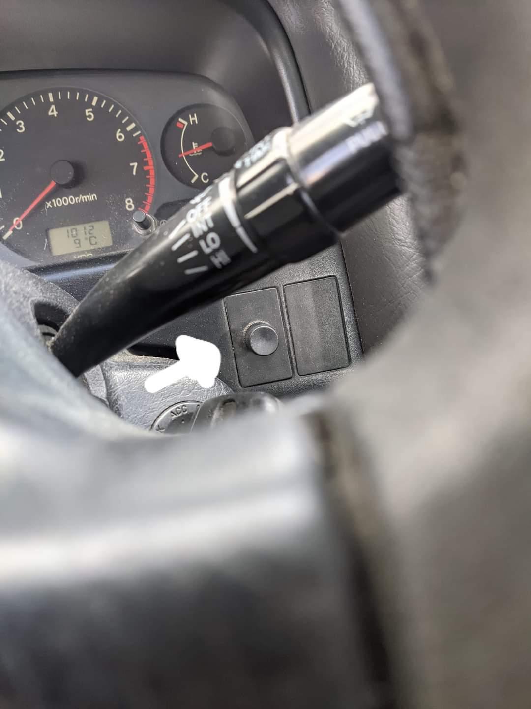

Anyone know what is this for?
It is similar like a choke for a carburettor,I can pull it out and then back in.
So far it seems to do nothing at all.
I looked into the manual and that location should be for extra features (like heated seat etc) but I still can't find what it does.
It is a 1998 T22 (4AFE) (I think made in UK).
That doesn't look like it's factory installed. Then I would have expected a clear label or symbol to indicate its function. Alarm, immobiliser, extra lights? Pull the panel out and follow the wiring...

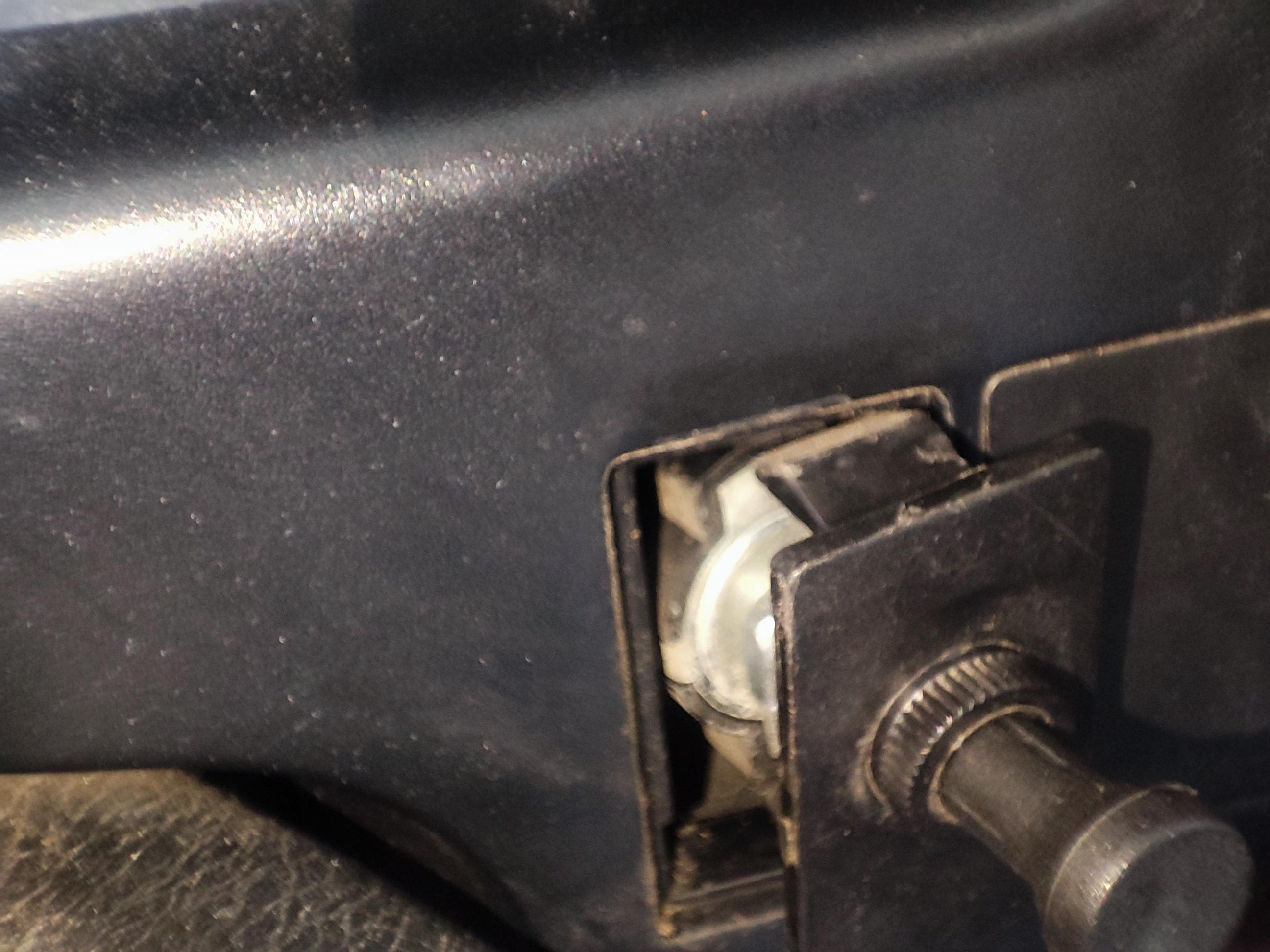

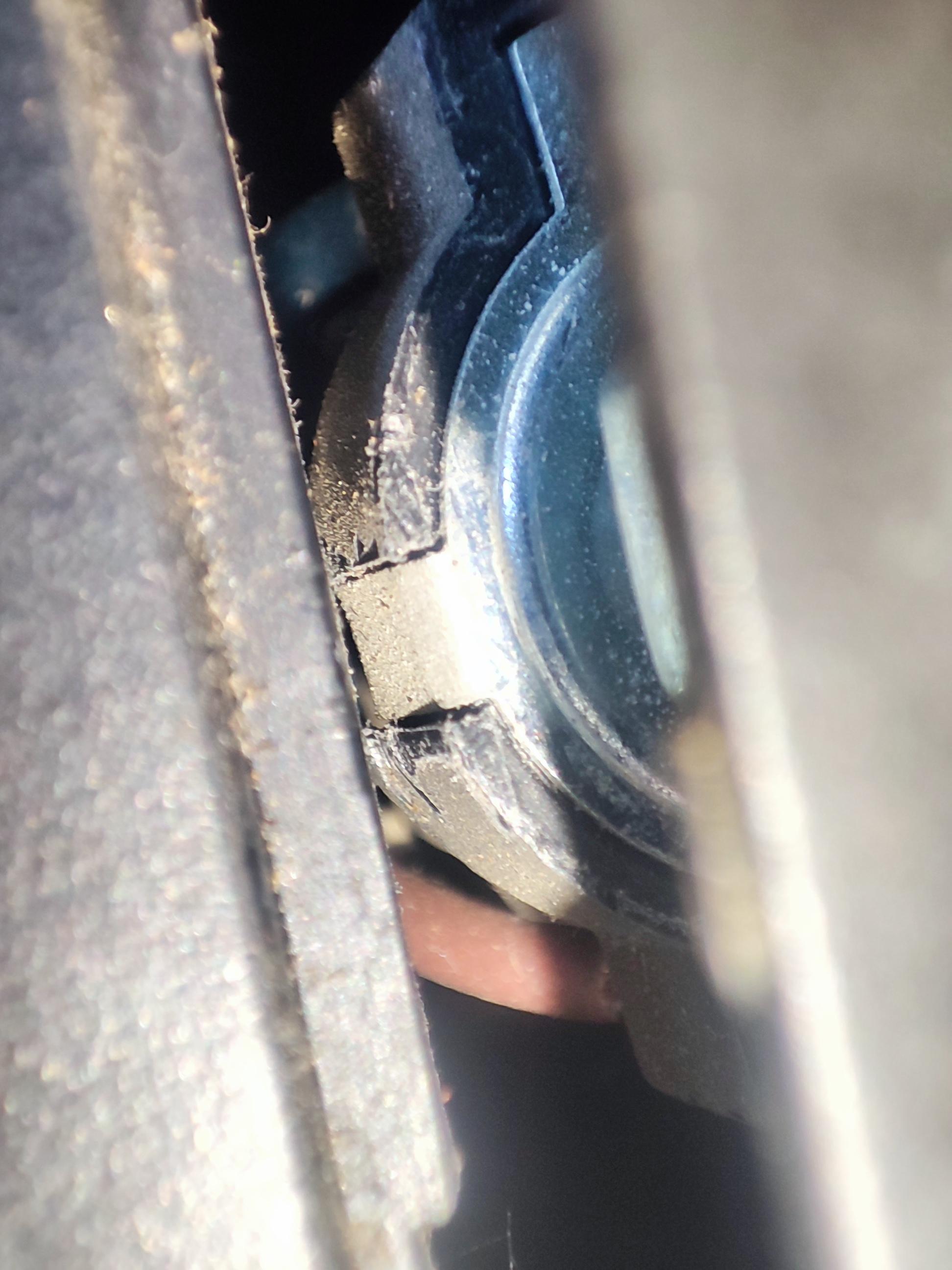

I popped it out,but I could pull it all the way,I have to remove the plastic panel around it but I didn't have any tools with me right now.
So I see some wires hooked up to the switch, is there any chance I can narrow down what this is for untill I pull it out all the way?
Maybe the color or type of wires help?

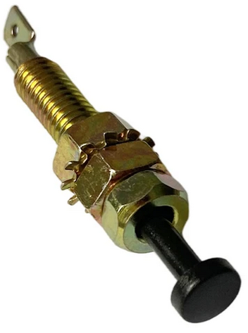

It looks like a pin switch. I've used them with aftermarket alarms to secure the boot and bonnet.
The switch could be a makeshift immobiliser or connected to an old aftermarket 2-wire alarm. They used to be activated using a rocker switch which was advised to be concealed on or under the dash.
If you can't trace the wire, try leaving the switch all the way out when using the car. It could be that whatever was previously installed was removed by the previous owner.

It looks very similar. The car has immobiliser from the factory so I guess this could be the 2-wire alarm as you mentioned.
Why should I leave the switch all the way out? I found it pushed in(but tried pulling,nothing changed). Is pulling the switch (normally) the off function of whatever this thing could be?

If this is a pin switch, leaving it all the way out would activate whatever is connected. Pin switches are normally spring loaded to stay in the on position. When the switch is pushed in, it disconnects the power supply.
