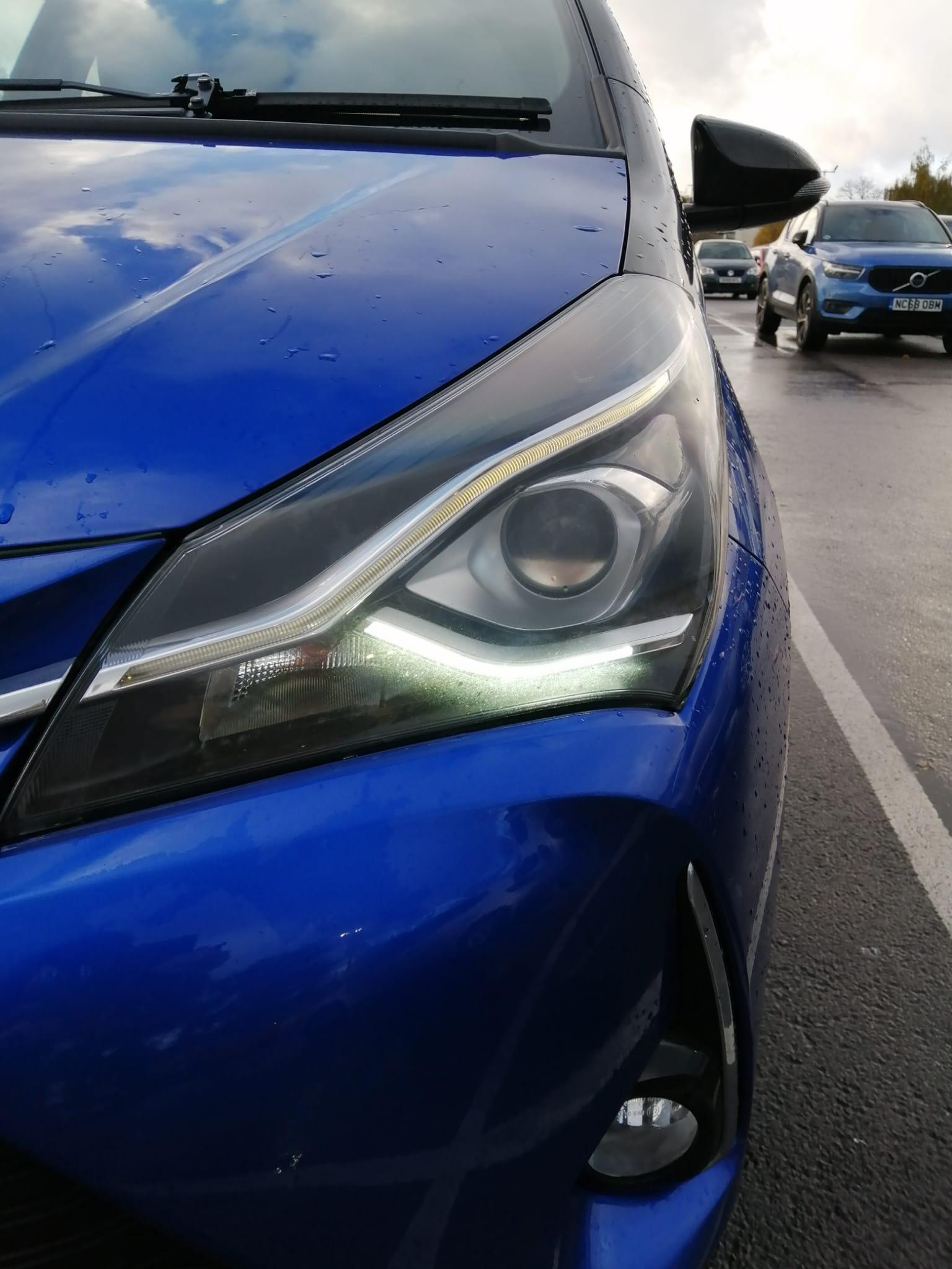

The lower arm of my near side LED running lights on my six year old Yaris failed in March this year. The dealer said that the only solution was to have the whole light replaced at a cost of £450 and this they did. Today the offside lower arm of the LED running light has failed and it looks as if I am faced with another £450 bill. Does anyone know if this is a common fault? Is there anyway I can avoid paying for this again? The car has done 35,000 miles which at a conservative estimate represents about 1700 hours when research shows that they should last about 10,000 hours or the life of the car. These lights also act as side lights so I guess it’s an MOT failure if I don’t get it fixed.
It does seem to be a common failure yes, there was a thread not so long ago about the same issue with failing LED strips on late model Mk3 Yaris.
Sometimes it seems to be a better bet to have the lower models in the range such as mine that have standard incandescent bulbs for the DRL, and if they fail its just the cost of a single light bulb. Integrated LEDs are a bad idea as you and others have found out as they cant be replaced. Some people have attempted repairs on them but you need to be quite technical minded to be able to do this. See the article on this link:

From what I've read, for the Yaris DRL there's no a problem due to a driver or led failure but due to an oveheating of light guide.  The surface of the ligh guide that is in contact with the led becomes brown due to overheating and looses the capabilty of carry the light.
Unluckily it's not possible ( in reality someone succeded but it's not easy ) to unassemble the headlight to clean the DRL light guide.
Interesting. That sounds like a plain poor design as I would have thought the LED does not need to be in contact with the guide, just shine at a right angle to the entry surface.
An LED should not get that hot.
