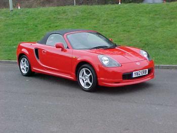

I recently bought a 2003 MR2 Spyder. This is my first high preformance car. I have been riding motorcycles my whole life and I need more acceleration out of my MR2. Top end is not an issue, so if I can fool with the gearing that could be a possible solution. The acceleration is decent first through third but, after third gear the car has a sluggish low end and seems to need a little more. The dealership suggested a microchip kit for xtra horsepower. Is there any suggestions as to which kit I should pick up? I thought toying with the exhaust and intake might be a good start too. I found an article linked to import tuner's website that was talking about a "Moon" racing exhaust. any ideas? as for intakes I have know idea. I want to leave the body stock, except maybe the suspension, because I want to make the car a sleeper at the line. If anyone has any ideas or suggestions I would appreciate your advice.
