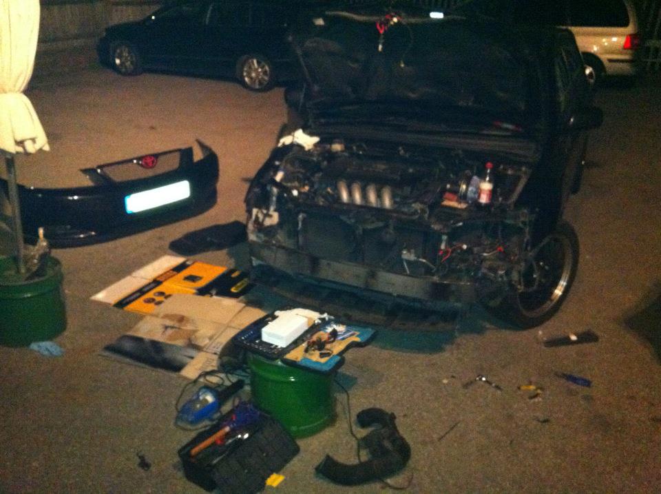

Drop the bumper, much easier as stated on previous posts about this subject it can be off and back on in about 45 mins.
Drop it, drop it, drop it :help:
