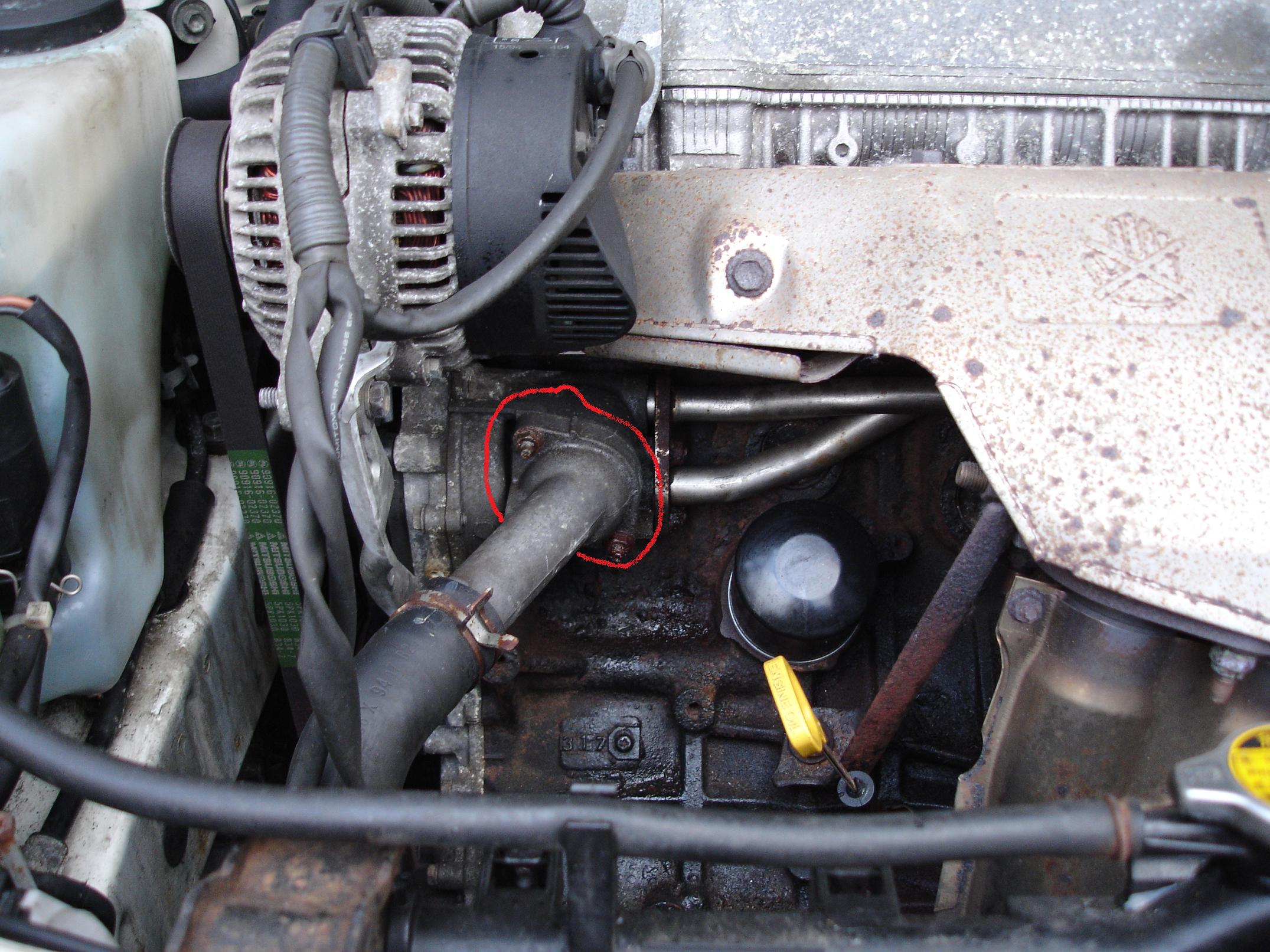

I have recently bought a Carina E 2.0 Exec (genuine 37k!) as my runabout and I seem to have the same heater symptoms as Paul B. Temp guage seems to dip and rise (never above half way) and the car has never overheated. Now the winter has arrived I'm less than happy with the amount of heat from the heater, it certainly isn't that hot despite being set to full.
Regarding the thermostat change, did anyone try this and did it solve the problem?
Am I correct in saying the thermostat is located here ? (click attachment pic) post-15038-1261144729_thumb.jpg
Yes, that is the thermostat. Don't forget to drain the coolant before you open the thermostat.
The temp gauge should be around half on the meter. Have you felt if the waterpipes from the engine to the heater are warm. If they are not you don't have enough circulation to get warm water to the heater and the result is it is cold inside the car. It could be an airtrap in the heater causing this problem.
Thanks Balikbayan, I'm going to change the thermostat as a matter of course and check the pipes at the same time and try to rid the system of any air, hopefully this will cure the problem.
