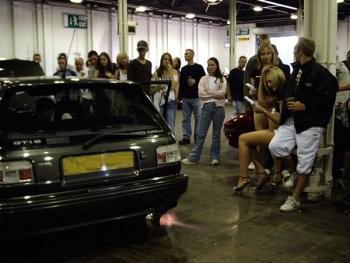

no but mine has it. it isnt as hard on turbo's and maifolds as people think i havent found any signs of damage during my engine build
it has its benifits. mines switchable so its not on all the time. gives you the feeling of driving an extreamly powerful normaly aspirated car(no lag between shifts) also has this benefit
