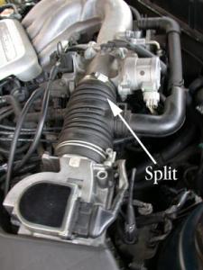

ask your dealer to check the intake hose as this could be split and where the engine leans forward when breaking it causes the hose to stretch a little creating an opening in the hose... this bypasses the air intake management system
see a pic of an older camry below
