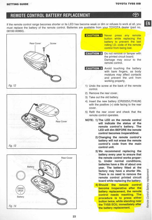

Resurrecting this abit as i own an old toyota carina E with the toyota TVSS iiiB alarm and 1 of the fobs had programming issues for a year or so.
I just left it until i found an old installation manual of the TVSS iiiB (see attached) after which after reading the 2 highlighted points on the attached, manage get the 2nd fob reprogrammed. Instructions i did were as follow and hope if someone needs to give it a go it may help you:
1) take out the Battery of the fob u want to programme. make sure its a good Battery with good voltage.
2) get in the car and shut the door, put in the Battery of the fob, press either button twice close to the foot well, to see if it re-programmes the fob. if it responds, u got a winner, if does not respond, take out the battery again and go to step 3.
3) press any button for a few times after removing the battery a 2nd time in point 2 above, (this supposedly will cause the fob's rolling code to be lost)
4) put in the battery back in immediately after step 3 and shut the casing
5) press either buttons again 2 times with the fob close to the footwell which hopefully is close proximity with your immobliser box. you should then trigger the immobliser's rolling code to accept this new fob.
if this does not work, reset it again by pressing the buttons whilst the battery is out and then repeat from step 3 on again, try to get the fob as close to the immobliser box as you can whilst u press either buttons 2 times on step 5.
good luck.
