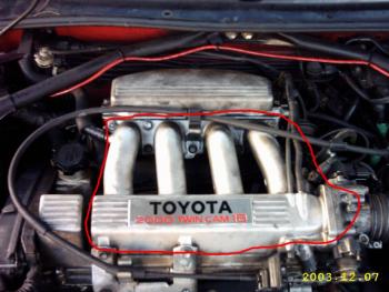

Hey Blackkat, just takeoff the half of the inlet Manifold,this is the part going over the Cylinderhead and connected to the Airfilter then remove the cylinderhead cover and u will have enough space to remove the feul injectors.....Removing the inlet manifild from the engine will be a big Problem and waste of time.i added a pic to tell which part i mean but i hope u have the same engine.....good luck
Thanks for the reply Darwish :thumbsup:
the engine is exactly the same.
