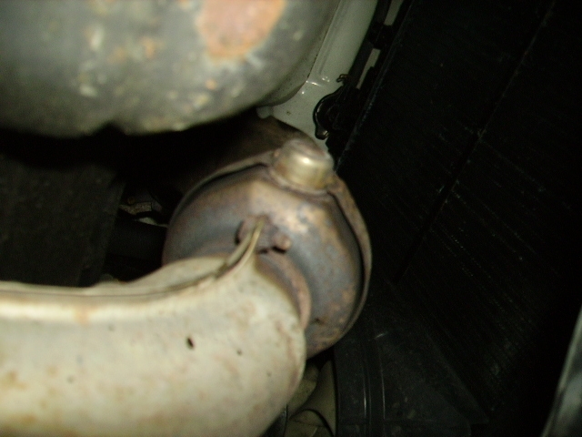

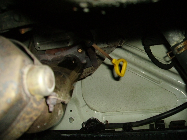

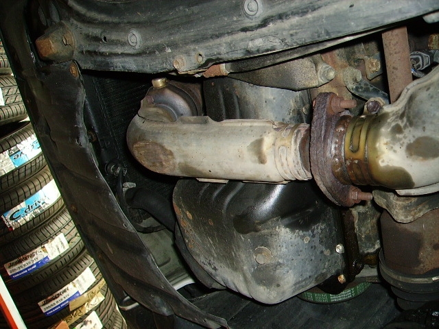

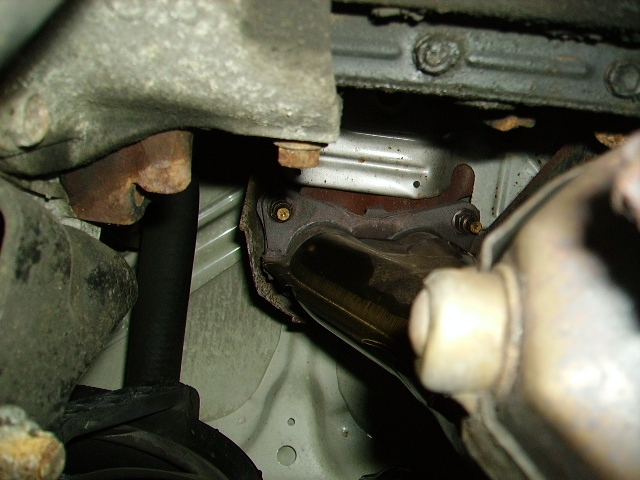

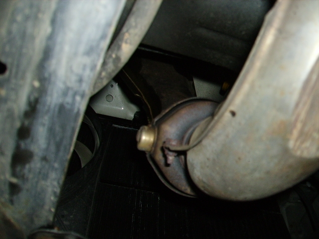

Can anyone tell me from experience or my attached pics, do I need just the one pipe or is there an extra bit to attch to the manifold or the cat'? I've looked on line in the UK for pattern parts but the front pipe on the diagrams I've seen isn't clearly showing what I need and is marked as 'unavailable' anyway, perhaps the 'trick' rotor part makes it unviable to manufacture. Where can I get the part/s? Toyota?

The front pipe (manifold to cat) appears to be a one-piece. Aftermarket exhaust components rarely resemble the original. All the manufacturers seem to care about is cheapness. So long as the manifold connection; Hangers; etc. match there isn't usually any problem. Copy components 'should' just bolt onto your existing cat.
I've never had to replace the front pipe before on the Carina E as on mine it was very solid. It appears that yours had 'grounded' at some point in the past. Don't worry about thost metal jackets. The Origianl MR" has similar shields. Copies do not and swapping them over is not worth considering.

Many thanks for that I should just add that my model is the 16valve 2.0 version but I searched the site and found what I hope is the right part straightaway. I'll email them with my pics and a pic of the part I don't want. I thought it was curious the front pipe failed too, it is right at the top near the flange but it doesn't appear to be rubbing anywhere, my car has a one owner full Toyota service history and is very clean also, so it's a mystery!
