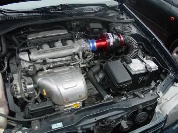

it appears like a stock 3sge with either single VVTi (red top) or dual VVTi (black top).
Read tops were in the Rev5 NA Jap MR2's, Black tops were in the Altezza.
The engine mounts are different though, so a black top will not slide into an MR2 - But the heads (with the VVTi gubbings) might fit on a stock MR2 block.

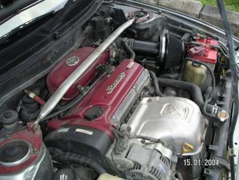

but heres a pic of the engine sitting in my car .. :D

dear zardoz .. that big air filter u see does make a BIG DIFFERENCE .. recently i replaced that big open pod to a smaller one due to the big pod being too loud .. felt that the power drop was significant .. planning to go 4TB way if enough space in my engine bay in the future for even more air .. :D
dear D3S .. that engine that u are getting from a former F3000 jap car or a stock engine with mods ?? with the mods u mentioned .. u may get maybe another 5~10 hp .. depending on your setup and tuning .. u will definitely know it if your vvti wasnt working coz i accidentally disconnected my vvti sensor one day and the car was sluggish .. especially on the lower RPMs ..
