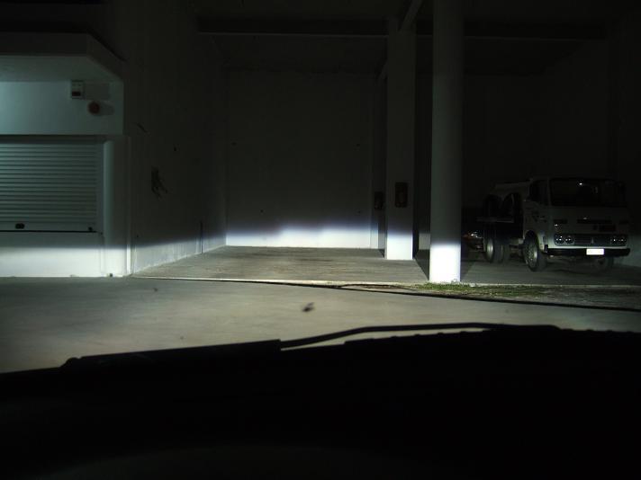

Alex thanks mate! Can you also take a photo like the one I attached, I want to see how good and clear the cut off is.

Whoa, nice pictures brother! Thank you! ;)
But could you take a picture exactly like this but with only parks on, at night of course?

Hey Alex,
I am about to get a HID kit, I have an option to get smaller ballasts or stick with original sized ones. From your experience, should I go for smaller ballasts or stick with originals? The smaller ballasts will cost me $50 more.
Normal size ballast is 7.5x9x3cm and a slim ballast that is 6.5x9.5x1.5cm.
What do you think? Is there enough space for normal size in the engine bay?
Hello Modena!
Sorry for not posting the pics you asked for so long... It's very rainy in Finland, raining
every day and the asphalt is wet. So been waiting for the dry asphalt, otherwise the light
cannot be seen properly on the road!
I suggest you to buy original sized ballasts and install them as follows:
Open the hood and remove the long black plastic cover, which is placed in the front side
of your Toyota's engine room. After removing you will see two metal bars (they have the same
colour as your vehichle) going pretty symmetrically on both sides (there are some holes in them,
also the ones which are used when installing the plastic cover). Now you will have to release the
air-filter's pipe's holding mechanism to be able to move the pipe. (This will be needed when you're
installing the ballast, you will have to pull the pipe littlebit away to get enough room for getting the
ballast on it's place. When the ballast will be on it's place you will be able to release the pipe to
it's ordinary position).
After releasing the pipe just install the ballast upside down at the downside of the metal bars
described before. I suggest you to use tape! It'll be clean and nice-looking installation and you won't be
even able to see the ballasts when the plastic cover will be on it's place. For removing some bulbs (for
example blinker-bulb from the passenger's side) you will have to remove the ballast because it'll be
so close to the bulb, but due to this kind of installation it will be an easy process. And I doubt that the
slim ballasts will save you from this, because they are only slimmer but have the same tallness as
original ones!
Hope this will help!
Best regards, Alex
Hi Alex,
Thanks heaps for the detailed info!
I ordered 6000K HID kit with normal sized balasts. Should arrive this week and hopefully can get it installed this coming weekend!

That's very nice to hear man! Post some pics if you can after installing the kit ;) Did you order for the fog lights too? And what are
you going to do with the high beams, leave them as original with halogen bulbs?
Best regards, Alex

I will post some!
Na i dont have foggies... I got the base model Corolla... as for high beams, I will leave them as is no point cos I dont use them much anyway and they do the job just fine! :)
