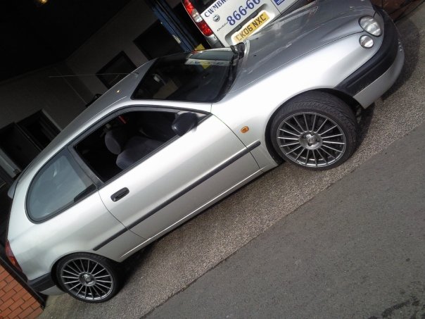

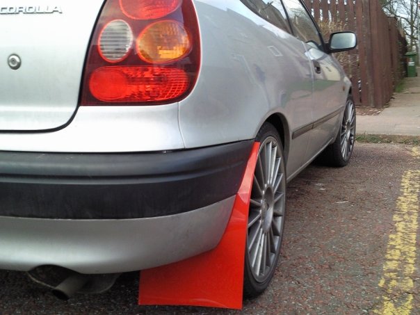

I already have tte suspension on it,
im looking for bigger discs if anyone knows of any convertions or straight swap parts of a different toyota that will fit.
Im also looking for and exhaust, better calipers maybe?,
And something to make it go faster :D

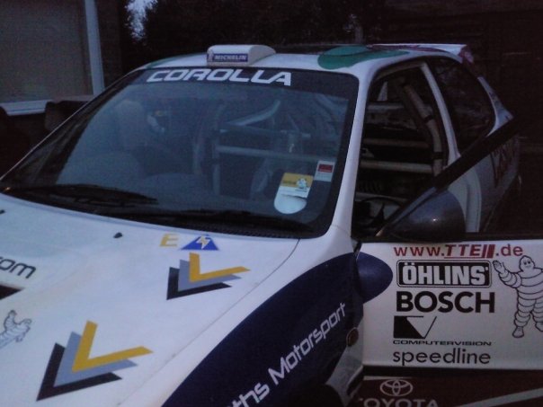

I know that the front brake system from the ST205 Celica GT4 can be made to fit though they will need some engineering to get them on - the guy who did my engine transplant has done this on several previous Corollas. I've been told that the front discs (275mmmm/ x25) and calipers from the Corolla Compressor / Tsport will also fit. The problem with fitting bigger discs on the front is that you upset the front / rear brake balance so that needs to be sorted too.
The guy who did my engine transplant had it in his workshop and fitted it at the same time as the engine :D
