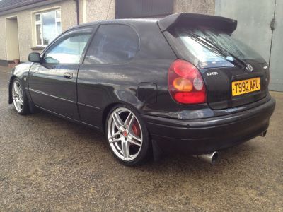

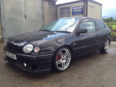

anyone have any photos of a nice tte kitted ae111 Corolla???
Will this do you?
Hi ive got a 1.3 e11 corolla,
does anyone know of any easy convertions to any of my car, which will upgrade it.
EG brakes or anything else. Thanls
go 3sgte for the crack,
Will this do you?
Very nice mate,
id love a white one with white wheels,
the lad that did work on yours kevin clarkson,
is he still working on toyotas?
and has he an email address?
thanks
