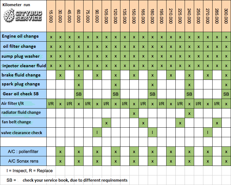

I found a nice little service chart that explains what you are supposed to do and when in our Aygo. It is from a Danish site called CityBug service (that I have translated to English). I hope it is okay to post it here. I have printed it out and have it hanging on our garage wall. The distance is in accumalated kilometers.
post-7935-0-97791600-1360520438_thumb.pn
