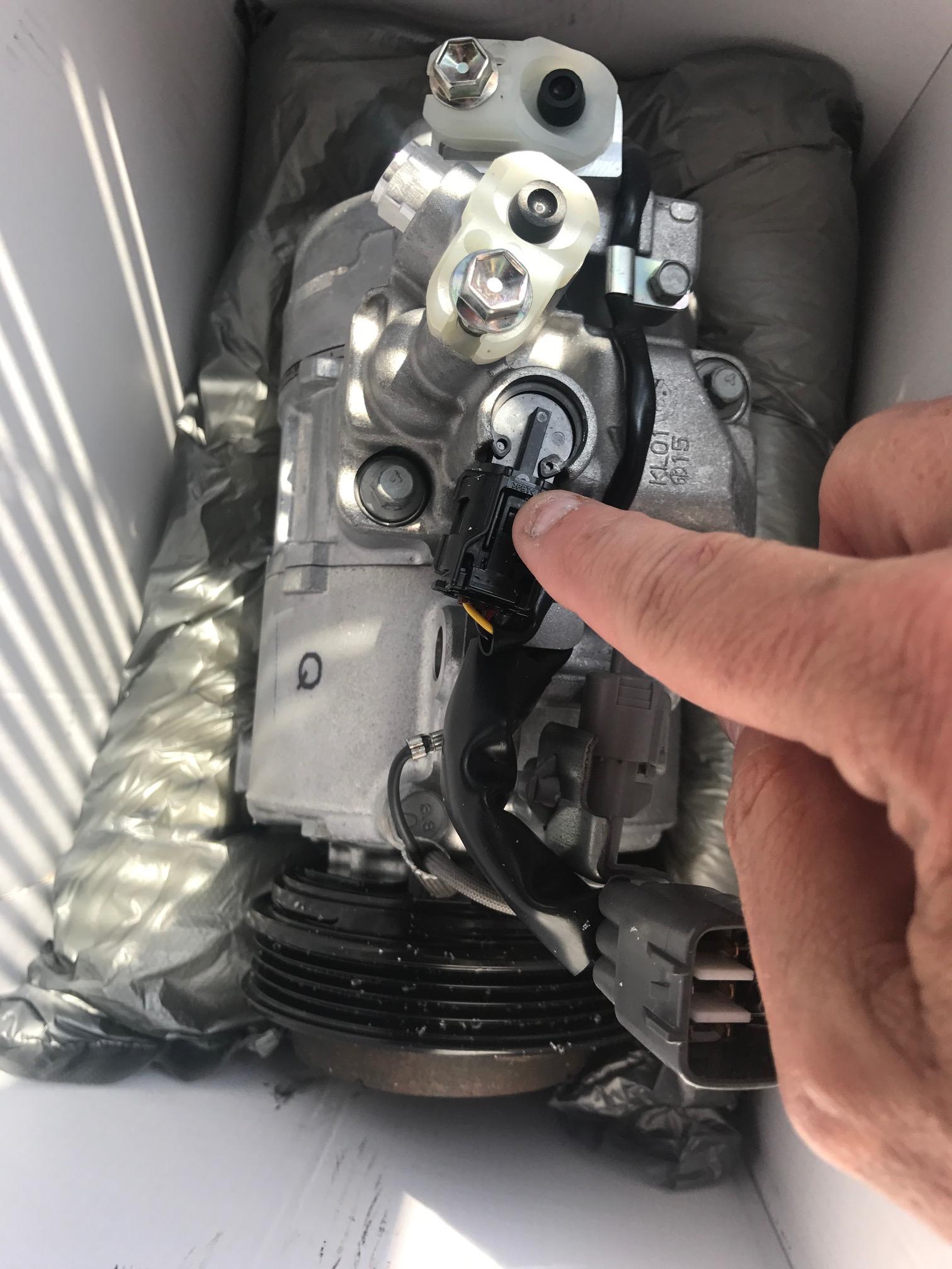

  19. hi sorry I took a while to send a photo of the Flow Sensor, I had problems uploading it. the photo is taken of my new Compressor which I didn't need to fit because my problem was a worn out Magnetic Clutch and it was easier to replace that being one bolt and a spacer washer than to replace the whole Compressor and Re-Gas it. Hope it helps
