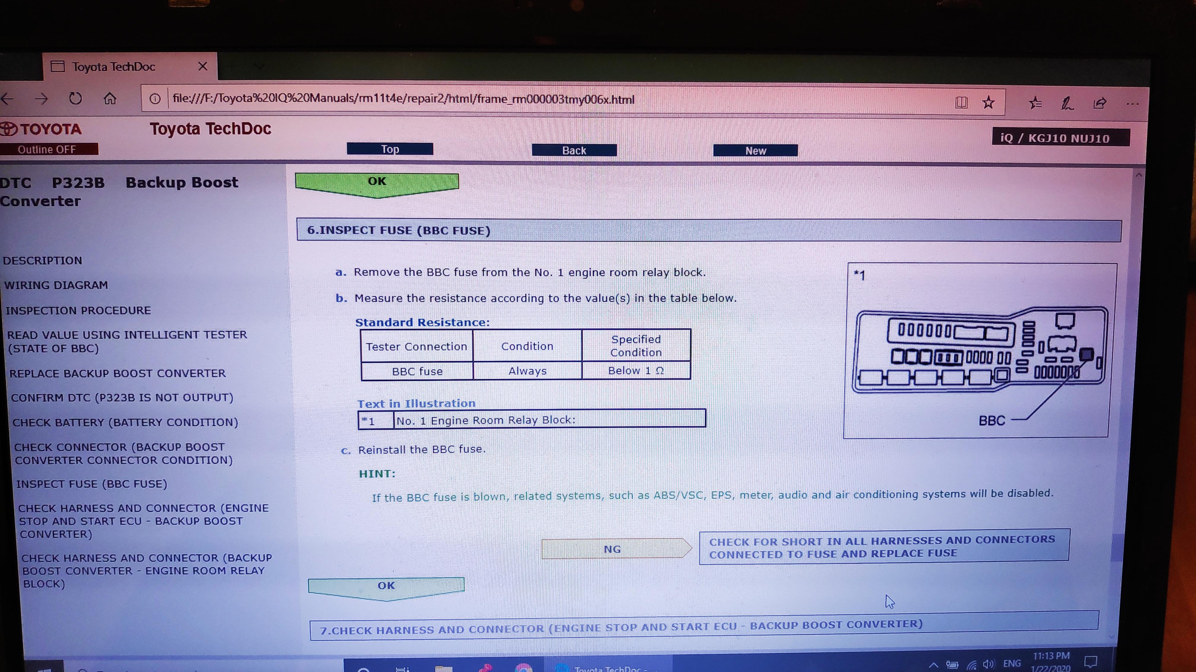

  4. Check your BBC fuse is not blown as below. Before replacing BBC

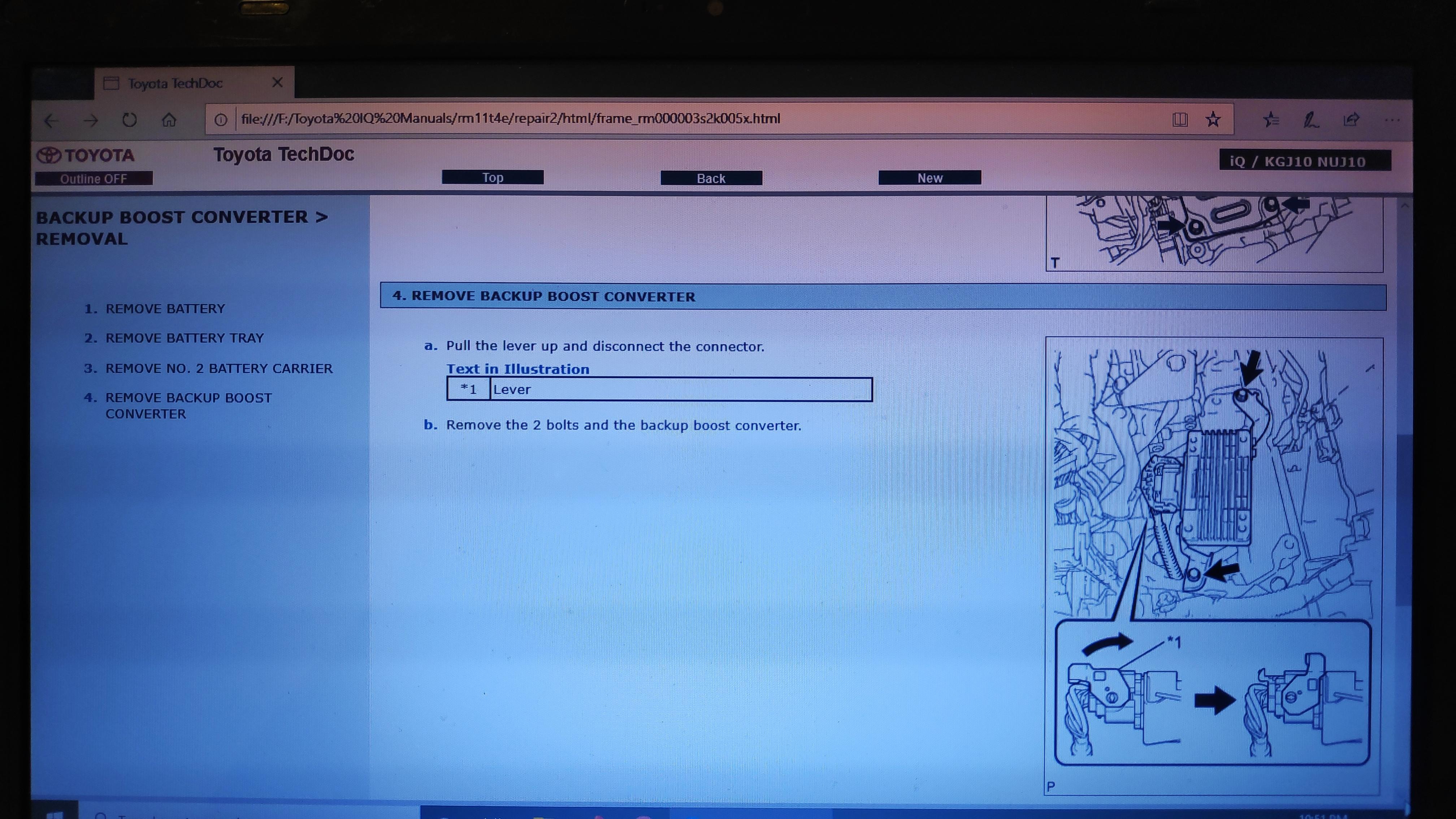

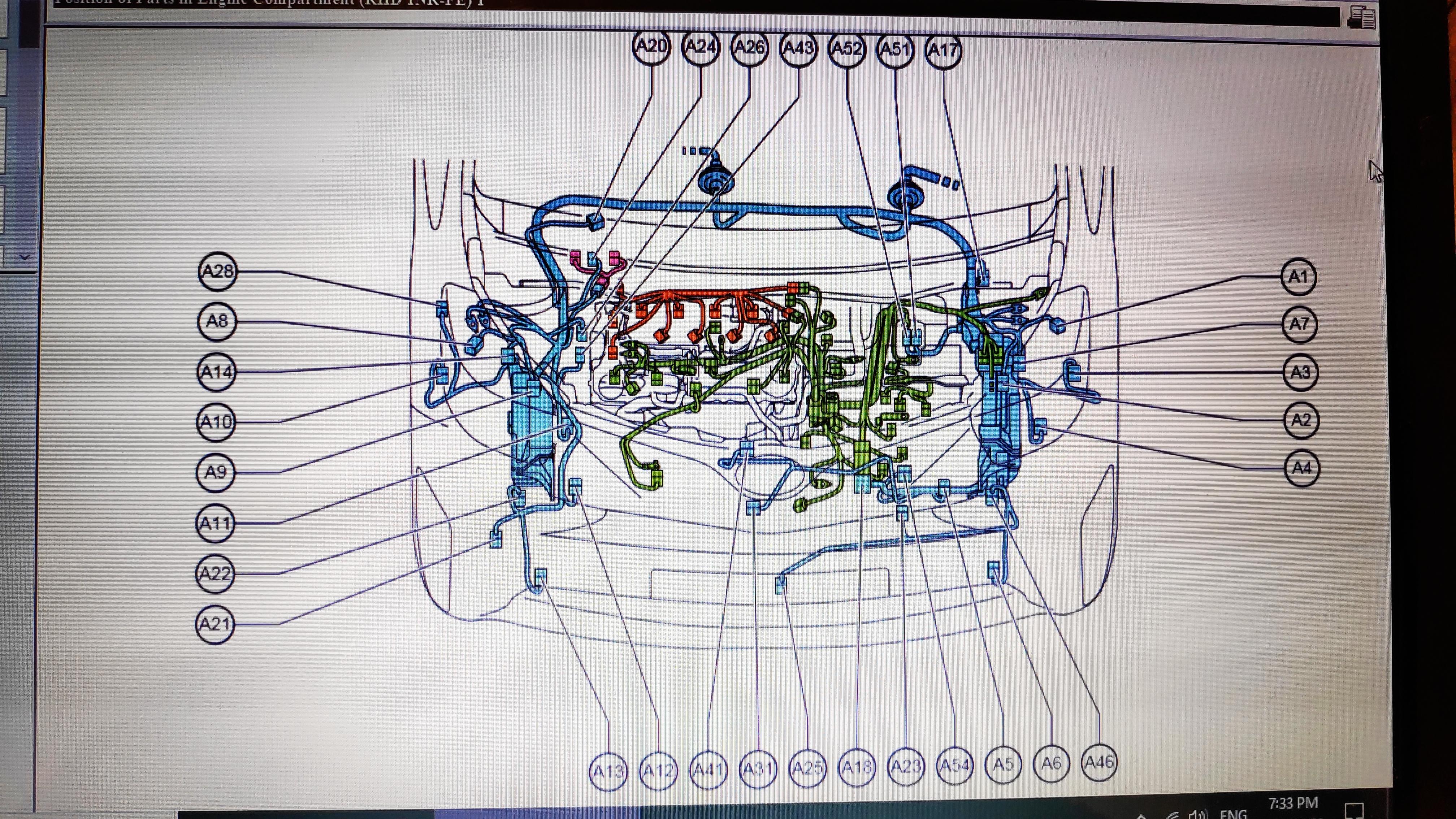

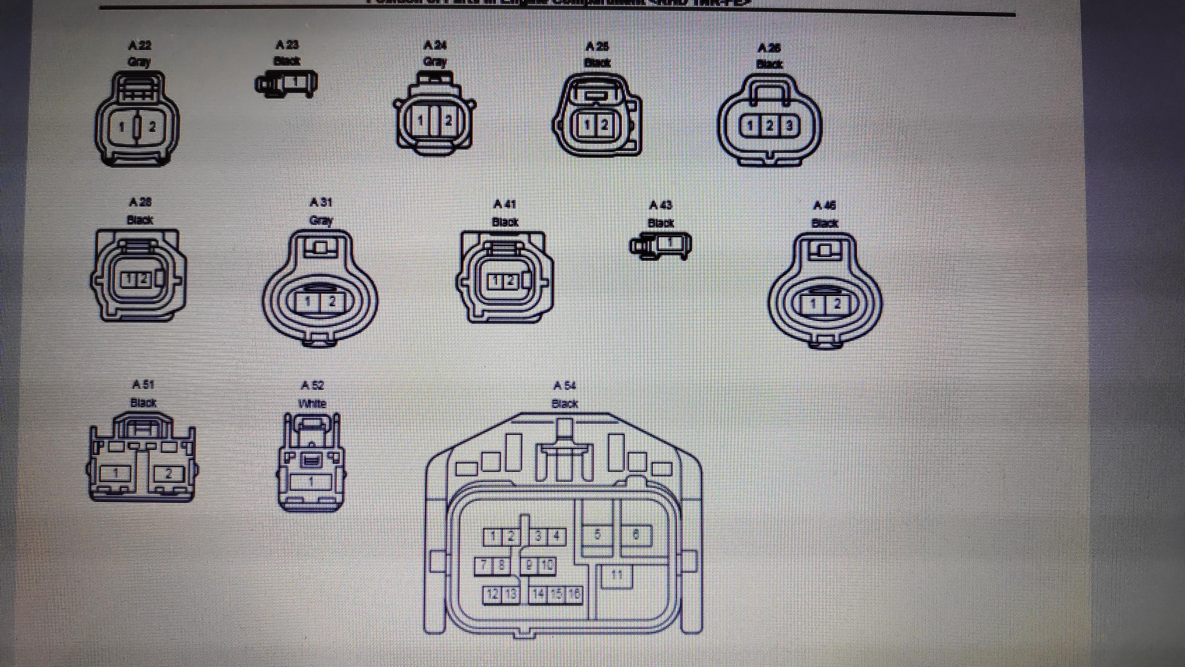

  7. Connector A54 is the Backup boost converter (Eco run converter). Diagram shows its position in RHD vehicle.
