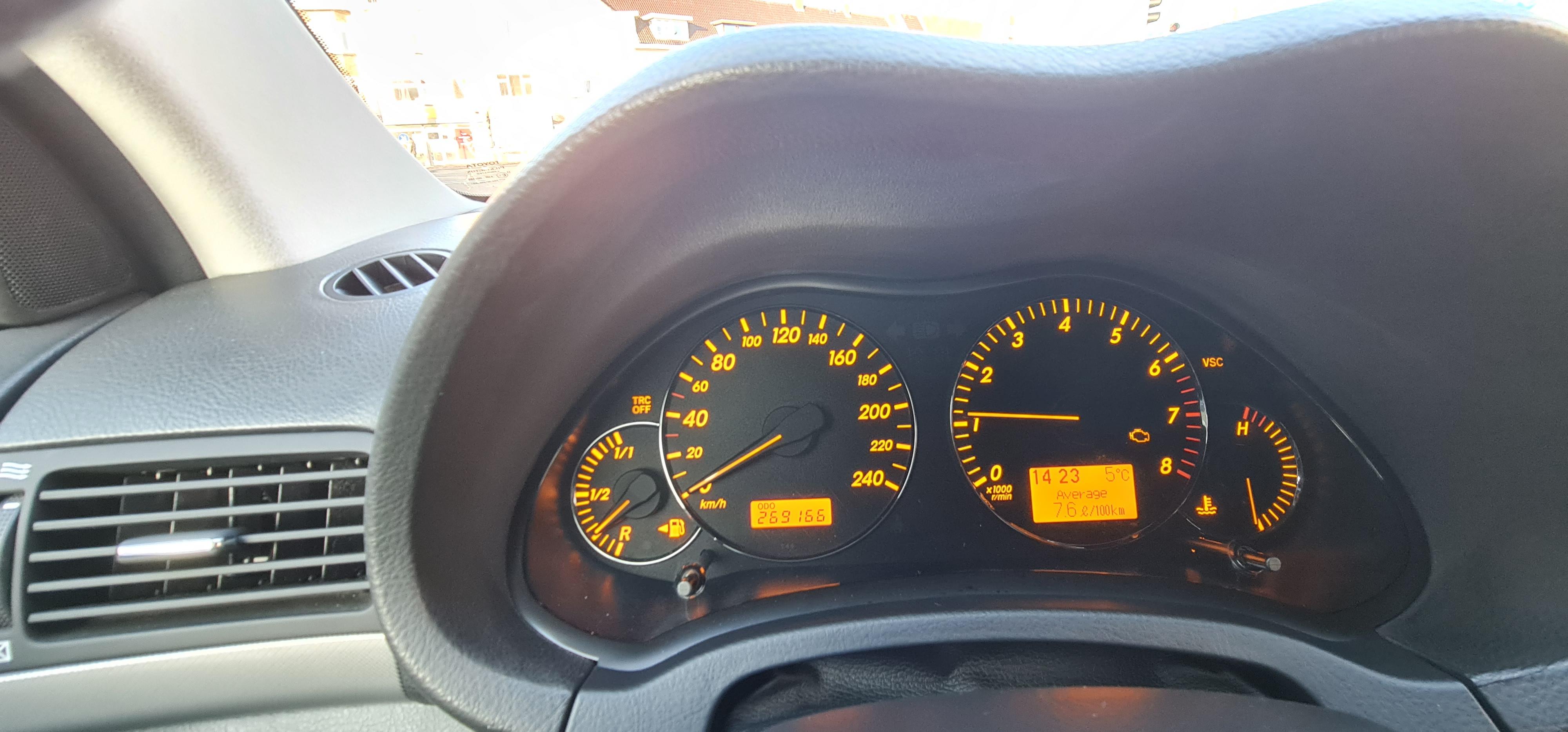

  11. Hi Guys, My Toyota saga continues: today, after I've started the car, I've got a lot of error codes: Check the attached picture 😄 Then, I've plugged my codes reader and what I got is this: P0016 Powertrain (Crank-Cam position correlation) P0156 Powertrain (O2 sensor circuit malfunction Bank 2 sensor 2) but nothing related to TRC OFF and VSC... just the lights in dash. Then, I have cleared the error codes and did not come back... however, the trip was short, 15mins city driving. And after i stopped the engine and started it again, the TRC OFF and VSC did not come back. What shall I do now? L.E. The engine is 1AZ-FSE (2.0)
