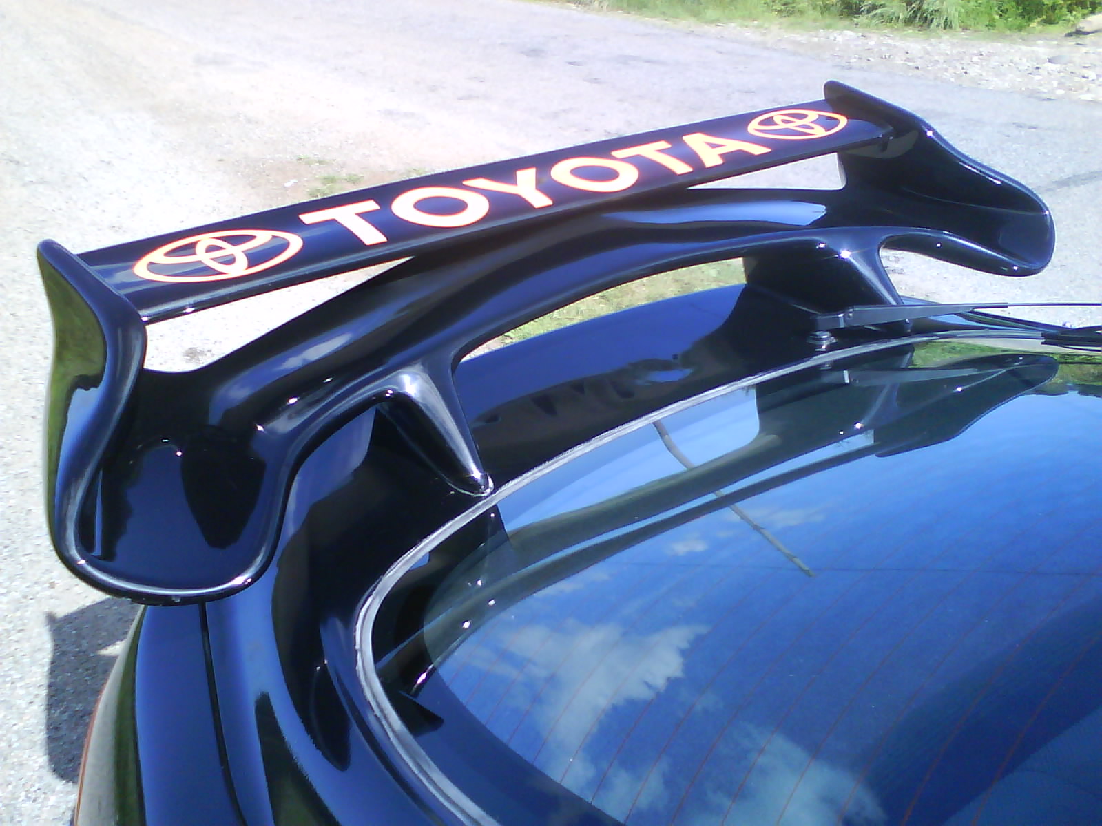

  14. Hi again, Thanks for the comment on the spoiler. Some of the shogun spoilers do not have led brake lights and some do. They do fit the back of the Gen 6 quite nicely. Fleebay will be your best bet. Watch out for stress fractures (which will need fixing) from the mounts. Oh I the chances are, that if your going for a second hand one the LED lights (if you choose this option) will need splicing into your existing rear lights. The lights will probably not be very good as they will be worn with time. Check the quality of the LEDs as replacement can cost more than the 2nd hand spoiler. You can always put the lens tint over them.... Hope this all helps a little bit. Cheers Big E

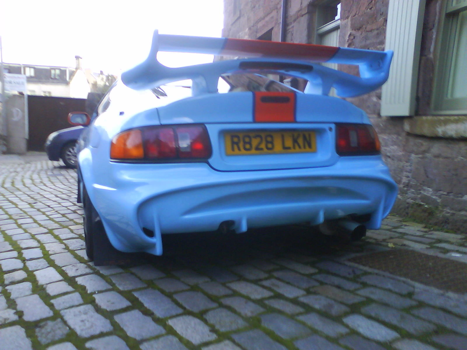

  15. I looked for ages for a GT4 spoiler (that was within budget). The best I could find where the extension posts on ebay via Japan. You mount your existing spoiler to it. I was not convinced so I opted for a 2nd hand Veilside and rubbed it down myself. Only cost £20 and 3 Saturday mornings rubbing it down.... I have attached a pic (if it works great.. If not sorry let me know and I will try again. Cheers, Big E
